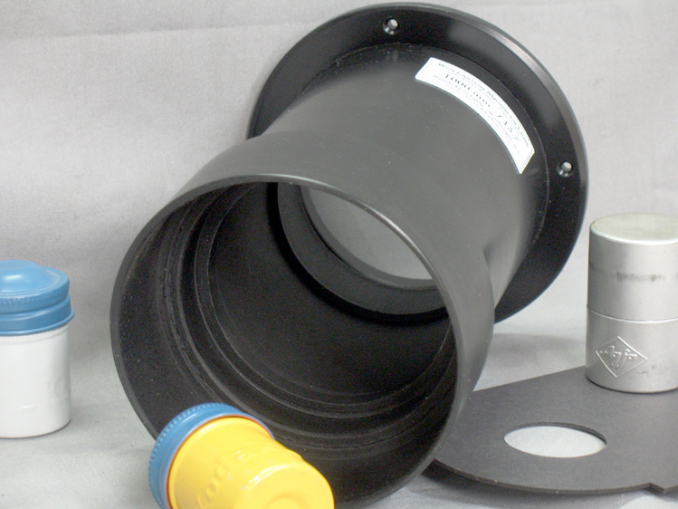

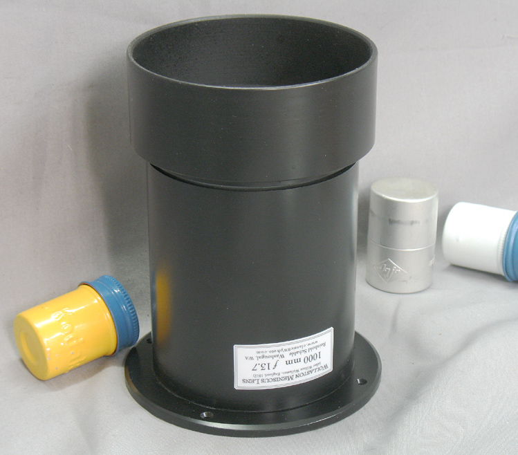

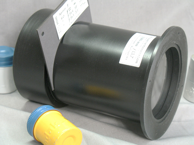

I've been getting requests for lenses for monstrously large cameras and even for a portable Camera Obscura.
This 1000mm f:13.7 nugget is a step in that direction.
I can confirm that it will easily cover a 24x32" negative or wet plate.
To verify coverage, I made a 24x32x42" dark box with a way to mount a lens in the end wall.
I climbed under a black-out cloth to see what was happening under there...
The white wall on the end of the box displayed the glorious scene of a summer day in my back yard.
Too bad my dark box wasn't larger, I have no doubt the lens would illuminate a much larger image circle.
I'm even thinking of making a knock-down tent-like Camera Obscura just so I can evaluate whopper lenses...
Will this madness ever stop?
If you've been stricken with this madness, this lens is yours for $125 + shipping.
As usual, you get five aperture cards, mounting screws, a cleaning cloth, and documentation.
Oh, and you'll need more than 1000mm (40") of bellows draw...

I jury rigged an extended lensboard to my 8x20 Canham so I could verify focus and bellows draw...
At infinity, bellows draw is 39.4" (1000mm), the same as the focal length.
Cranking the lens out to about 43" (1090mm) brings focus to 200' (60 meters).
To focus at 100' (30 meters), bellows draw would have to be about 46" (1170mm).
An extended lensboard could be quite handy...
All tests were wide open, I didn't attempt to evaluate depth of field.

I'm in the process of designing an extended lensboard for those who would like a bit longer bellows draw.
To be continued...
