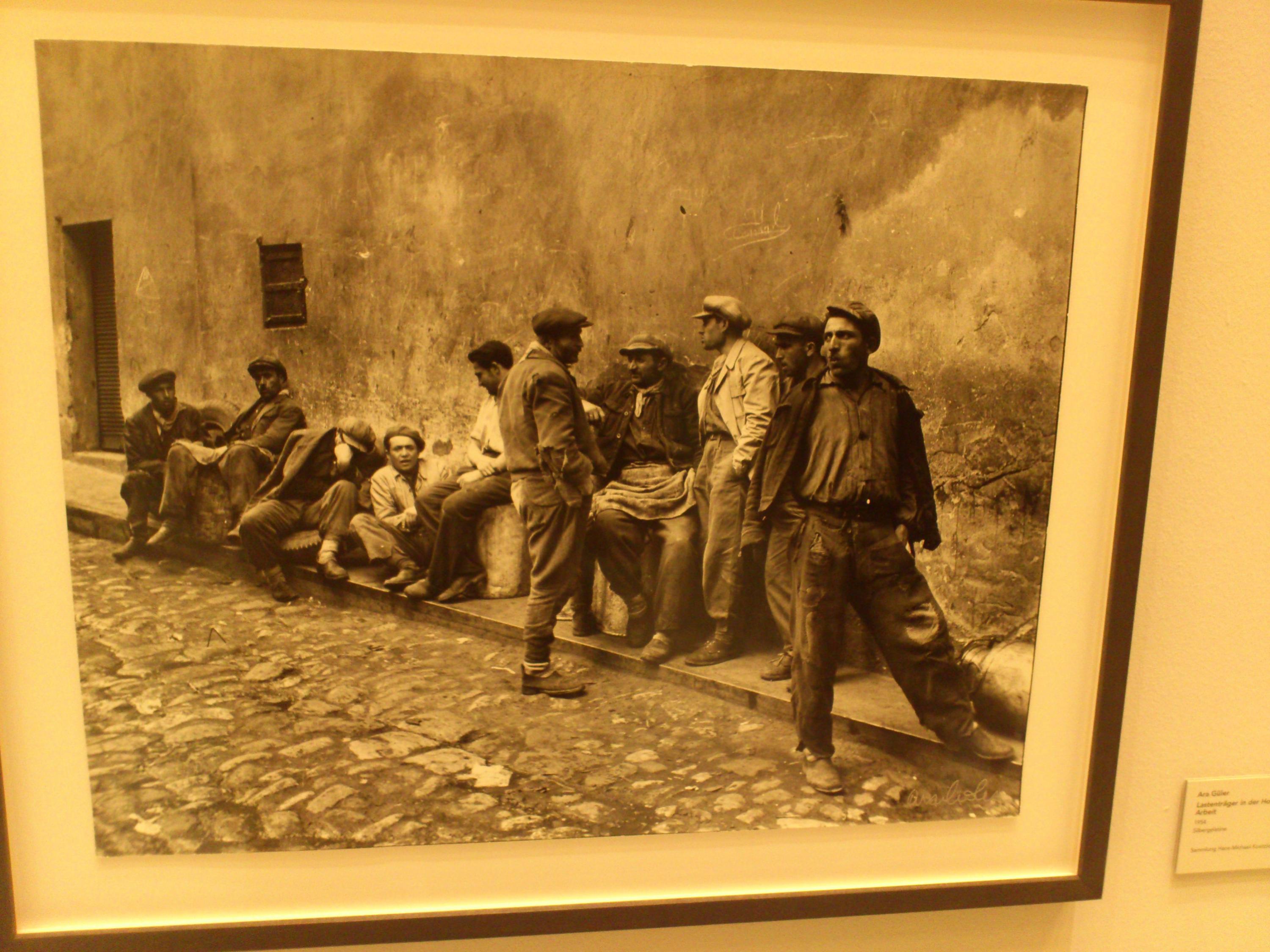

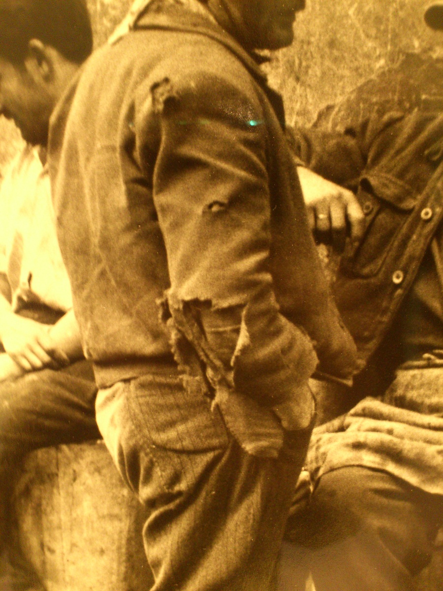

So when already going very technical - one print was very strange to me - it is huge print from Ara Guler from 1954. For a print that was about 50x60 cm or even bigger - it was unusually grainless, hard to believe that was made from 35mm format at that time. My question is: what was the best film concerning grain at that time? Even at close inspection - looking from 15cm distance there was no grain at all. I took some photos with mobile phone:

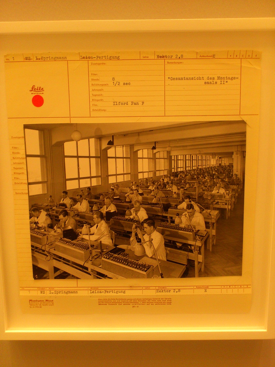

And on the end one praise to Ilford Pan F :smile:

In the olde days you could get images with very little grain with 35mm film if you used slow film. In the late 1950s I used Panatomic-X with my IIIf and got negs that would knock your socks off. The trade-off, of course, is it was harder to get fast action shots.

Thanks snapguy. I know that it is possible to get grainless results in 35mm with Kodak TP and with today's CMS 20, but I was not sure what was "35mm grainless" in 1950's :smile:.
Hi,
there was Perutz Silbereosin, orthochromatic at 12 ISO.
I used some glass plates of it this summer, fine grain like PanF, but not like TP or CMS20.
