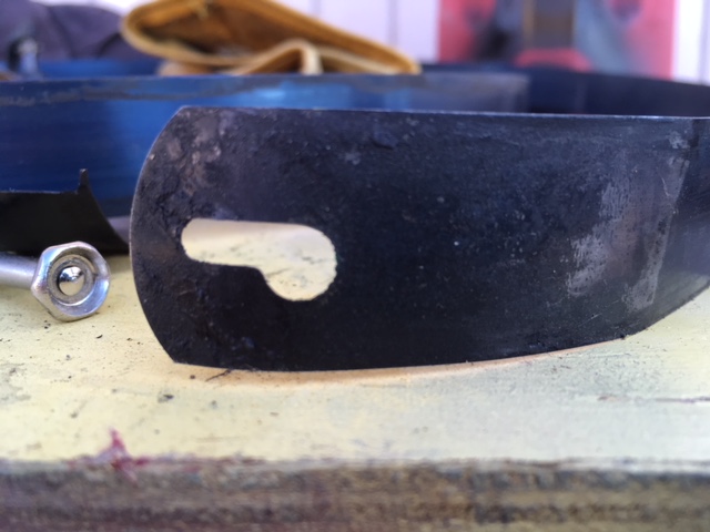

If both ends are like that, it might be worth contacting a couple of clock part suppliers. That looks a lot like a clock spring. I’d suggest a couple but I’ve been away from that hobby for more than a decade.

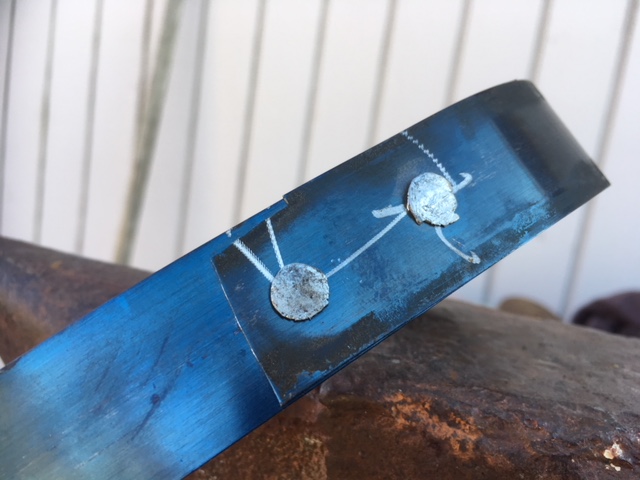

Did a repair. Nothing to lose, right. Drilled holes with a dremel grinder so the temper isn't disturbed. 3/16ths shorty screws pounded on an anvil to make a rivet. Ground the other side pretty flat. Put it all back together and ran it successfully about a dozen times and then she went ka-boinga. I did that years ago with a phonograph and as far as I know, it's still running. I might try again tomorrow. Like I say, nothing to lose. It broke about 6 inches in front of my repair.
Excellent attempt! There appears to be a reason why the spring lost its constitution.

The McMaster Carr spring is probably your best bet long term. the repaired spots are going to cause banding- I'd be shocked if it didn't. The key to prepping is to soften the temper a bit right at the spot at the end that forms the keyhole, without messing with the temper in the rest of the spring. I'm pretty sure the ten spring is a little bigger than the 8, but an 8 spring may work
