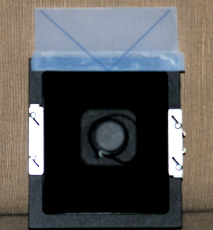

Mine came the other day but I haven't had a chance to use it or the exposure calculator that was included. I'm in the process of assembling the calculator backed by plastic. The angle of view is 97 degrees. I printed a 97 degree template on clear (Pictorico) film and mounted it on plastic that can slide on to the camera. It's probably not comparable to a viewfinder but may be helpful. If anyone has other suggestions I'd like to hear them.
I'd be interested in seeing this if you are inclined to post a photo here, Some of the RF style external VF's can be as much or more than the camera, so I would rather devise a similar plan...
97 degrees is about a 18.8MM lens in 35mm, so for now, I can use my Nikon 14-24 at that setting and figure a good chunk more image area on the short dimension of a 4x5 neg. It's possible the external VF for my XPan 30mm could help a bit, it seems to equal about a 17.8mm when mounted on a Nikon SLR with a 14-24. The other option is a Voightlander 15mm...?...who knows....

Here is the 97 degree template (a quick construction). If it turns out to be helpful I will make one with better materials. I apologize for the photo it was with my wife's phone for expediency.
