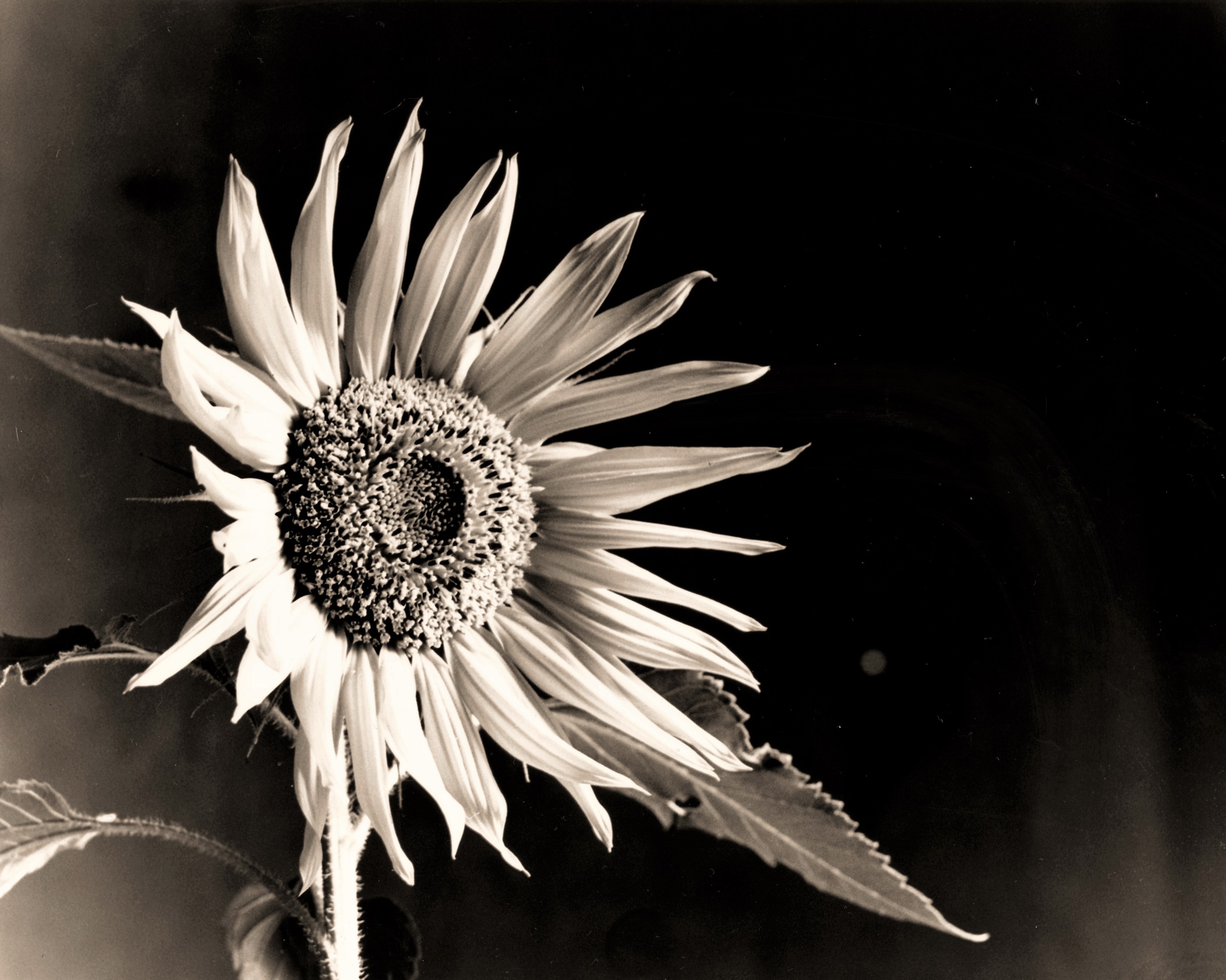

Darkroom print, ilford rc iv gloss, bleach and sepia.
Mamiya rz67, 180mm lens.
HP5 120 in pyro hd.
Home grown sun flower.
Nice. Crisp. Definitely not a toy camera.
This is lovely. I struggle with sepia. It works well here.
Thanks, I can do better on the print its hard to get a good representation when scanning.
What I try to do is get a slight browning of the highlights and deep blacky brown in the shadows.
Depending on the paper I have a few methods, Ilford rc iv doesnt take toning too well, so I over expose the print 1/4 stop then bleach then sepia. The newer Ilford RC tones much better, so it Selenium first to keep the deep blacks.
I invariably use FB for toning. That's interesting you say the new Ilford RC tones better. As you say it all depends on paper used, and of course the negative. Thanks.
