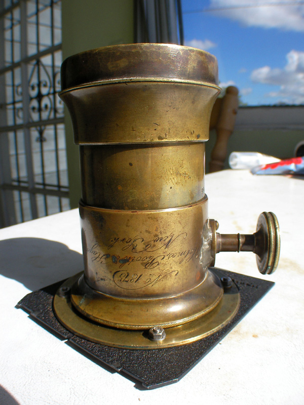

After seeing a similar petzval dedicated site on Flickr, and as I am a convert to all things Petzval, I thought APUG needed a place as well. I added a bunch of photos. (Order of photos is now fixed) At any rate, the photos document how I fitted two very different Petzval lenses to Linhof boards and adapted them for use with a Packard shutter onto the front of them. There is text added to each photo outlining the steps. YMMV, enjoy.

D, the portrait I made of Brian, Evie, and Daisy did exploit the natural characteristics of this lens. That said, the effect is really exaggerated by including foliage in images. All of the other portraits were taken with the same lens and set up, I was just closer to the subjects and the backrounds were dark and the effect is not nearly as noticable. It's there, but you have to look at the lower portion near subjects chests/shoulders.
The 5" Cinephor lens is not quite a dramatic as the infamous 'Eddie' lens, but not far off. Coverage is extremely limited on 4x5, so cropping square gives it a Holga feel with the petzval swirlies. Thanks for looking.

Great images Barry, and very clean install for the Alphax. I see coverage for that lens is minimal for 4x5, does the Alpax add to the vignetting at all?
#12
Thanks Andrew. Did I mention I *love* having the petzval in a real shutter. The install isn't as solid as a metal flange or ring, but it does the job and I can easily cut a new ring in 15 minutes if things start to get loose. The Alphax doesn't cause any vignetting unless I try to stop the aperture down. The coverage is a bit less than I'd like which is why I bought bought the 8", but the 8" is going to take some work. I also found that the 8" has a 7" image circle, so maybe I'll lose the swirl on 4x5.

Bill, for 4x5 you are likely to need something in the 4 1/2" to 8" range. Typically something that has limited coverage for your format to get the most pronounced swirly effect. There could be exceptions based upon how large/wide the lens diameter is. Typically wider opening petzvals have more coverage and less pronounced swirly effect on smaller formats. Case in point, my newly acquired Darlot has an alleged focal length of 6". It is very wide and can cover 5x7 easily so on 4x5 the swirly effect is minimal. Then if I use my 5" B&L lens, it has CRAZY fall off on 4x5 and is more suited to a square image, but the swirly effect is greatly exaggerated. The lenses that often come up via Jim Galli on this site and on large format forum are usually what you need. Also look under brass lenses on E'Bay, but they can require lot's of money!

Barry, I think my Packard is a 5 3/4". Again sourced via Jim. IT has the instantaneous option as well, but with the cokin filter adaptor added in I can get speeds low enough to where I do not need it by stacking ND filters.
