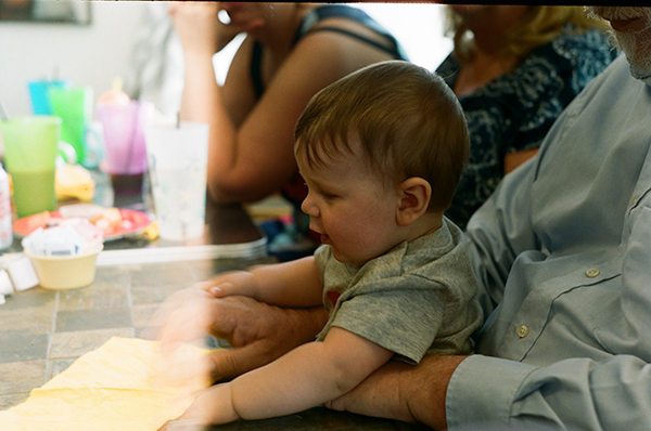

I shouldn't complain. I got a Zorki 4 for what it would have cost me to buy the Jupiter 8 lens it came with by itself. The lens is in good condition. (I also did the same with a Fed 3 and Industar 61 and found the shutter to have light leaks. At least with that one, I can easily diagnose the problem.)
I put a roll of Kodak Portra 400 through the Zorki. Best I can do to explain is show you the results. Shutter speeds ranged from 1/60 to 1/225. I already knew about not changing shutter speeds until the shutter is cocked, but perhaps a previous owner did not? Is this the effect of doing that wrong? What's weird is that it's not consistent. On some, half the frame came out. On others, the photo came out completely! If only I had exif data haha.

Could be that you have a lazy shutter where the second curtain does not completely shut, common I believe on Zorkies. I have had a couple with that problem, does not effect all shutter speeds, and sometimes firing the shutter repeatlly fixes it, fire it with the back off on all speeds and see what the shutter does,

First and third look like a lazy curtain, the second one a light leak.

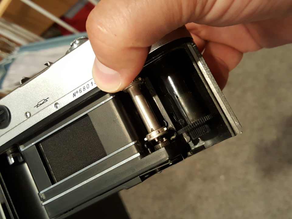

Thank you. That light leak only showed up in a couple of shots. Now, I have a completely NEW problem!
I tried opening the back to watch the shutter curtain at different speeds to see where I can spot the lazy curtain. I could not advance/cock the shutter. See in the photo, those two small metal pins, bottom of the metal sprocket. Those are longer on my FED 3, but just barely scrape each other on the Zorki 4. That's weird because it was not a problem before. I tried setting it to rewind and then photo-taking mode again. I can't get those two pins to contact each other. Seems the more I use it, the worse it gets.

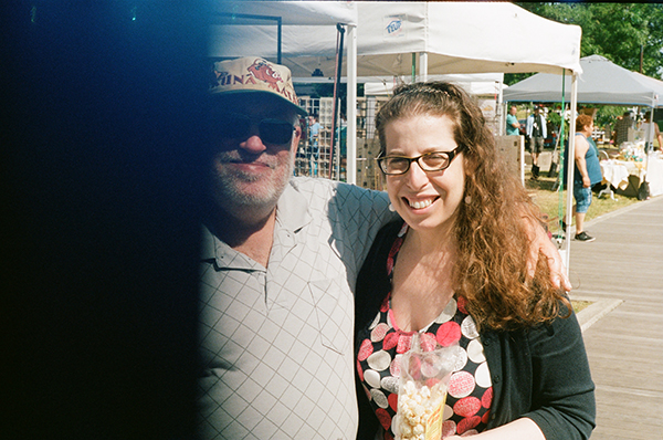

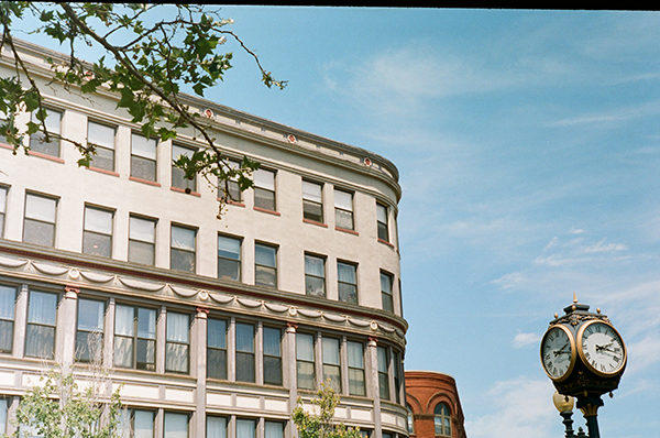

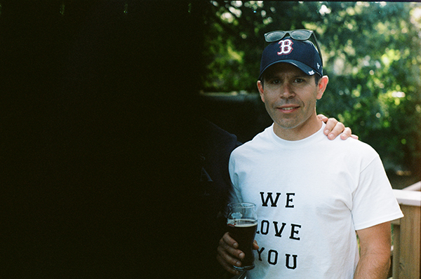

Picture 1- second curtain caught up to the first curtain at 2/3 point of the frame and they stayed together the rest of the frame.
Picture 2- the second curtain hung at the 2/3 frame point causing over exposure.
Picture 3- same as picture 1 except that the second curtain caught up at mid frame.
Picture 4- shutter worked correctly.
Now back to the camera bashers.

Ah okay, but even if I fix the shutter, there's the pin on the bottom not working anymore to advance the film and cock the shutter. (See post with photo above)
Have you checked out the instructions to disassemble the pin? It appears it remained in the "up" position used for rewinding.

My description in post #10 is based on the shutter traveling Left to Right.
Description based on Right to Left travel of the curtains:
Picture 1- curtain 2 sticks to curtain 1 or both are released at the same moment and about 1/3 of the frame they separate and produce a correct exposure.
Picture 2- curtain 2 fails to release on time and causes over exposure for the first 1/3 of the frame then snaps into position and produces a correct exposure.
Picture 3- second curtain sticks to curtain 1 or is released at the same moment as curtain 1 and half way across the frame it separates and produces a correct exposure.
The Horizontal travel focal plane shutter consists of two curtains spring tensioned to travel at the same rate. Curtain 1 has a solid section that covers the image gate and an open section that is larger than the image gate. Curtain 2 is a solid section that covers the image gate. In the released state curtain 2 blocks light at the image gate. In a cocked state curtain 1 solid section blocks light at the image gate. Upon releasing the shutter curtain 1 moves and its open area starts allowing light to pass through the image gate to the film. The second curtain is released and starts blocking light at the film gate. This forms a slit that is swept across the width of the film gate. The width of the slit is determined by the shutter speed selected, narrow slit for fast speeds, wider slits for slower speeds.
The shutter in this camera needs servicing.

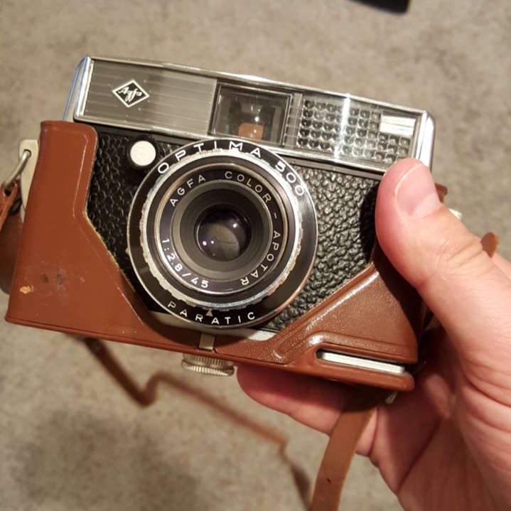

I also have a primitive Agfa Optima 500 from the 1960's with a still working light meter that's maybe 95% reliablel.
I would not call it a primitive camera.
Agfa with their Optima were the first to introduce a 35mm camera with program autoexposure! In 1959.
Your Optima 500 is the 4th model of that series from about 10 years later.

That's interesting. I did not know that! I have gotten some good shots from it, but as it is a viewfinder and not a rangefinder I'm not used to the fact that I have to guestimate/trust the focus.

Here's a flickr gallery of some of my Agfa Optima shots (the light leak one was my own fault). https://www.flickr.com/gp/134931907@N04/G5pcnS
Here's the camera, itself -
