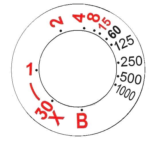

Second, about half of the shutter speed numbers are worn off of the ring surrounding the knob. I printed a label and placed it over the ring as a temporary fix; I'd like something more permanent. Any suggestions or recommendations?

Would this be of any help?
See also here

Yes, that is considerably better than what I have. Short term I'll print and attach to the dial. Long term I may see about getting it laser etched into the dial.
