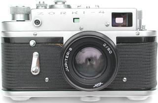

Extremelly beatiful camera , congrulations , jupiters are great lenses and you can find thousands of japanese cameras for 3 dollars but thisis a piece of history.
Dont forget to check shutter curtain , there can be holes or light leak cos of wear.
But you can order a replacement for each part. If I were you , I buy from APUG Classifieds from trusted member , it will be cheaper and in one piece. Dont forget my word , be a subscriber with 10 or so dollars and put your request. If you have no money , someone would help you again , lots of people touched the heated pan from online dealers.
