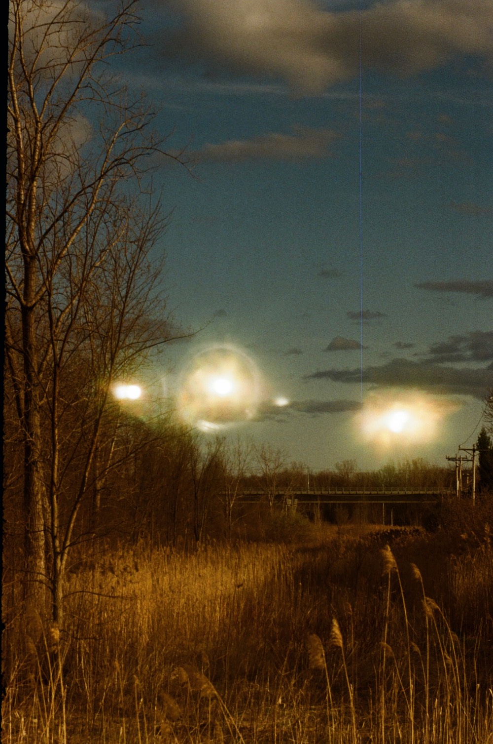

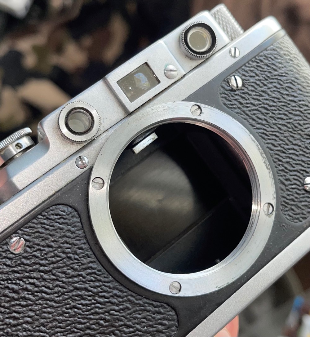

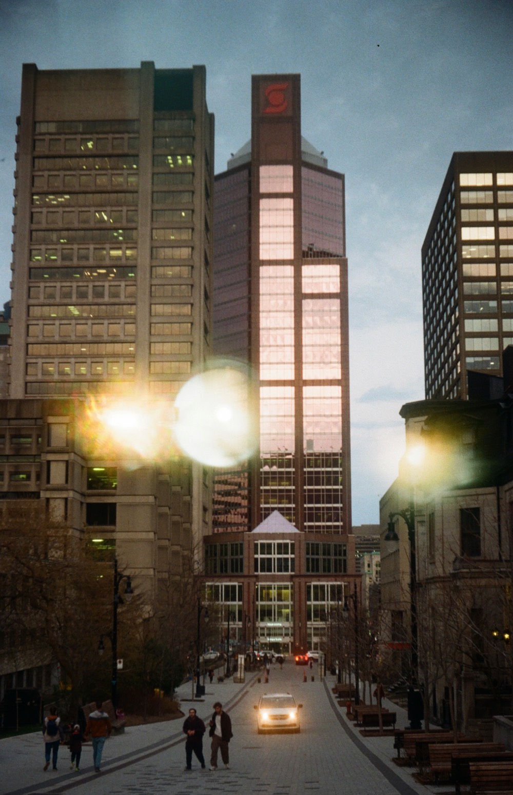

I recently picked up a Zorki 1, shutter and winding work super smooth but all photos came back with some flares in the middle of the frame. It is definitely not a lens problem as I used 2 different lenses throughout the roll. Anyone know what could be causing this?
Im thinking maybe internal reflections? Curtains seem hole free but maybe it could also be pinholes. Only thing odd I notice is the metal behind the curtain is pretty polished/reflective looking and seems to have a small dent.
Please let me know if you know a possible fix as I really like this camera!

I assume the shutter is cloth.
I had a ZARYA that worked great but had lots of tiny pinholes. That's easy to check. Remove the lens and open the back. Point a light through the shutter while closed. Make sure to look at BOTH curtains by cocking the shutter, and then again after firing the shutter but before the shutter is cocked again. I was able to fill in the holes with some black fabric paint and a small paint brush. Just give it time to dry before changing the shutter.

Yes exactly a cloth shutter. I guess I’ll have to take the camera apart to check though as the back doesn’t open up. Or maybe I’ll just brush a layer of fabric paint on each shutter and hope for the best.
OAPOli
Sep 26, 2022
644
Toronto
Pretty sure these are caused by pinholes. The curtains should ideally be replaced.
Fabric paint works but adds a bit of stiffness to the cloth so it should be applied to the pinholes only. I would suggest removing the shell to locate the pinholes.
I'm not familiar with that camera, but since it's like a Leica, you can't look through the back. The problem with going through the front is that you can't see where the holes are -- because you can't shine a light through it.

This Zorki is like the old LTM cameras that load from the bottom and there is no back to open and look through. Yes, it's pinholes for sure.
