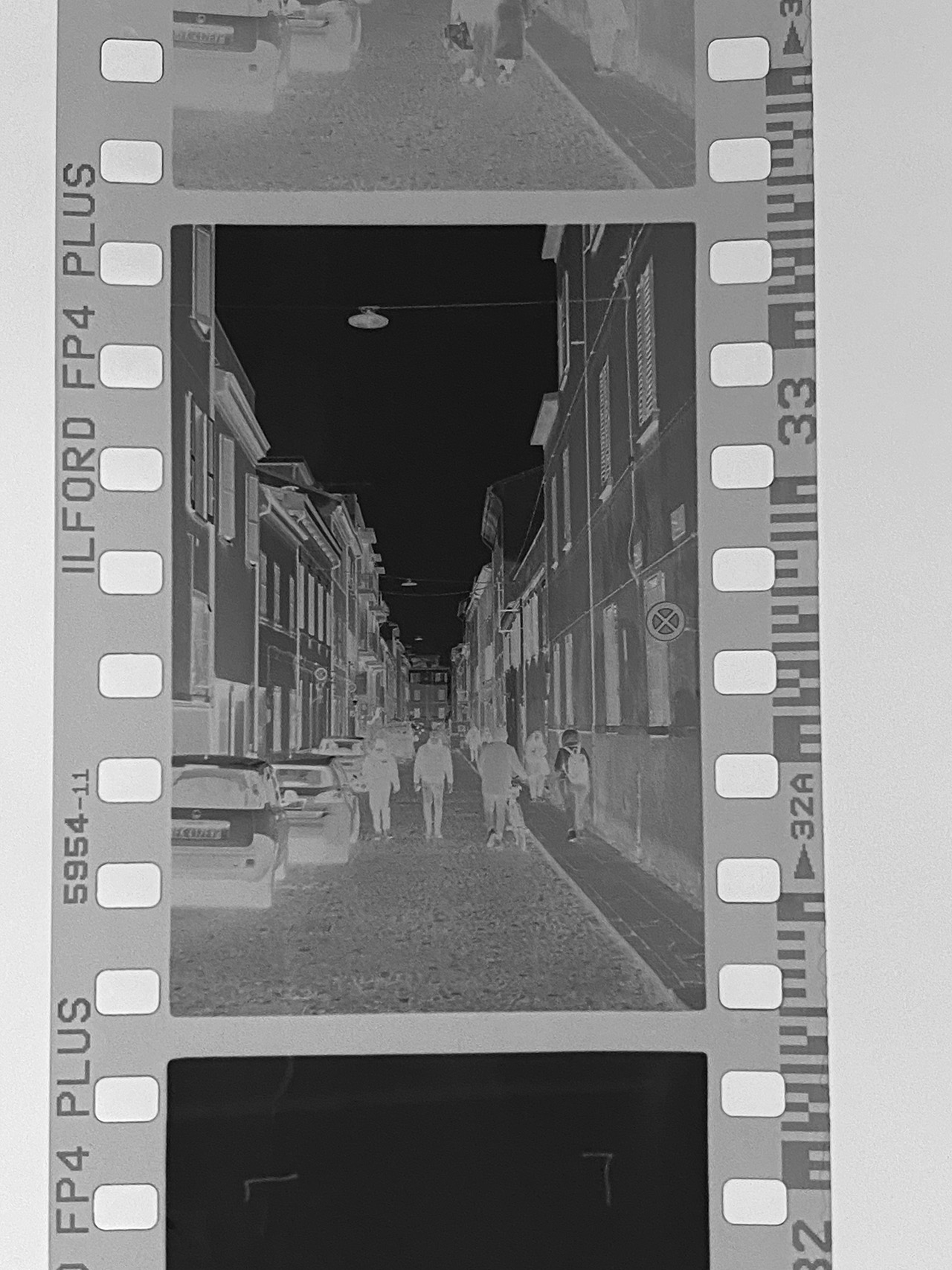

Good evening, everyone, and thank you for all the advice—it's all very much appreciated.
In particular, I want to thank @Doremus Scudder because I think he has touched on a couple of interesting points, and I’d like to respond to them one by one.
First of all, my ideal zone scale should be structured as follows:
  • 0 – Maximum black of the paper
  • I – A "buffer" zone where everything that is not quite a "very dark gray" can be placed and may blend into black
  • II – Very dark gray (distinguishable from black as a separate tone but without texture, only tonal value)
  • III – Very dark gray with texture
  • VII – Light, but with texture and detail
  • VIII – Light, tonal value only, no texture
  • IX – A "buffer" zone for tones too bright to be distinguishable from white
  • X – Paper white
I like the idea of trying to print a Zone VIII and defining the standard exposure time from there. In fact, I was very surprised to realize that determining the maximum black is not as simple as it seems—it always feels like a deeper black can be achieved, although many of these differences disappear once the paper dries. I will give this method a try. Maybe Zone XIII is not far. By the way, while comparing the data, I also noticed some oddities, such as densities that tend to increase more in the highlights with a shorter development time compared to a longer one. Perhaps, at these dilutions, developing film strips of different lengths becomes an issue for the repeatability of the results.
Fomabrom Variant 111 should have a rather steep shoulder, allowing for good separation in the blacks. Highlights are a different story (and perhaps this explains the difficulty in bringing out Zone VIII). By the way, the ISO-R for filter 2 is 90, not 95 as with the Ilford paper, so the negative density range must be very compressed... and this looks reasonable to me.
I don’t want to become obsessed—I simply want to apply a logical approach to prove to myself that I understand and control the process. Sure, I could try printing at half a grade lower, but that would feel like giving up.
I develop the paper using the factorial method, applying a 10x multiplier to the emergence time. Since my darkroom is at 19°C, my development time ends up being around 200 seconds (10x factor).
I also considered the difference between LED panel lighting and sunlight, which is why I decided to take a "real" photo as well (without any artistic ambition!). This shot was exposed with the sole purpose of placing the sky in Zone VIII, and indeed, its density appears visually comparable to the Zone VIII test frame.
EDIT: Forgot to attach the file... that's it:
The issue with lowering the EI too much is that I’ve noticed it tends to increase highlight density even further, whereas with a higher EI, I seem to control it better (or at least that’s my impression). This might also relate to another issue I’m facing: my developments seem too energetic. I really have no idea why. Maybe I should try a different developer... perhaps I could test with D76-H.

Get a copy of Richard Henry's "Controls in Black & White Photography". He explains how to make your own tests to meet your own needs with your own equipment. If you ask a dozen photographers the "best" way to do it, you'll end up with 20 approaches -- at least.
axettone
axettone
Dec 7, 2022
6
Italy
I think I spotted the cause of one of the two problems: my negative readings are affected by Callier effect. This has an increasing impact on negatives more dense than 0.6 - 0.7 and almost no effects on the thinner ones. By diffusing the light, it looks like the highest densities decrease by a little. So there's no overdevelopment. The other issue, the zone-VIII missing tone on the print is probably due to the hard problem of spotting the maximum-black priting time as many people suggested. I'll try again.
axettone
axettone
Dec 7, 2022
6
Italy
Congratulations ! You found all by yourself the solution of your problem.
Yeah, film photography is both a source of big frustrations and satisfactions. I still have to do my tests, but I also found the solution for Zone VIII. I carefully read the Fomabrom Variant 111 datasheet and it states that grade 2 filtration has an ISO-R of 90, which is slightly lower than Ilford's; without filtration (the "special" grade) ISO-R is 100, which should be better-suited for my type of enlarger. I look forward to write here my results.
