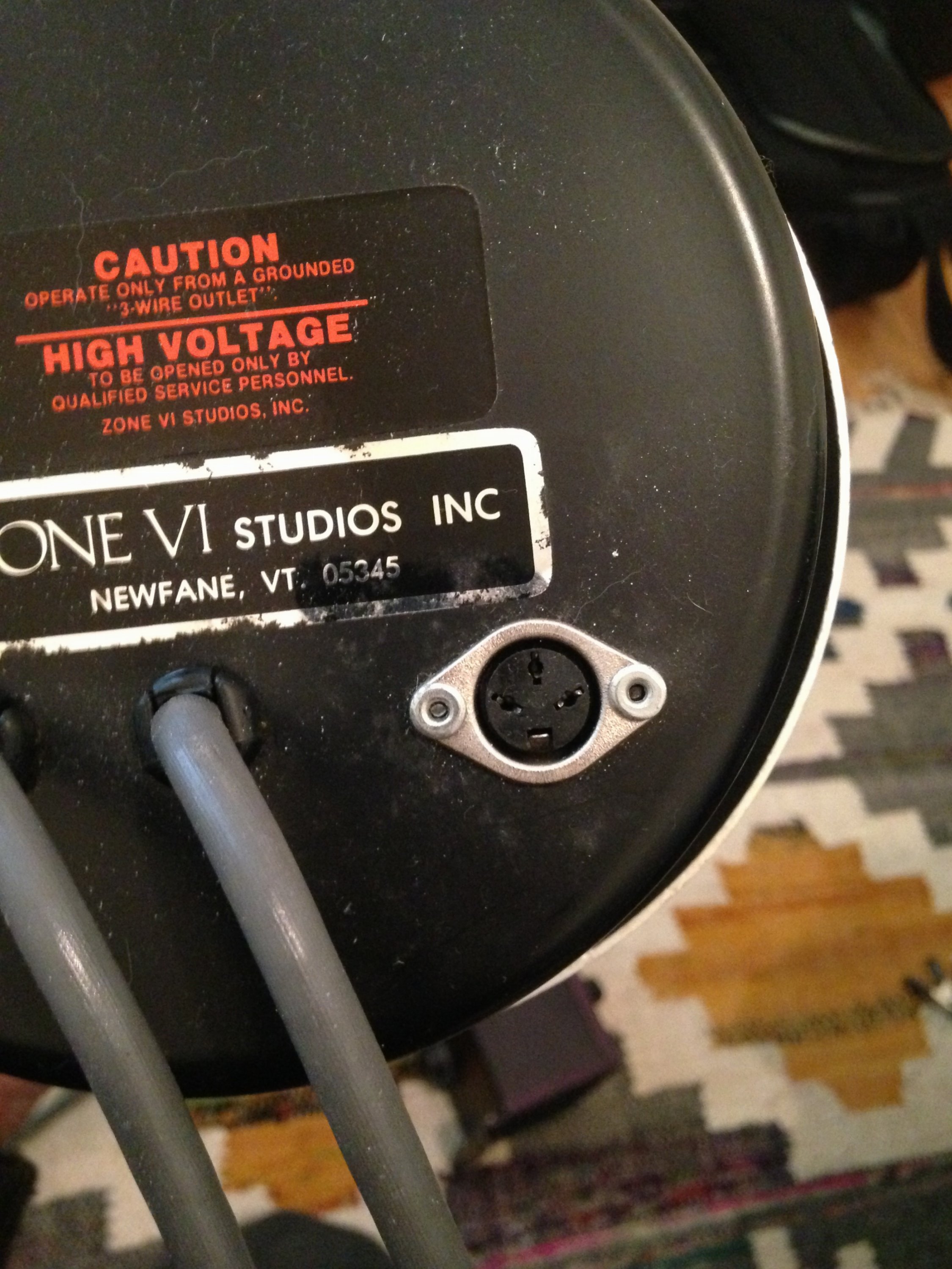

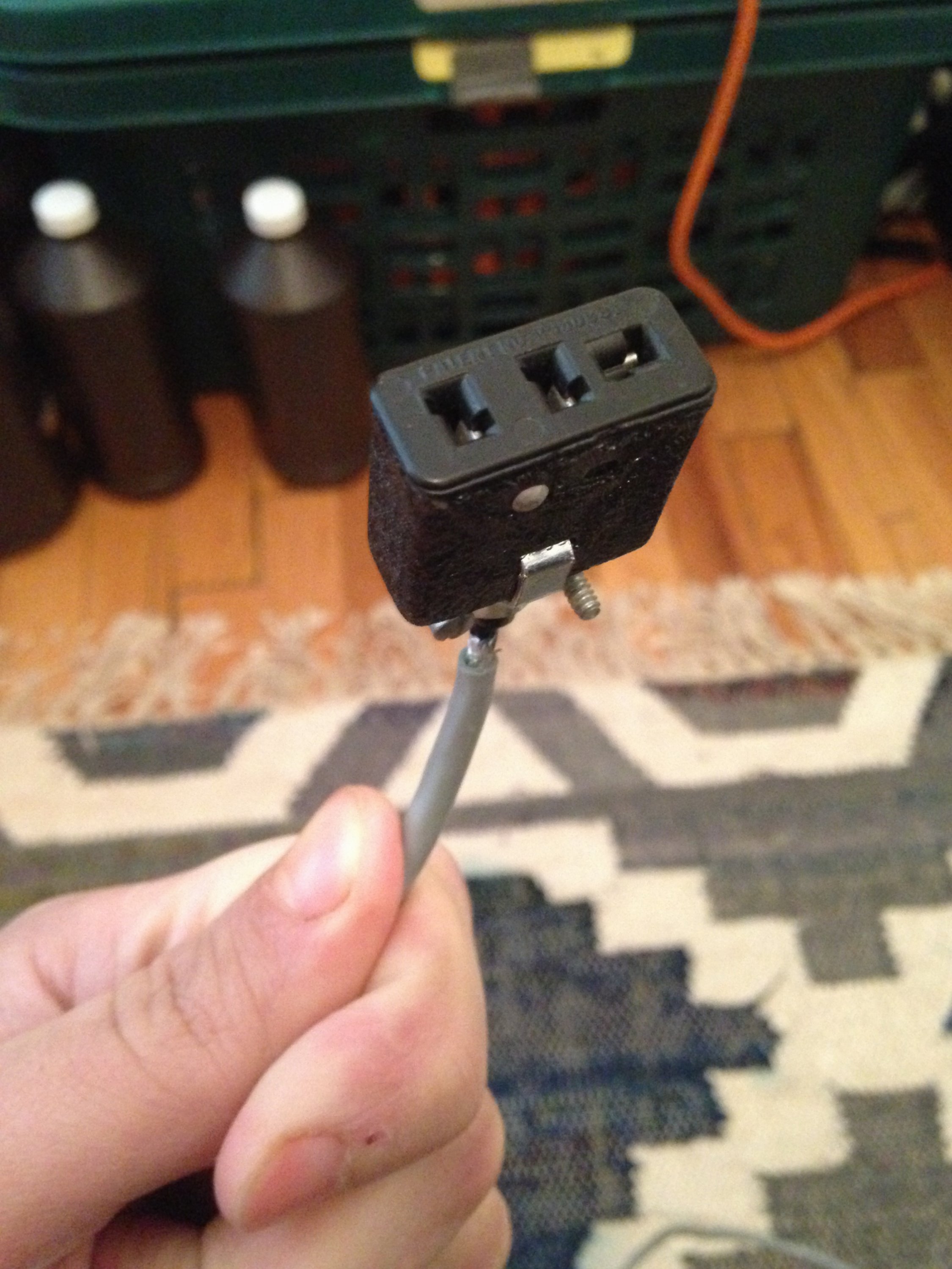

Hi everyone,
I recently picked up a Zone VI stabilizer unit but realized it does not have the right "cell" plug fitting for the cold head. It actually looks like the same plug type used on my enlarger timer for a footswitch or something. Can anyone identify if this was a factory option or was changed by the last owner/ why that might have been done and what I can do to potentially fix this? Even if I can get someone to replace the plug, I would consider it but don't know how to identify the type that would be needed.
Any help is greatly appreciated.

The rectangular one is a 3-pin "Jones" plug; been around since before WWII.
They're still available from places like Mouser and Newark. Several different families (different sizes).
The round one on the box appears to be a German standard DIN plug, more popular in Europe than here.
There are approximately 37 zillion different pin combinations / configurations.
Also, some families/series are only rated for low voltage, not line voltage.

I have a 'new to me' Zone VI cold light system i just acquired. I have the same stabilizer and the back of my cold light looks the same. The female plug you are holding in the attached picture looks like it was definitely added by the previous owner. i can confirm, that is not the standard plug. As to why it was changed, i cannot fathom at this time. It does look exactly the same as the foot switch plug. Maybe the previous owner was confused? I do not know how unique the cell plug type is. Maybe take the cold head into an electrical supplies store and see if they can match it? If you are successful finding the right plug head, attaching shouldn't be too difficult.

I guess you have two options, First one(obviously) find the right plug & cable.
Or. Make an adapter female jones plug to male din plug. No idea which would be easier & faster.
Not zillions... but 9 versions.
And the 3-pole was very common
No DIN connector was rated for mains voltage, only for small-voltage (34V DC)
They are likely no longer manufactured, but still available from stock.

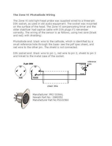

Hi Austin,
I was going over my old notes and found the Zone VI Photodiode Wiring schematic diagram. It's a poor photo but still legible.

It looks like that's covered, assuming the OP's wiring is consistent with Rick's document. The head would be the photo diode end, and the wiring from the stabilizer would be Black to pin 1, Red to pin 2, and the shield to pin 3.

But is the wiring in the cable from Stabilizer to the 3-pin plug the same? "Yes" would be a good guess, but I wouldn't be sure. See LeighB's comment above.

I have had a look inside the plug on the captive cable on my old Zone_VI Stabilizer. The connections are:
pin 1: black
pin 2: red
pin 3: transparent sleeve presumably over the shield (hard to see as the cable's cover is tightly held in the clamp)

I should have added that the pin numbers are moulded into the plastic base of the DIN plug, on the inside.

use your meter to find the 2 grounded pins.. the 3rd is positive.
