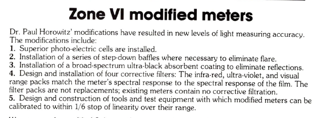

I just dug out my Zone VI Workshop 1974, the last chapter is a list of products. "We leave nothing to chance. We test every meter for linearity, accuracy, and color sensitivity before we ship."
There is no mention of modifications to the meters, only calibration to spec.

Paul - Zone VI offered two different varieties of Pentax meters - straight out of the box, with simply a Zone dial sticker added, versus the internally modified ones (likewise with a sticker). The catalogs and price sheets showed both. I never bothered with his News Letters.
And there's no reason to surmise they ever calibrated any meters other than the ones they modified. They merely claim to have double-checked them for accuracy prior to shipping, which was basically redundant because Pentax did it so dependably themselves, decade after decade.

I had some spare time and rooted through my "Zone VI" folder and found a brochure from 1985.
There you go. Note no. 4, filter packs to "match the spectral response of the film". Which film? - there are all kinds of them, including color films. I was told it was "Tri-X" - the then
320 sheet film version. How does that kind of spectral balance compare to color films, or even other types of panchromatic black and white film? That's the Achilles heel to the whole concept - specialize too far one direction, and you undermine to an extent other potential uses.
