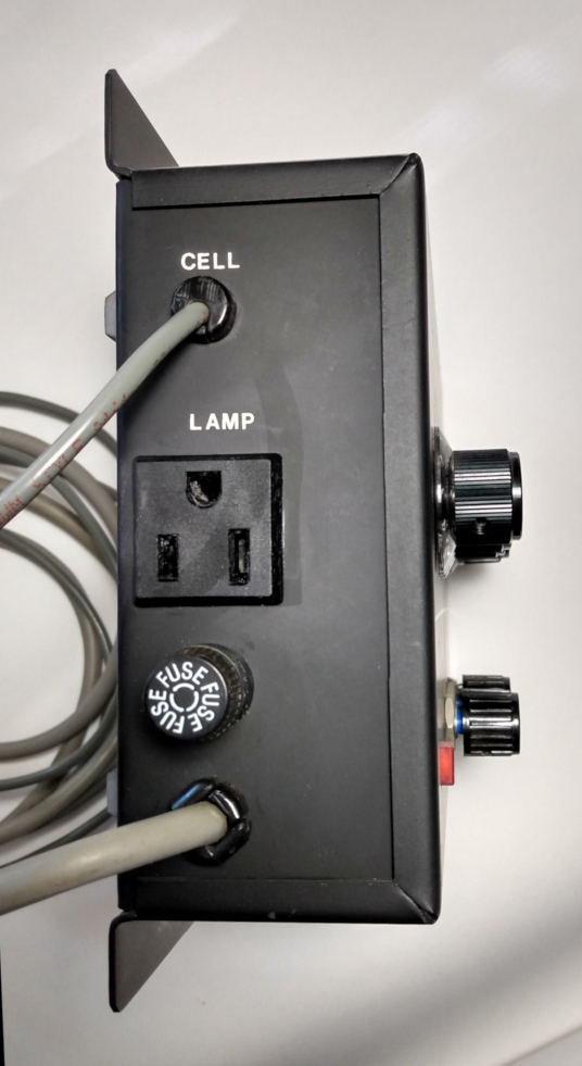

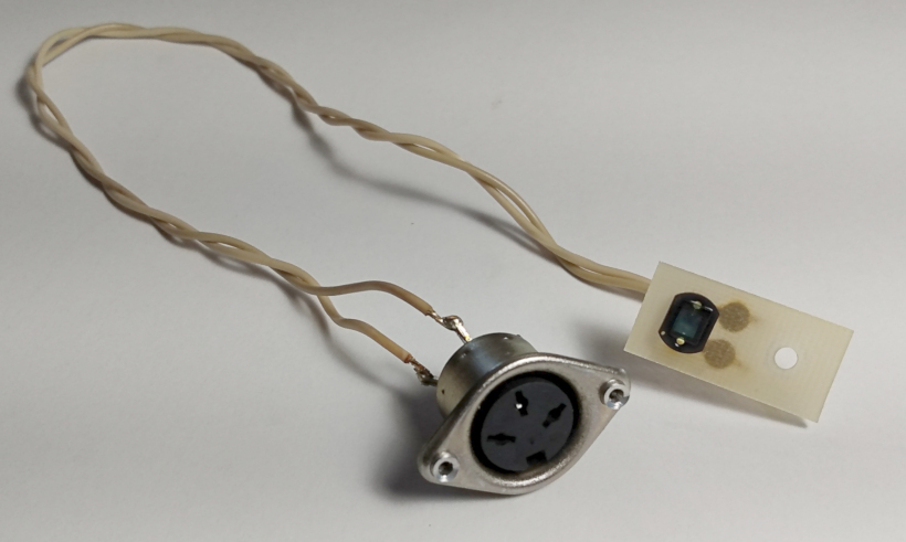

“Compensating” refers to the timer’s ability, with the sensor, to compensate for variation in the light output of your lamp from voltage fluctuations (e.g., air-conditioning switching on), giving you print-to-print consistency. You need the sensor for this timer work, and I’m including one, which you’ll need to install in your head. Mine was used on my bought-new Zone VI coldlight head, which came with the sensor installed; I removed the sensor in case I should need it someday, when I replaced the coldlight head with another. (See below regarding the head.) Boy, did it save me paper with my uncertain house voltage! I remember seeing another user who used his with a tungsten bulb, with the sensor a few inches away.

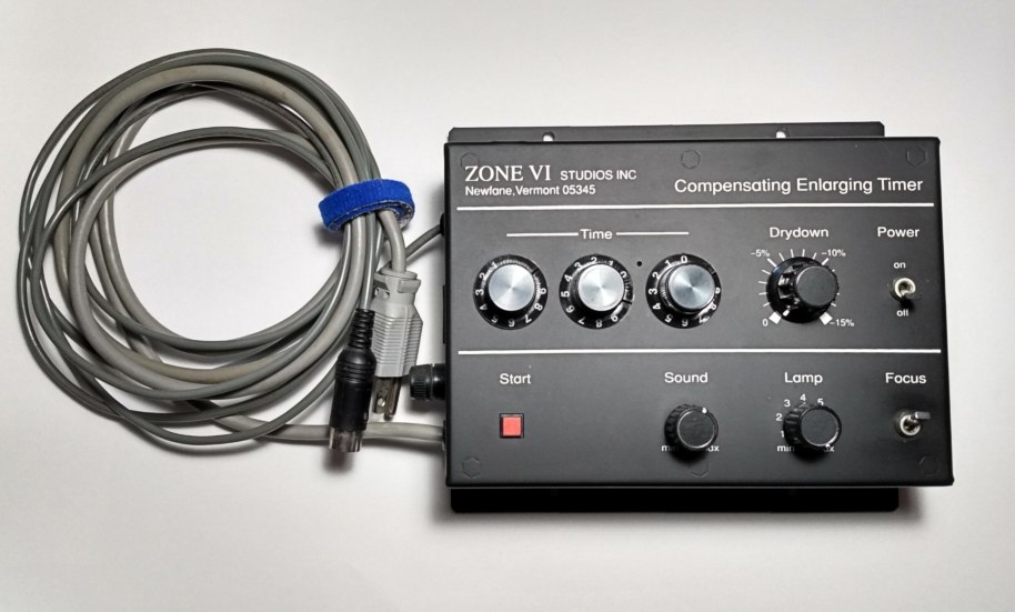

This is a fabulous tool, beautifully designed. Dial in exposure time in increments of 10s of seconds, seconds, and tenths of seconds with three dials. Max time is 99.9 seconds. I use multiple shorter exposures, and the tenths of a second are indispensable.
Additional dials adjust for lamp intensity, one-second beep volume (which can be zero if you prefer), and dry-down percentage. On/off and focus switches complete the controls. Oh, you can calibrate your seconds as well. The dry-down control allows you to get your print highlights exactly where you want them and then simply dial in your tested dry-down percentage, often between 3 and 6 percent.
The timer can be operated by foot pedal, connecting via standard phone cable. I am keeping my footswitch, but am including a new cable. I have seen electric guitar and similar foot pedals for very little. I’m not electronics savvy, so I don’t know how to make the required adaptation, but others will, if you don’t.
The timer is in perfect condition, never having left the dry side of my darkroom—and I’m very careful to water and chems on the wet side.
