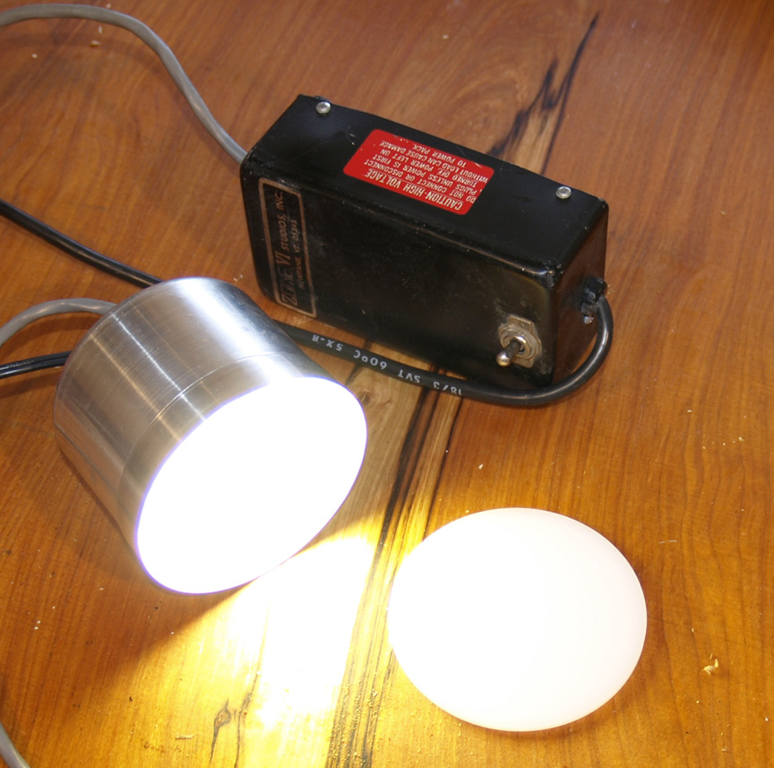

Here's a photo of one I've been offered. Obviously a very early one and not the blue/green for variable contrast paper. I'm told it's for the B-66, but I can't find reference to that. I'm asked for the diameter; hoping it fits a D series.

Do not know what enlarger you have but the B-66 is for med format negs 6cm x6cm, it would be to small for a Omega D series (4x5) enlarger.
Mike
Mike
I know, but I'm not sure it's really for the B-66 as I can't find any reference for a zone vi head designed for that enlarger.
It would have to be pretty small to fit in a B-66. That looks like an assembly for an early D series. (I could be, and often am, wrong)
