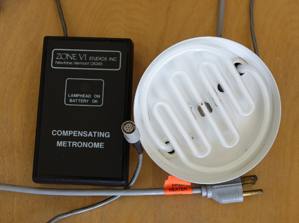

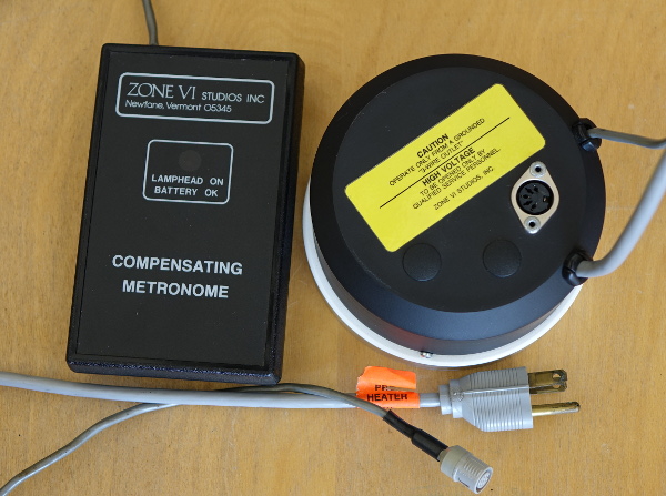

Does anybody use or have knowledge of what kind of ballast or power pack is needed for a Zone VI cold light in a Beseler 23 C II enlarger? I got the enlarger with the cold light head many years ago, but never used it because it was missing the power pack. I have looked inside the lamp housing and found a heater element that plugs into a standard wall outlet, but there is no ballast inside the lamp house. There is a cord with a DIN connector that apparently plugs into an external ballast box. There is also a photo cell inside the lamp house and I have a compensating metronome that plugs into that.
So, my question is, what kind of power pack/ballast/transformer is needed to power the light? I would appreciate if somebody could perhaps post a photo of the unit so I know what to search for.
I have found a similar Aristo cold light with a power pack that is a simple box with an on-off switch. It is labeled "BES 23-C". Does anybody know if this power pack would work with the Zone VI light?
Any help to shed some light (no pun intended) on this is appreciated.

ive never seen one with a power pack. my lamp has one cord that plugs into your timer, the other is a heater that plugs into a regular outlet.
the din plug up top is connected to a CDs cell inside the lamp housing which some compensating timers will use to control exposure depending on the lamp's output... like auto exposure in a way since cfl bulbs don't come on at full power each n every time, plus the slight delay in some.
I'd be curious to see the manual for yours?

The lamp you have is self contained and has the ballast built into the lamp housing. The DIN jack on top of my lamp goes to the photo cell you mentioned and is connected to the compensating metronome, which as the name suggests compensates for the intensity in the lamp's output and functions as a timer. I don't have any manuals, but the metronome should put out one beep per second and you count the beeps.
The power cord to the lamp has a DIN connector, which connects to the ballast box. There is additionally a 3-prong power cord for the heater in the lamp.
I have located a couple of Aristo power packs online that probably works for this light, but the connectors are different so I would have to re-wire the setup or change the connectors.
