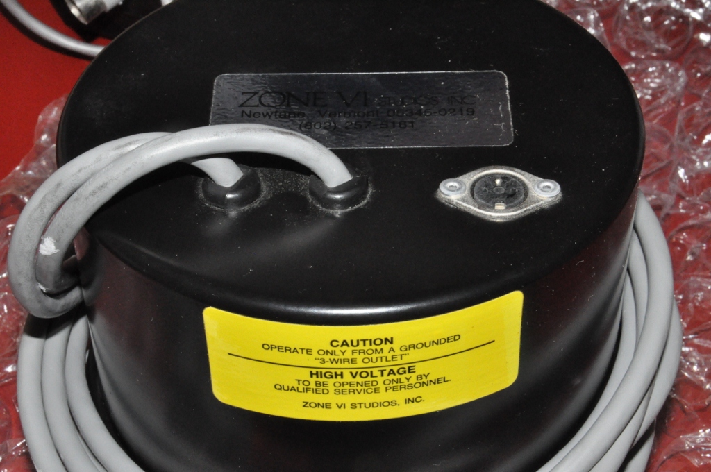

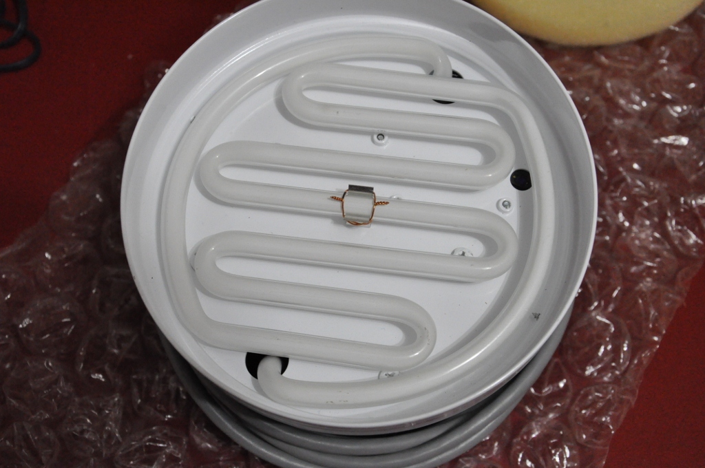

I picked up a Zone VI Cold Light head for a Beseler 45MX as part of a darkroom garage sale and had a few questions that I can not track down on the internet.
1) Is there anyway to tell via the attached photo what lamp is installed?
2) Anyway to identify the model / age of the cold light? There is no external componets just two wall plugs one for the lamp and one to keep the lamp warm.
Thanks in advance.
Todd

The best way to tell is to turn it on; the standard 'cold light' is quite blue and the V54 VC head looks considerably more greenish white. You can use the colder light with addition of few yellow color correction filters but I never did, it just shifted the contrast scale over so that I needed to use a 1/2 or 0 filter to get to a 'normal' grade 2. I replaced mine with a V54 and the contrast shifted back up.

I realize this is subjective without past experience with which to compare, but if the lamp glows distinctly bluish-green (aqua?), it's likely a more modern V54 lamp intended for direct use with multi-contrast filtration (like the Ilford set). The coloration is pretty distinct.
If it glows more bluish-white, it's likely the original V45 lamp, which can also be filtered, but is a little more demanding when doing so, as the contrast grades are far less evenly spaced than with the V54.
The V54 is the preferred lamp. Compatible new ones should still be available from LCD Lighting (who purchased Voltarc, who purchased Aristo, I believe). Click here for the specific tube (D2-HI Replacement Lamp) I believe you would need. It's the same one I purchased as a replacement for my own Zone VI Cold Light head.
Jeffrey's advice is the way to go. Search the archives here for Ms. Kessler's email link. There should be dozen's of instances. She is the one who spearheaded the manufacturing resurrection of these replacement lamps. But I am not certain if she is still working, or if she may have retired.

Thank you all for your responses.
The unit does not have any other componets other than the Compensating Metronome. Not sure what is contained in the head itself as it is quite heavy.
The light to my eye was like a typical cold white flouresent bulb, I did not pick up on any hint of green and very little blue.
Thanks
Todd

Cold light was made by Zone VI. Age is hard to tell I would have to open it up. Will have the blue graded paper bulb.
The silver plug on the right is for the photo cell. that you can attach a Zone VI Stabilizer to or the Zone VI compensating timer.
