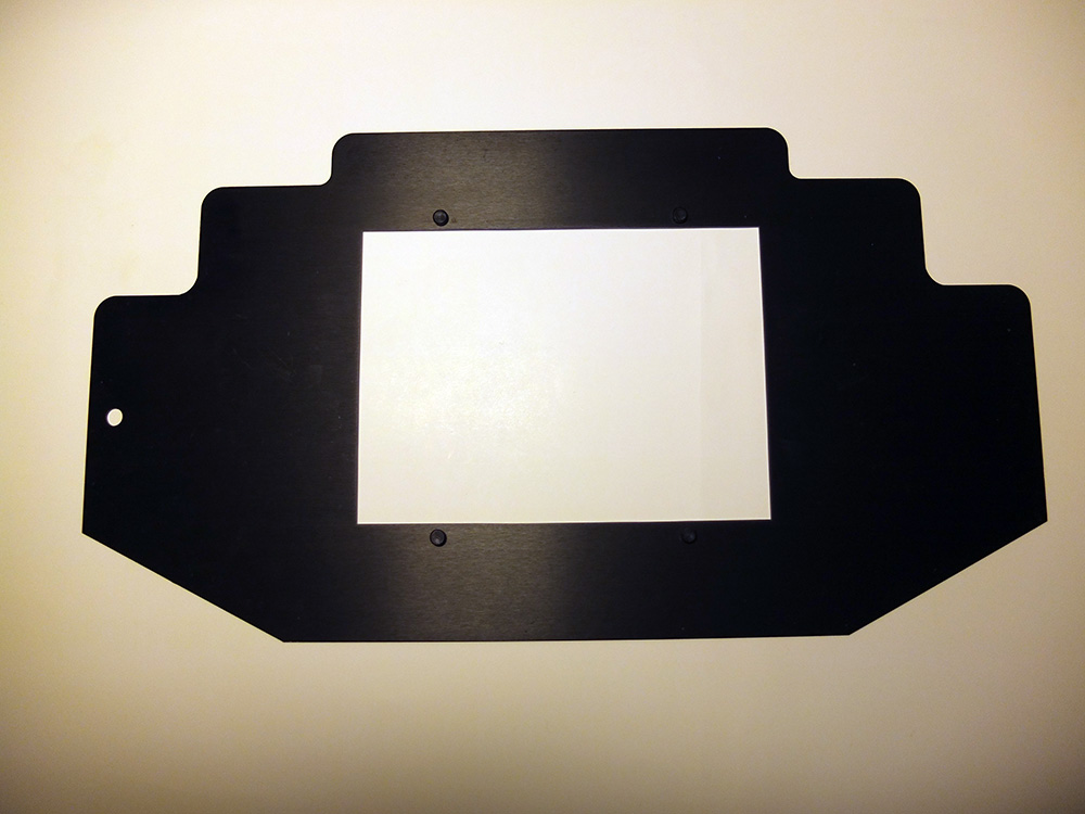

Well I guess the next day is what happened. I'm wondering if what I might have is the bottom part of the "Out Straight" negative carrier.DSC05980.jpg

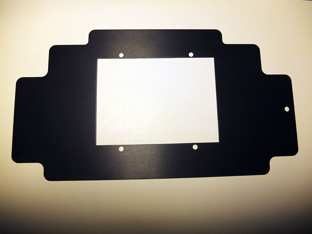

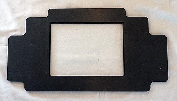

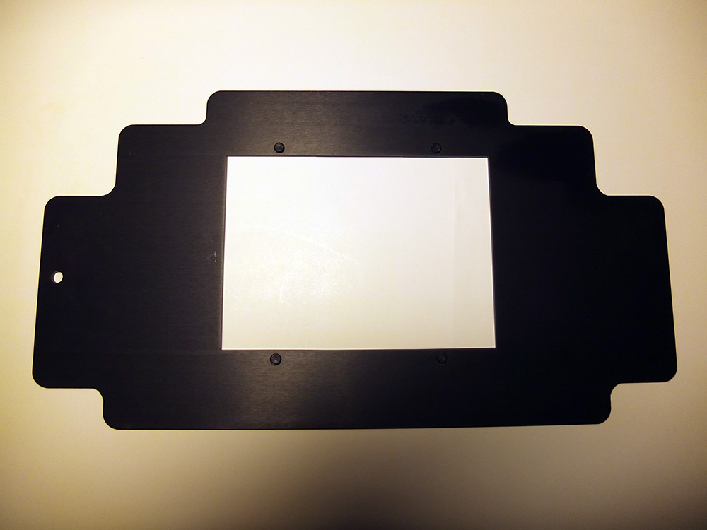

Here is the two parts of my 5x7" Type 2 carrier. Original one.
