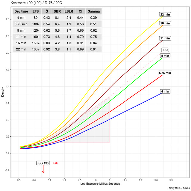

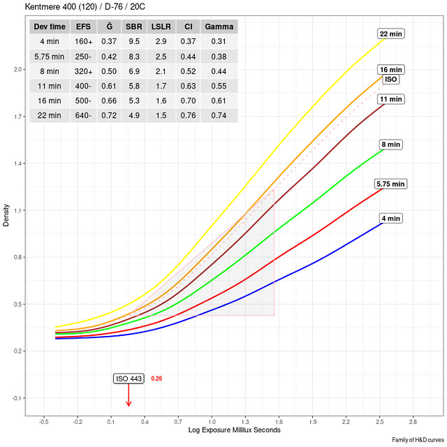

Andrew, this is a really interesting approach because it really digs deep into the film's performance. I thoroughly enjoyed watching the video.
I hope it's okay to add a couple of plots for Kentmere 100 and 400 (in 120 size) developed in D-76. Both films performed very well, giving box speed in my test.
