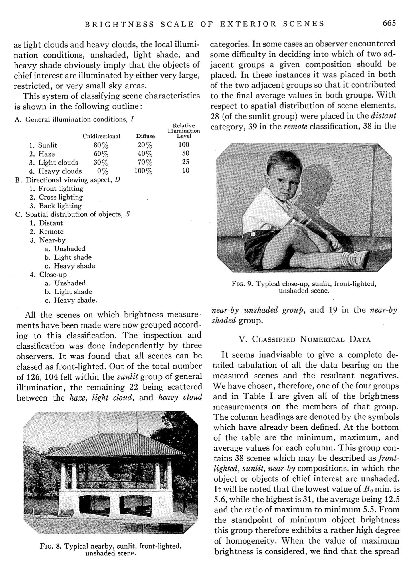

Scenes like that were used by Nelson, Condit and Jones to determine optimum film speed and darkroom printing reproductions standards for the industry. So, probably box speed + safety factor, normal development for your enlarger and grade 2 paper.
Thanks for the reply. What is the book that that page came from? (the one with the text?!)
Journal of The
OPTICAL SOCIETY
of AMERICA
VOLUME 31 NOVEMBER, 1941 NUMBER 11
The Brightness Scale of Exterior Scenes and the Computation of Correct Photographic Exposure*
LOYD A. JONES AND H. R. CONDIT
Kodak ResearchLaboratories,Eastman Kodak Company, Rochester,New York
Those historic papers are nice but to learn from a scientific standpoint I recommend Kodak's Sensitometry Workbook (free to download below):
https://www.kodak.com/uploadedfiles...en_motion_education_sensitometry_workbook.pdf
To learn from an artist's perspective use this:
