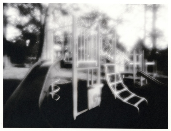

Zone plate pic
This is what I found when shooting a subject with hardish, contrasty edges. It seems typical of zone plate results.
Regards - Ross
