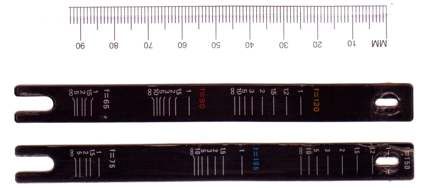

These Horseman focus scales (for 4x5" cameras) work with any camera that has the indicated focal length lens. Having a focus scale is the first part of the problem.

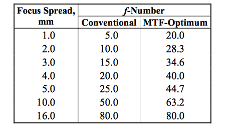

For the scales above, you need a corresponding set of marks for the aperture. The aperture range marks are dependent on many factors, CoC size, Airy disk size or a combination of both.
Rather than doing the math you can use this table:
For example, for conventional DOF based on CoC, you would make hatch marks 2mm (4mm spread) on either side of your focus indicator mark and assign those marks to f22 (round up from f20).
BTW I personally use the MTF optimum scale because I enlarge my Large Format negatives (even 8x10).
Also, since the math is not shown, I'll make it clear, the table below does not change with focal length. So you only need to make one set of aperture range hatch marks on the focus track and it will work with all of the focal-length scales above.

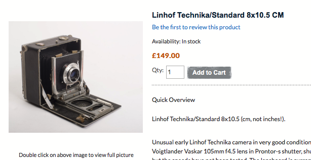

Yes, inches. It was a kind of huge pentaeder. Fix-focus.
