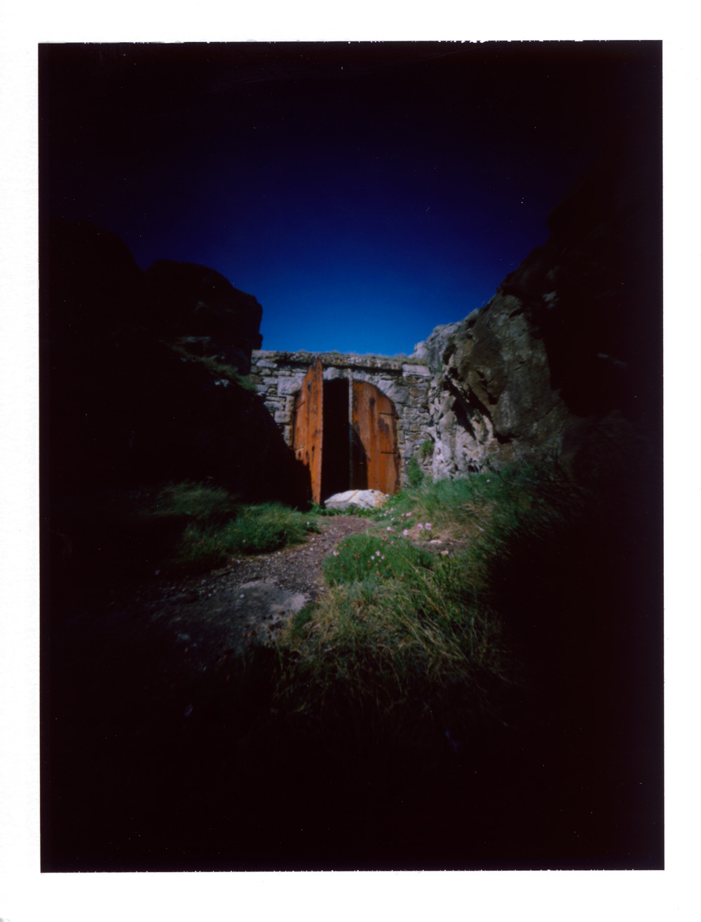

Ah, sorry, I'll try to put the image in public attachement here. casemate_anse_bertheaume_1.jpg
For the polaroid back princing, It's rather a matter of luck, but I still see some going off not too high on the *bay.
About reciprocity, I personnally found colors are much more faithfull with Fuji FP100C that all my previous tries with genuine polaroid, but I recognize I haven't ventured in the long exposure realm with these instant films.
How do you find the colors of the above picture ? Light fall-off apart, and being on the scene, I assure you these are "flashy", but close to reality.
