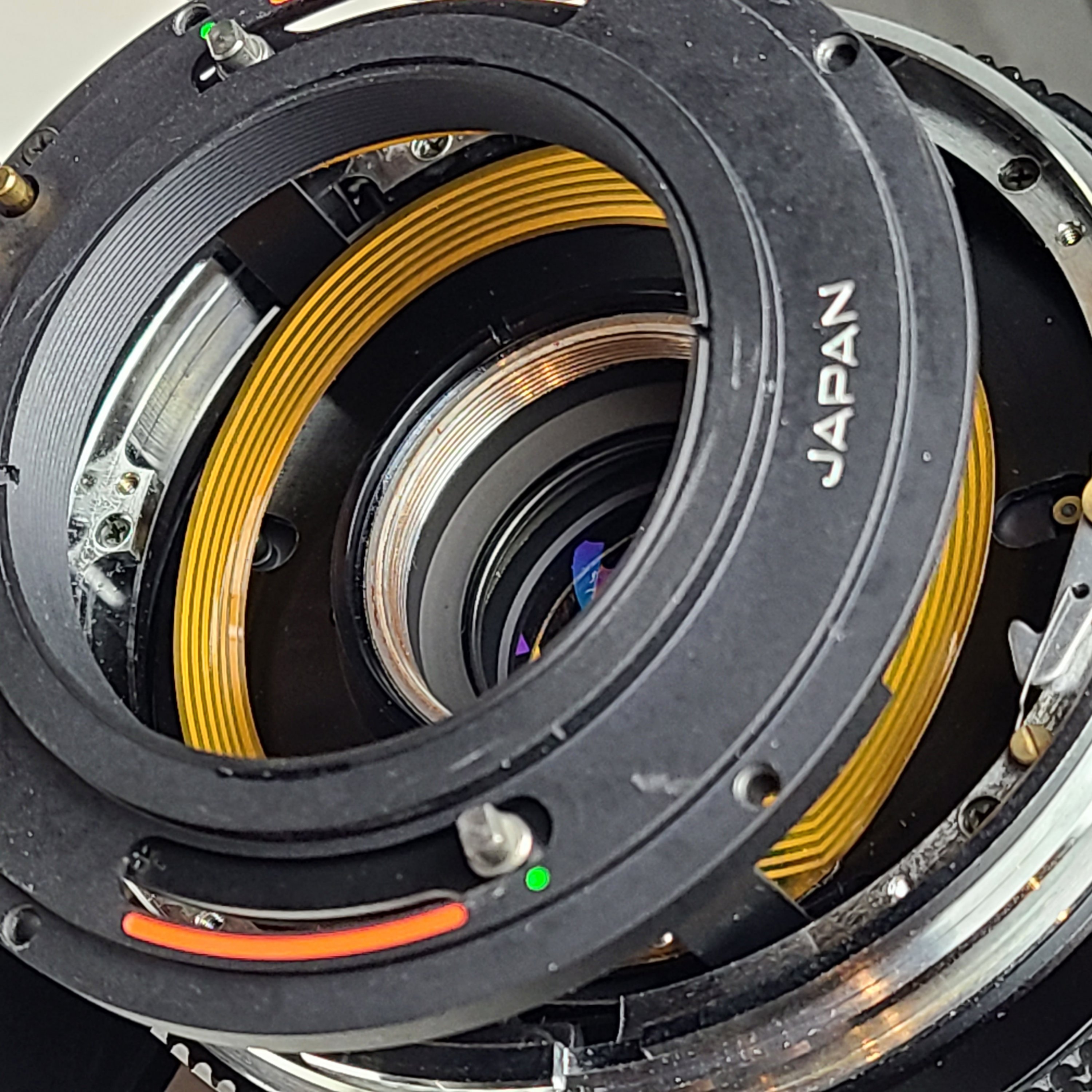

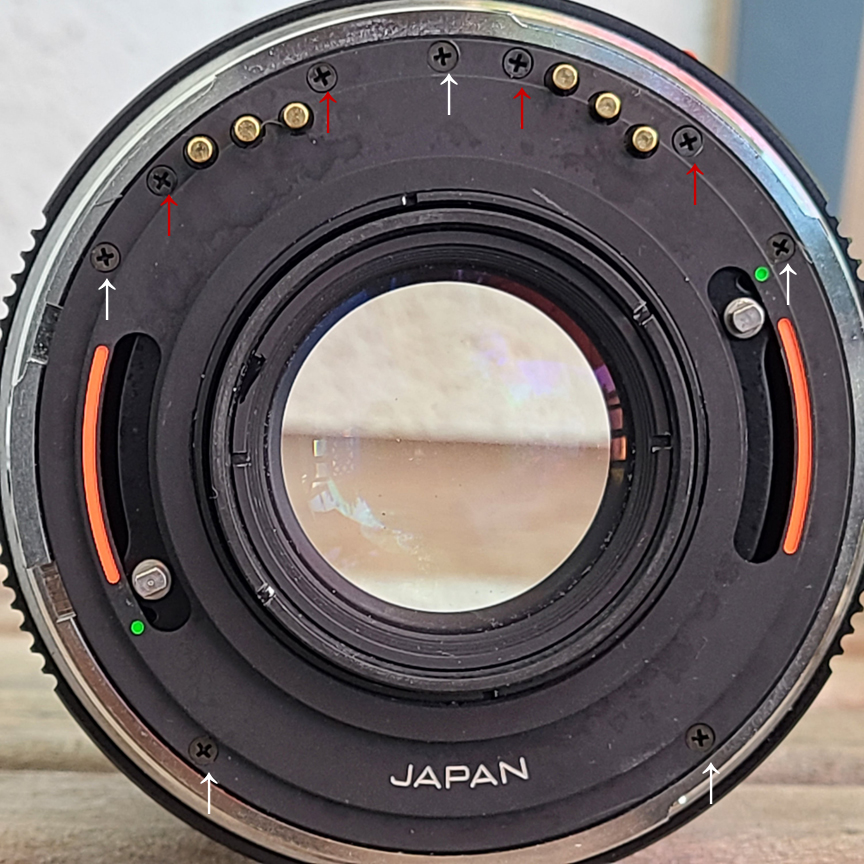

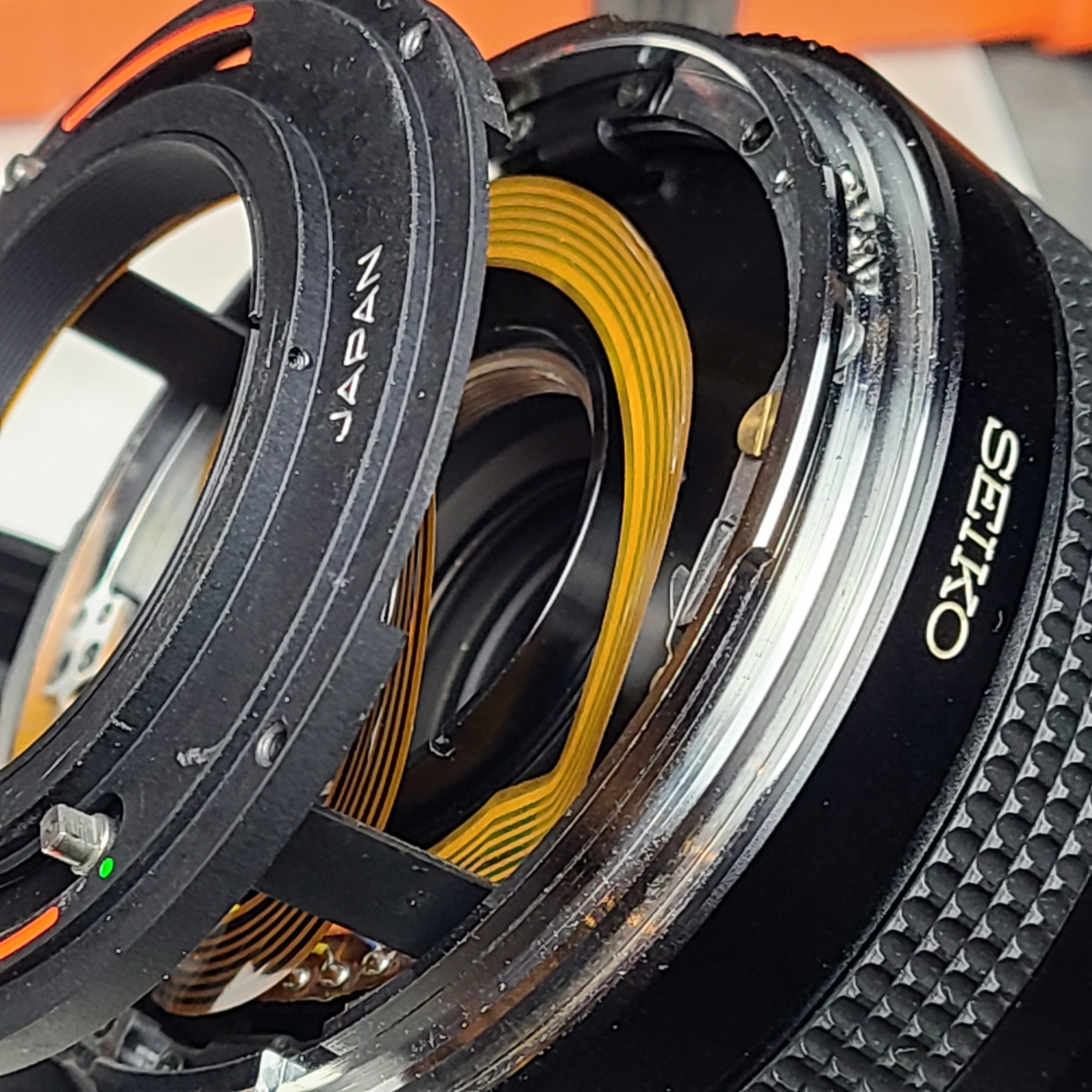

I'm not familiar with this lens or Bronica, however mechanical assembly is similar between brands. I'm currently reassembling my 60mm f2.8 AF Micro Nikkor working from a 2.8 D diagram. It was not auto focusing.
Now, the 5 screws at the white arrows hold the mount ring to the rear of the lens assembly. The 4 screws at the red arrows hold the electrical contact pin plates to the mount ring. You can remove the 5 screws (white arrows) and carefully lift up the mount ring and tilt it to one side to inspect access to the focusing assembly. Remove the 4 screws (red arrows) only once the mount ring screws are removed as the pins may be spring loaded, if they are solid then it will be safe to remove the screws holding the pin blocks to the mount plate before removing the mount screws (white arrows).
Post another picture with the mount plate removed.

Thanks a lot @shutterfinger. I will try it and post, it will take some time.

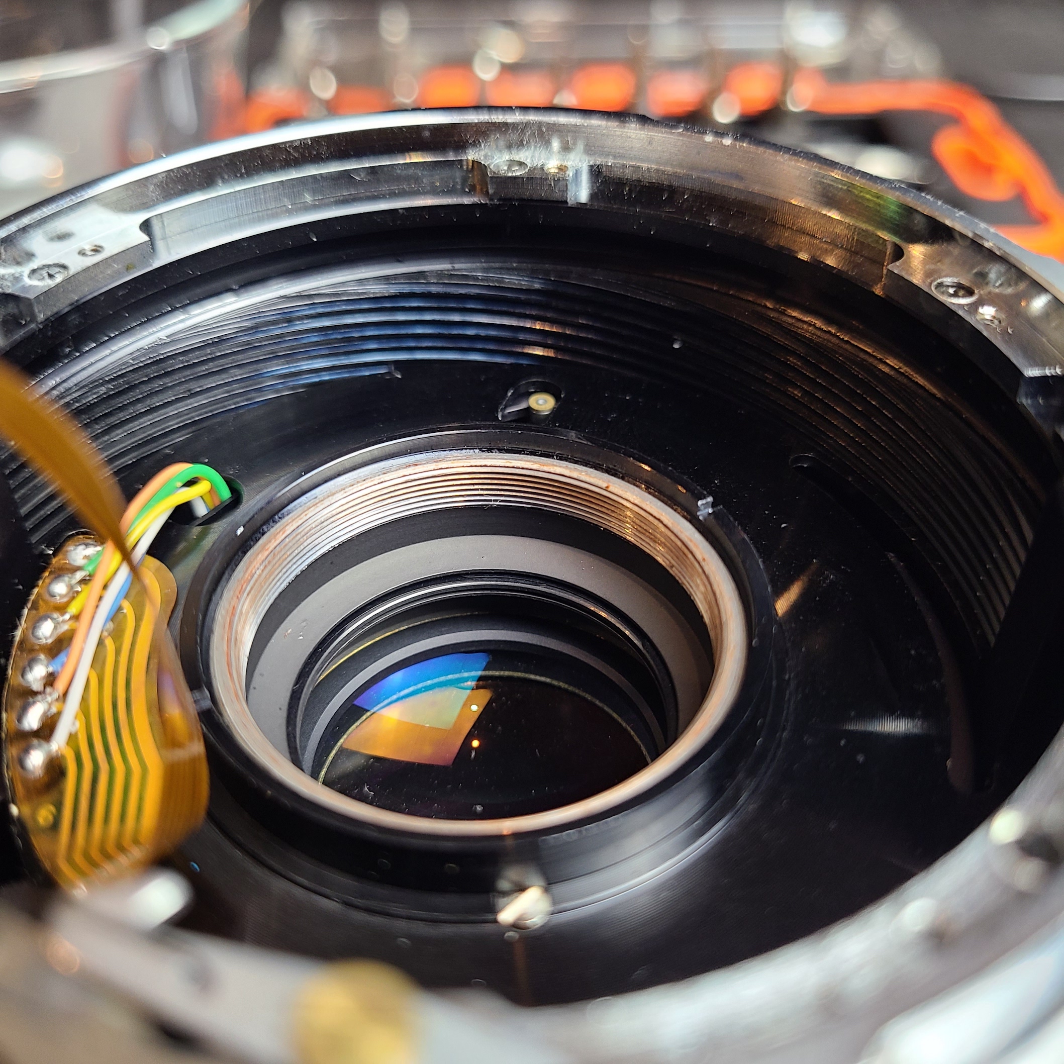

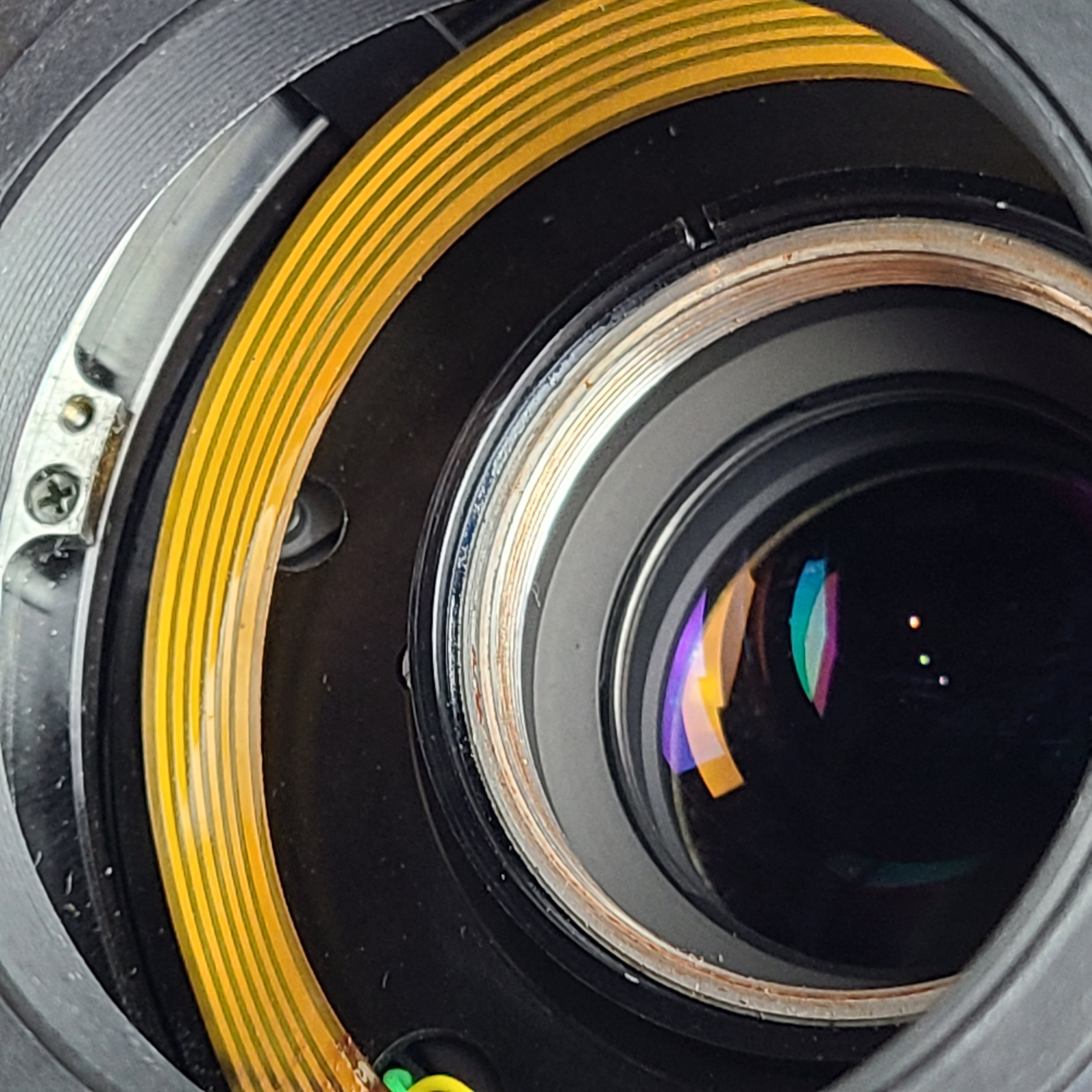

So far...

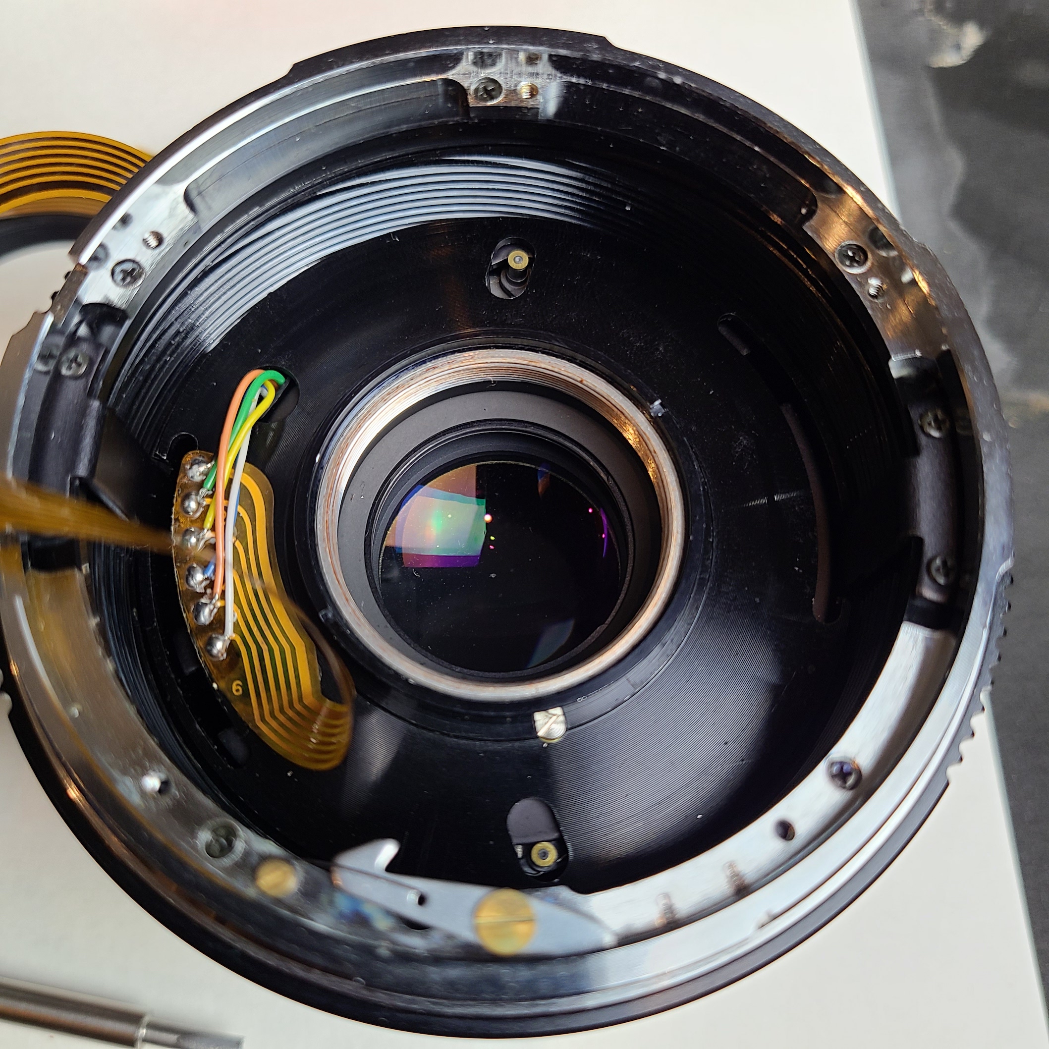

DMJ
DMJ
Nov 20, 2020
268
Los Angeles
Everything inside moves forward

I see what appears to be thread start points which I have typed thread start on. There may be more around the circumference of the barrel.
What I cannot tell is if the barrel comes off the front or the rear, need more pictures.
The cells appear to have fixed stop points so the only way they would be in the wrong position is if shims were left out.
