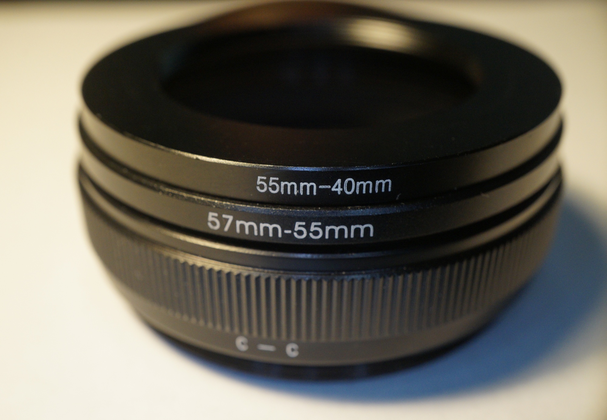

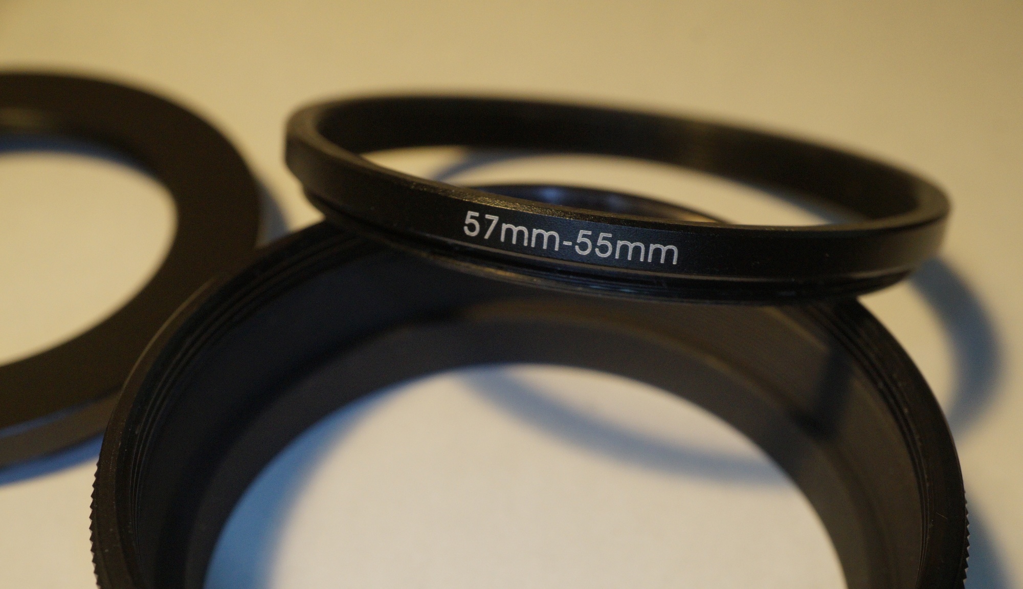

57mm rings are available.
This is a ~$10 adapter from that auction site:
Here it is on a stack for use on a S2a
My 120mm Rodenstock Imagon lens block threads directly to the 40mm ring, and the C-C Bronica extension tube (57mm thread) give the correct spacing for this lens. You can use any combination of extension rings and 55mm reducers to attach other lenses - for instance the 55-40mm adapter can be filed larger to accept a Copal #1 shutter
The S2 - EC Bronicas with the 57mm theaded helical focus units are ideal for adapting assorted lenses to this format.

Wow! This is exactly what I am looking for! Thank you very much! Normally the mirror flap of the s2a is quite soft - I don't necessarily need mirror lock-up, as far as I found out, which is not available with the s2a anyway. But: a central lock-up would be even softer I presume ...
DC Lohenstein
DC Lohenstein
Dec 15, 2017
23
Switzerland
PS. https://web.archive.org/web/20051212091914/medfmt.8k.com/bronadap.html showed some possibilities. I drilled a hole in a front cap, then glued a Nikon bayonet from an old F801 to the cap, with hot glue, and now i can use the beloved Micro-Nikkor 3.5/55 and the Micro-Nikkor 4/105 on the S2a. The flange to film distance is about 100mm anyway, so I will have about 56mm extension in the beam path from the beginning. I think, that with this minimum extension, the two 35mm lenses should also illuminate the 6x6 format ... Now I'm going to look for a blowball and then I'll try the combination.
