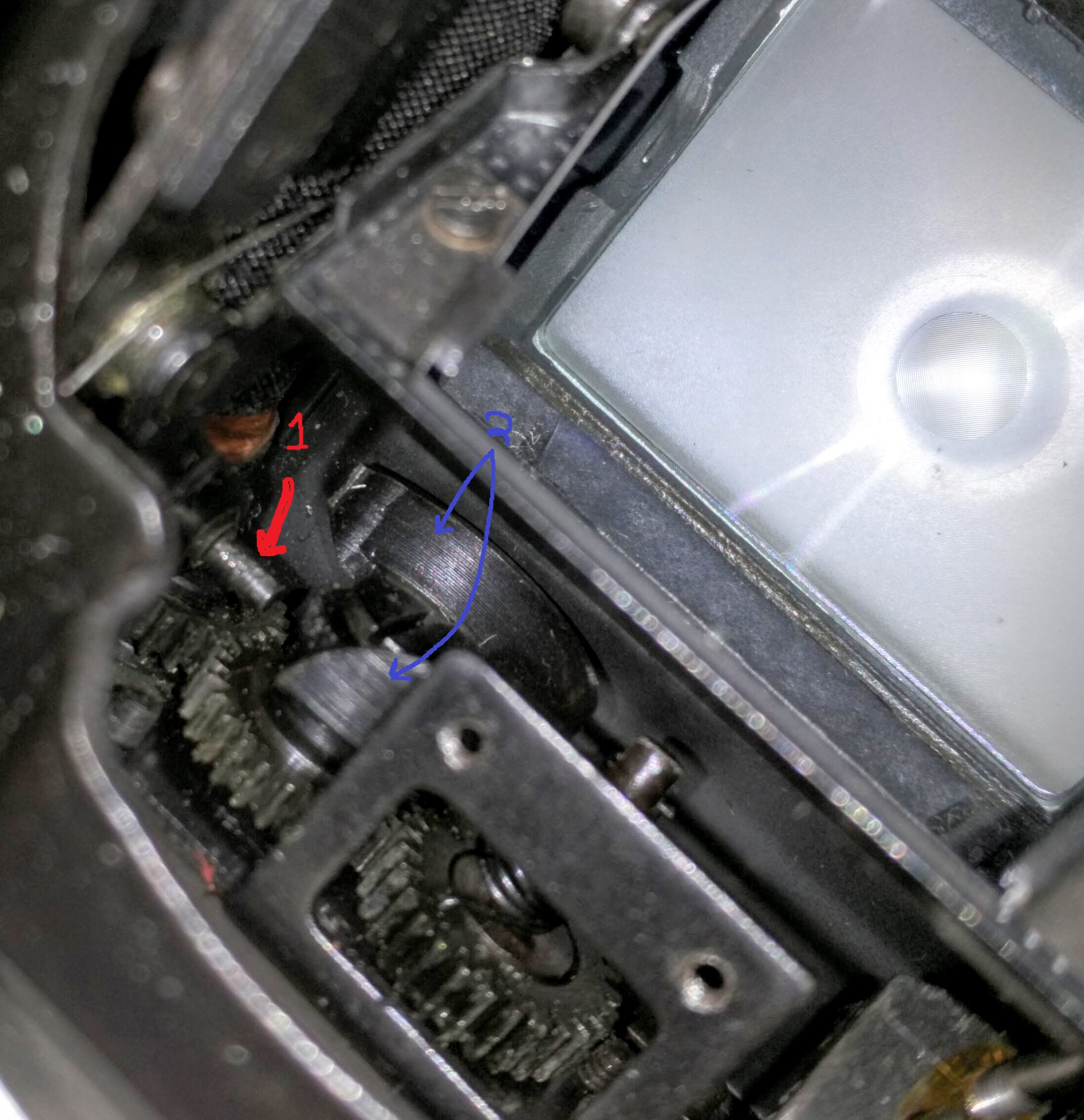

attachment.php
so here is what I was able to deduce... The arm that props up the mirror runs down below the mirror (1) isn't high enough to be manipulated by (2) which moves when the camera is cocked, and moves in a way to push the mirror up via (1) when fired. It doesn't seem like the arm attached to the mirror (1) is tensioned enough to keep it up, I'm not sure if that is still a symptom of lube being in the wrong spot. Any ideas? I took the camera apart as much as I was comfortable but I couldn't seem to really get the body apart.

Yes put it all in a zip lock bag and start reading... You are on third strike,
trythis
Sep 26, 2013
1,208
St Louis
I would guess gear skipped tooth or a spring broke. But thats a wild guess! Either way, keep digging, you'll enjoy the view along the way, but don't expect to make it a functioning camera again. I keep all my broken ones in plastic bags and farm them for screws and other pieces when a camera that I'm able to fix is missing something.
I'm sure that you're aware that this isn't helpful advice, unless you have something specific you're referencing in terms of reading material then I'd appreciate it if you kept the replies helpful. There is very little in terms of help literature for this model, if I would have found an answer on Google then I wouldn't be posting here. Thank you for your replies.
Yea I'm not expecting to have a fully functioning camera, if I can go for a quick and dirty fix that would be fine with me, it's fun for me to tinker with it but I'm trying to have at least some semblance of a plan in place before I have the thing in a million pieces :smile:
