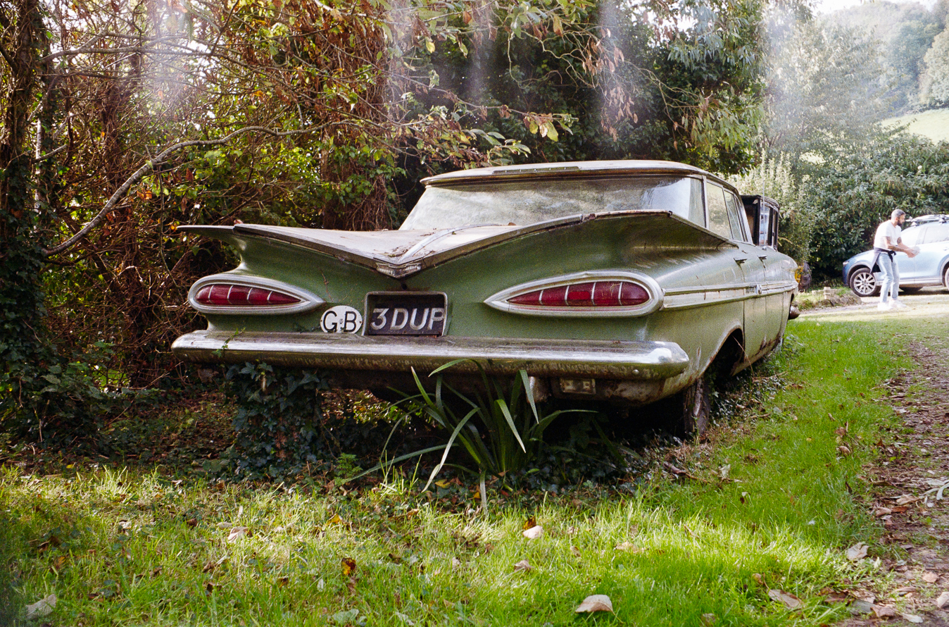

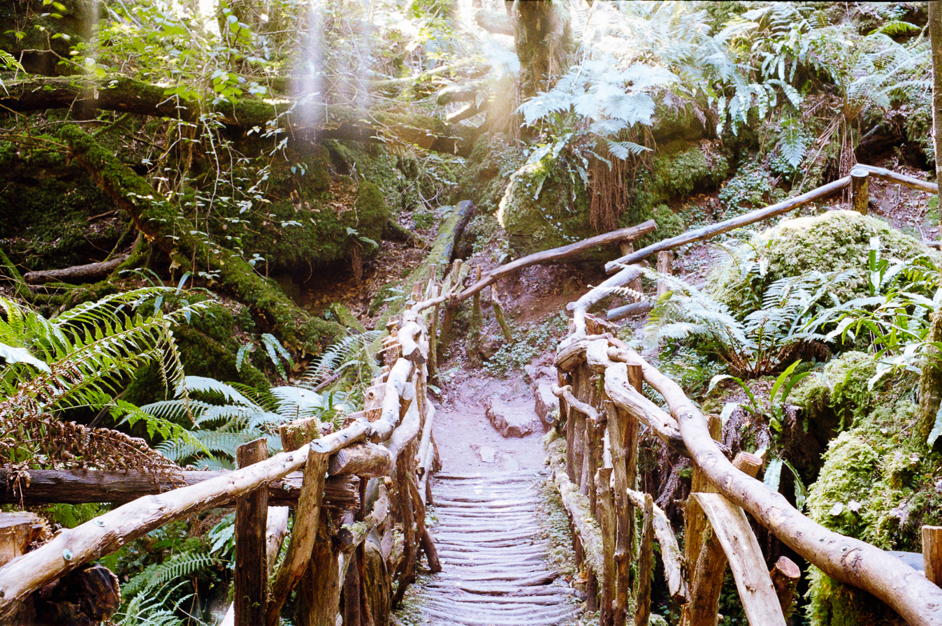

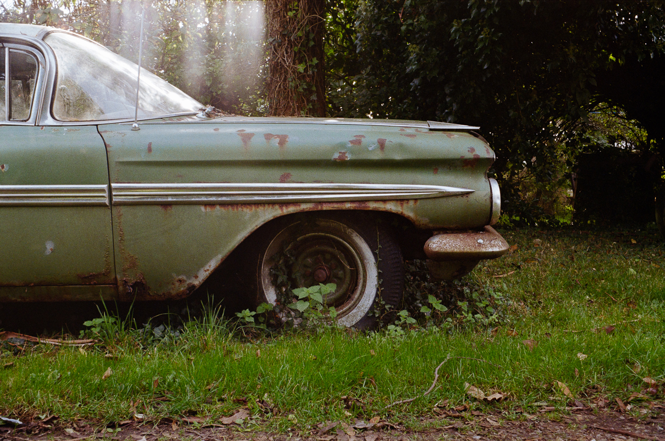

My beloved Zenit-E seems to have some light leaks. The lines appear to only be on the image, and not outside the frame in sprocket area. Only photos taken outside in the sun show these markings and they are also in different places between shots. Indoor photos are fine, with no lines!
Any idea what part of the camera is leaking to cause this? Any pointers would be appreciated!
Cheers
Janine

As the lines are in the top of the frame, any leaks are either nearer the base of the camera, or reflecting off of a surface nearer the base of the camera.

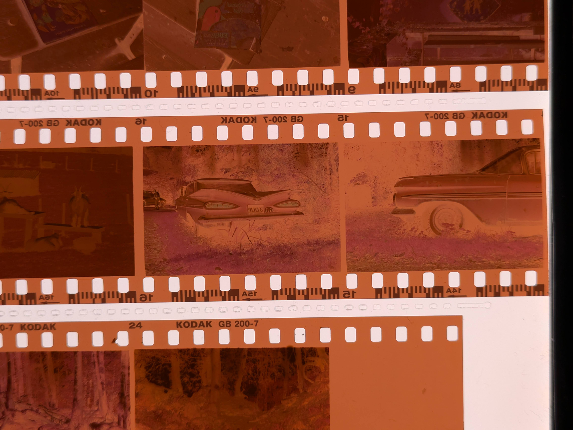

And by the way, I see some spread of the leakage outside the frame on the last negative, plus the leakage does appear to me to be in essentially the same location on each negative where it appears.
If the leak is somewhere near the feed side of the image frame, the variability may be due to the fact that when you carry the camera places, it sometimes is in brighter, more directional ambient light, and sometimes it isn't.
You might try temporarily taping over the openings on the camera - say around the back door - to see if that solves the problem temporarily, and gives you clues as to the specific location of any leak.
This is a very important clue, which implies that the leak is NOT at the back of the camera. Light leaks around the back would always involve the sprocket hole margins as well.
This is also pertinent.
Not around the back door; I don't think that's going to make a difference here.
I expect this problem to be at the front of the camera, but at the bottom alright.
