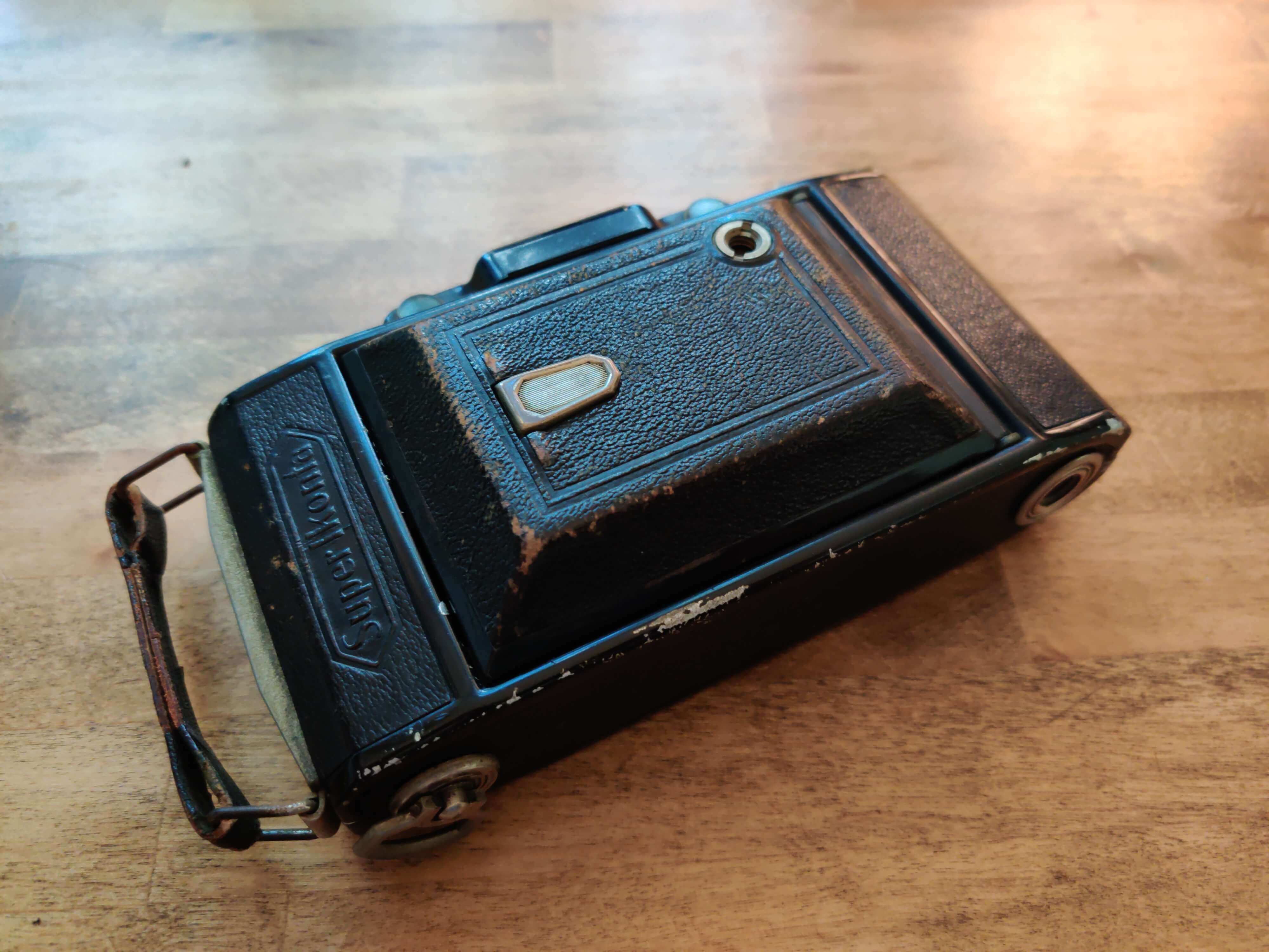

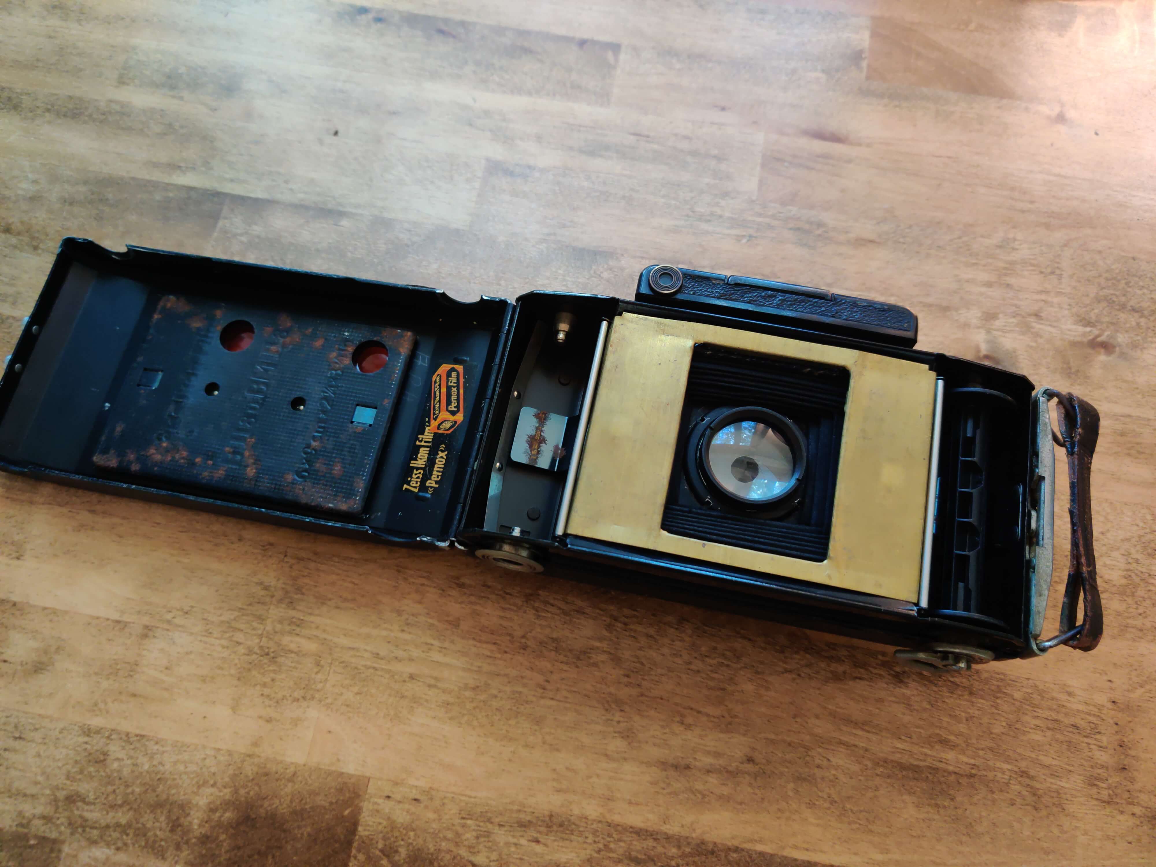

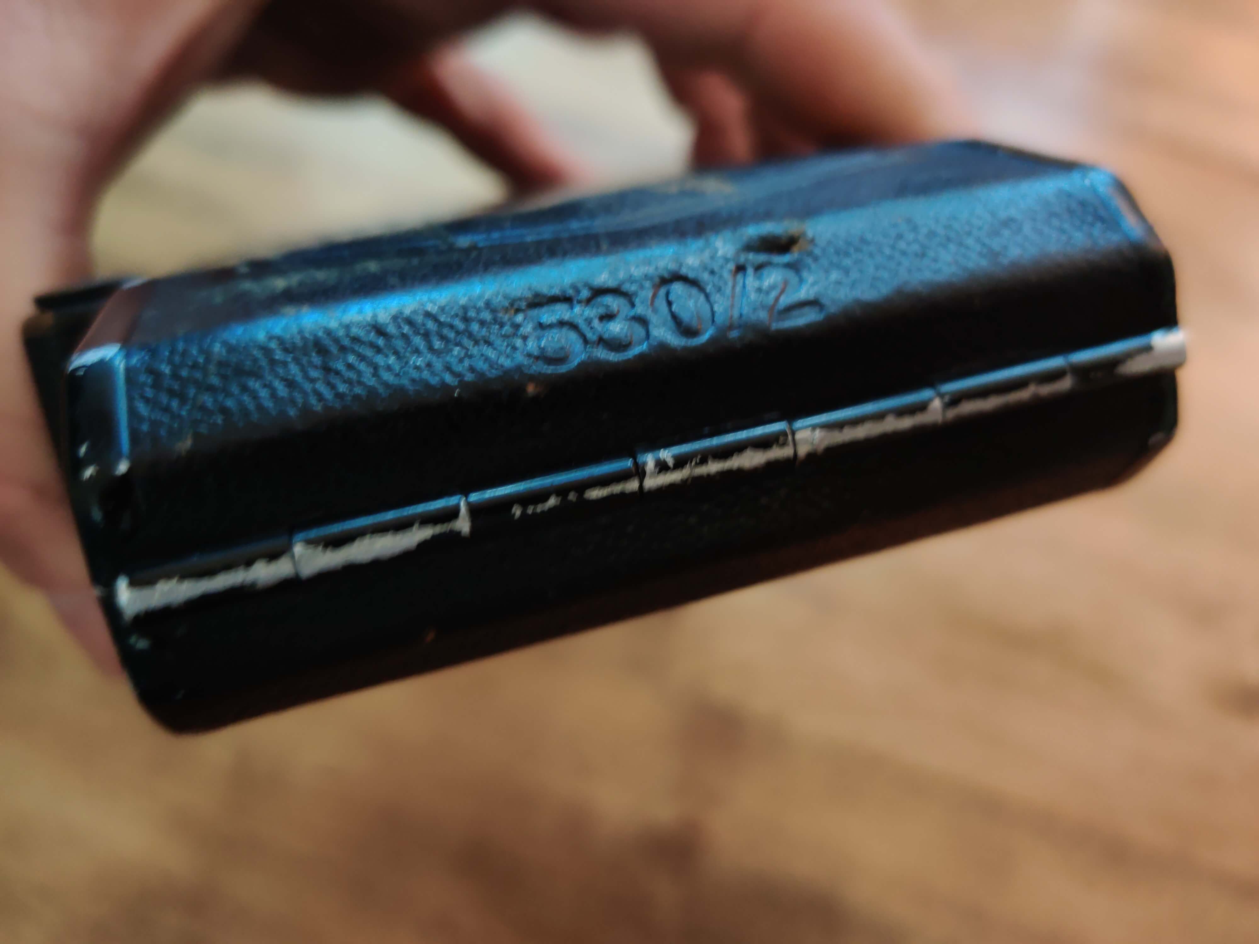

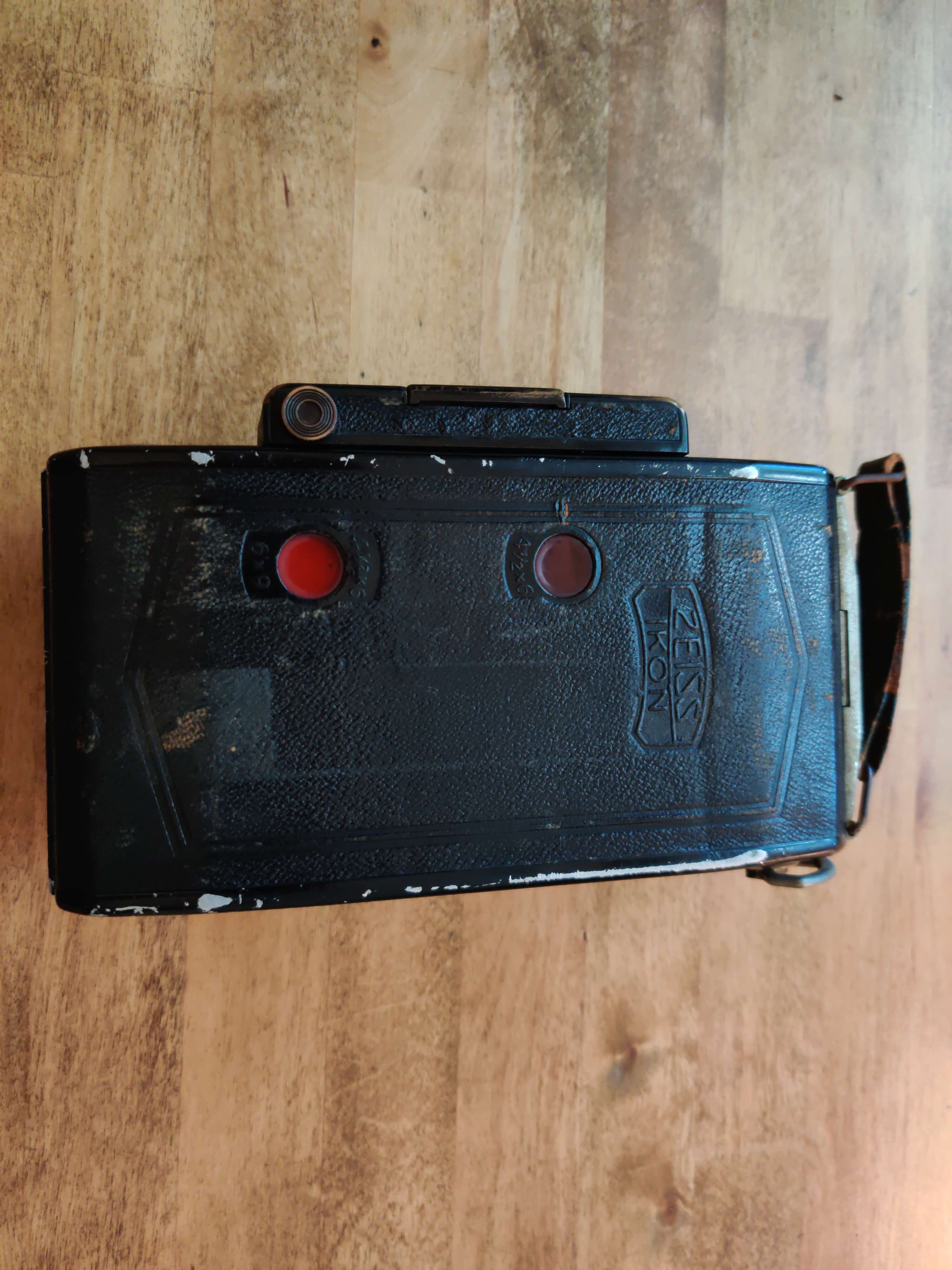

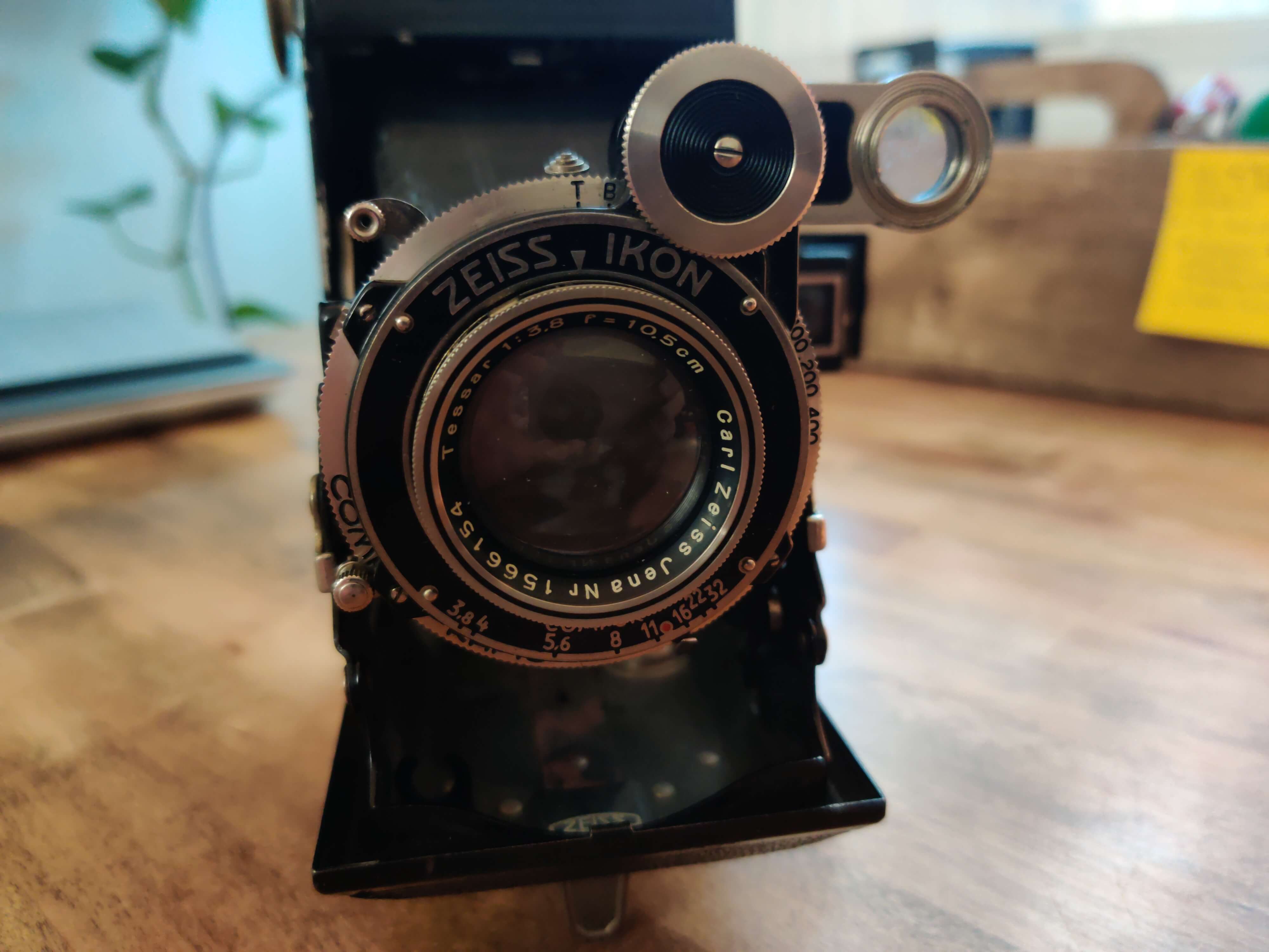

Hello all, I have a zeiss super ikonta c 530/2 F 3.8. Model number is Y 68464 on the case. The number on the lens is 4017860. I had a few questions regarding this camera such as the year it was manafactured as well as if its rare. Don't see too many online that is f 3.8. It came with a brass mask on the inside and i was wondering if that was original or if the previous owner made it. Any information will be helpful. Thank you.

I'm a bit confused. Photos have serial #1566154. This is 1934. You write number 4017860 which last 1960s.
Insert looks to be handmade later. Original would have some stamped elements for indexing and film location, and be black anodized or painted.
You use the 6x4.5 mask by moving a number from one window to the next before moving to the next number in the first window, etc. For full pleasure of120 film, try 6x9 (remove mask) at first.
Lens designs were changing fast in the 1930s. 4.5, 3.8, 3.5, etc. It probably comes up as rare because not many cameras from the first half of the 1930s are still around.
If the rangefinder is either off or dark, you can still do scale focusing and get good results. A nice 'pure' camera when Zeiss was making some of the best.

hello yes the serial number on the lens itself states that number however the number on the side back behind the dial to adjust shutter speed has that number. not the actual lens itself. sorry still learning the names of everything. but rangefinder is in working condition and clear. but thank you for your response. yeah the mask looked like someone made it but it works

The number on the side of the shutter is the serial number for the shutter itself. This listing gets the same year 1934 for yours.
Zeiss is one company. Dreckel, which made Compur shutters, is another company. Many cameras of this era were assembled from parts made elsewhere. E.g., Rolleiflex cameras had Compur shutters, Zeiss lenses. Or Schneider lenses. And a body casting made by someone else, etc.
