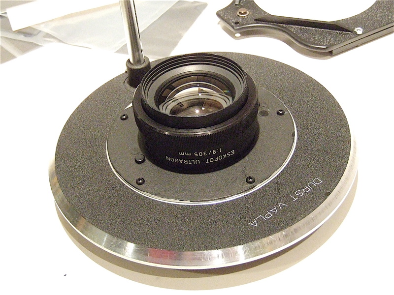

Great thing for photographers using conventional enlarging papers, a $25 'junk-bin' process lens can exceed the resolution of the printing paper (if magnification ratio is not too great and the lens is not stopped down beyond f22).
Realize that if this lens is used wide open the diffracting aperture is a massive 33mm! Diffraction with a conventional halogen lamp light source would be undetectable at any print size that fits on the enlarger baseboard (40")
AgX
Apr 5, 2007
29,972
Germany
The idea behind these enlargers not only is high resolutiom and eveness of lighting.
But stability and rectification. In fact they are not even called enlargers, but rectifiers. The with great effort yielded precision in mounting lens and film in a photogrammetric camera must not be lost at the rectifying stage.
