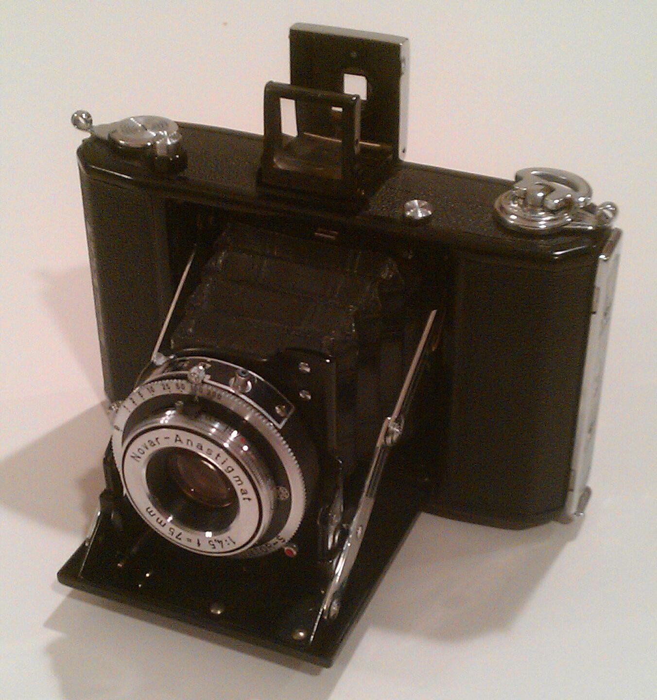

The first 120-roll from my 515/16 has each frame in focus in the very center only, with extreme softness surrounding it. This is true even when focused at infinity and with apertures smaller than f/5.6.
The images look like those made by a Brownie Hawkeye where people reverse a lens element. Artsy effect, but not what I wanted.
Could someone have done something like this with the lens? My pressure plate seems fine (though less stronger than I'd expected).
Loading the camera seemed no different than other rollfilm cameras I've used for 50+ years: just pull the film from feed spool over to take-up spool, with film laying atop the thin rollers.

My Nova is awesome. I bet a previous owner took the lens apart and put it back wrong. Try reversing the front or back lens, starting with whichever is easiest to get to.

If it's a lens reversed: the extreme lenses should have their convexity (bump) facing out from the lens. That is easy as a first check. If these look OK, try reversing the middle element; that is also the most likely to be inadvertently flipped in a previous intervention. Take notes and scribe marks in order not to lose infinity setting, or you'll have to re-calibrate. Good luck. Keep us posted.

If it's a lens reversed: the extreme lenses should have their convexity (bump) facing out from the lens. ...
Thank you for the reply and link.
Looking at it, the rear element seems to be reversed. Center might be reversed as well - I'll have to check that.

FINAL UPDATE: The problem has been resolved!
As you said, it was the rear element that was reversed - likely by some previous owner cleaning the elements. All is well now.
