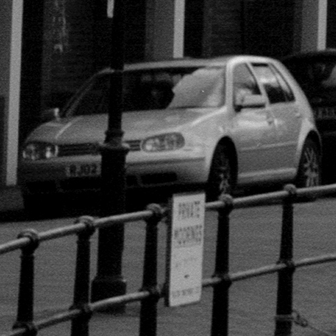

I certainly don't shoot this 1934 camera for the sharpness. It's a great camera, but well, 1934 Tessar, uncoated.... sharpness ? huhu..
huhu ?
Think again...
I just got a slap in the face this afternoon when scanning a TMax 100.
First is the image, resized from 8080 x 5165 (or "40 megapixels") next are the "crop" of the original...

Yup.
I'm not surprised. I've got one, too, though mine is 1950's era so prolly has coated lenses and such.
But still - when I get focus and exposure right, it does very well.
Not so good for closeups - then an old TLR is better. But for anything else, it's great.

You can't beat that for sharpness.
I have a Novar on my 6x9 and while not as sharp as yours, it's still pretty amazing.

That's a new one - most people seem to believe that old uncoated lenses are weak on contrast. Maybe you should develop the films a bit less?
I'm not at all surprised by the sharpness, though. I use Tessar (and Tessar-type lenses) on all formats from 35mm to 30x40cm, focal lengths from 50mm to 500mm, ages spanning a full century. They are ALL bitingly sharp!

Tessars were designed for f4.5 really; f3.5 was already stretching it a bit and I find that f2.8 makes it more or less useless at that aperture...
That depends a bit on the focal length. The 5cm/2,8 on my Welti is great, even wide open. So is the 7,5cm/3,5 on my Zeiss Ikon. And the various 135, 150, 180, 210 and 300mm f:4.5 lenses, and the 50cm/6,3 one. Shorter focal lengths can have larger max aperture without undue loss of definition.
This may be true in larger formats. However, two of the sharpest lenses for 35mm I ever checked were a Leitz Elmar 50mm f/2.8 and the GN-Nikkor 45mm f/2.8.
