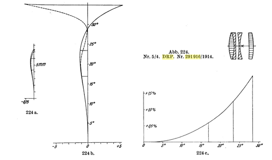

I'm not sure if the Robra-Anastigmat lenses were made by Rodenstock or not, but if they were, why not mark them as Rodenstocks? If they were four element lenses, Rodenstock had their renowned Ysar, and they had their well known triplet Trinar. Zeiss lenses on Zeiss Ikon cameras were always marked as such, except for the Novar and Nettar lenses that were bought in from other makers.
Now when I compare the serial numbers on the Robra-Anastigmat lenses, they don't fit in the Rodenstock range. They would have been made in the 1910's. But the serial number would have fitted a lens maker like C. Friedrich nicely.
With this serial number and looks, the lens might well be a 2,9/75 C. Friedrich Corygon: https://thumbs.worthpoint.com/zoom/...olding_1_e2c294905aba6143a847dad801bac537.jpg
