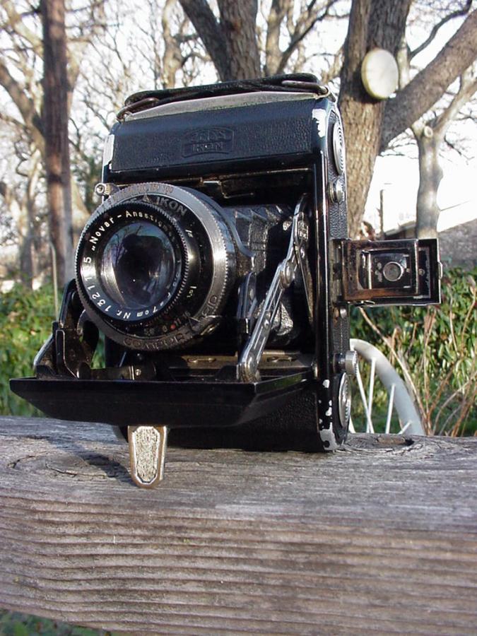

puderse
Sep 9, 2005
87
where the west begins
520 Zeiss
I was astounded by my first roll of film. Bought at garage sale and did nothing to it!
