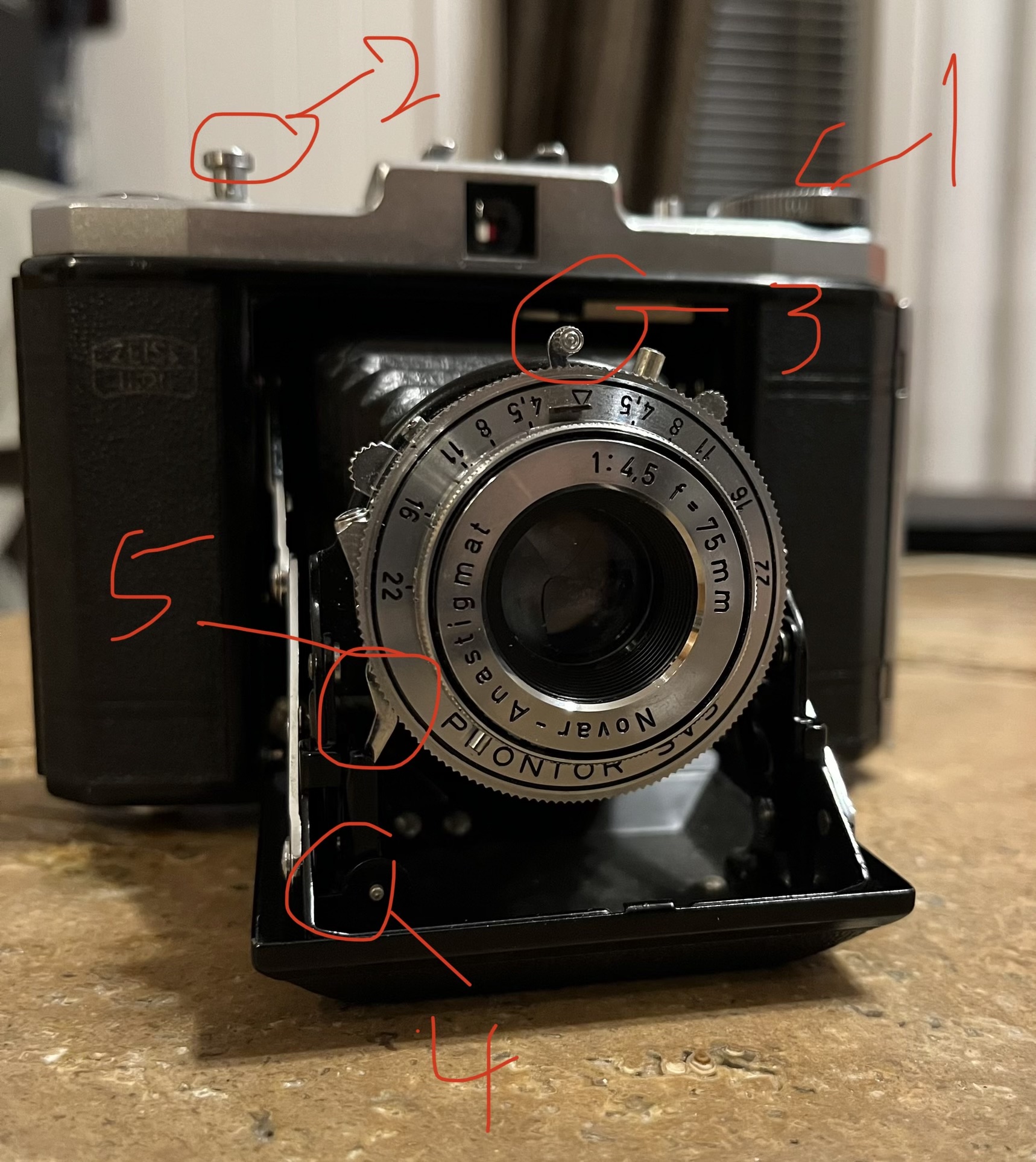

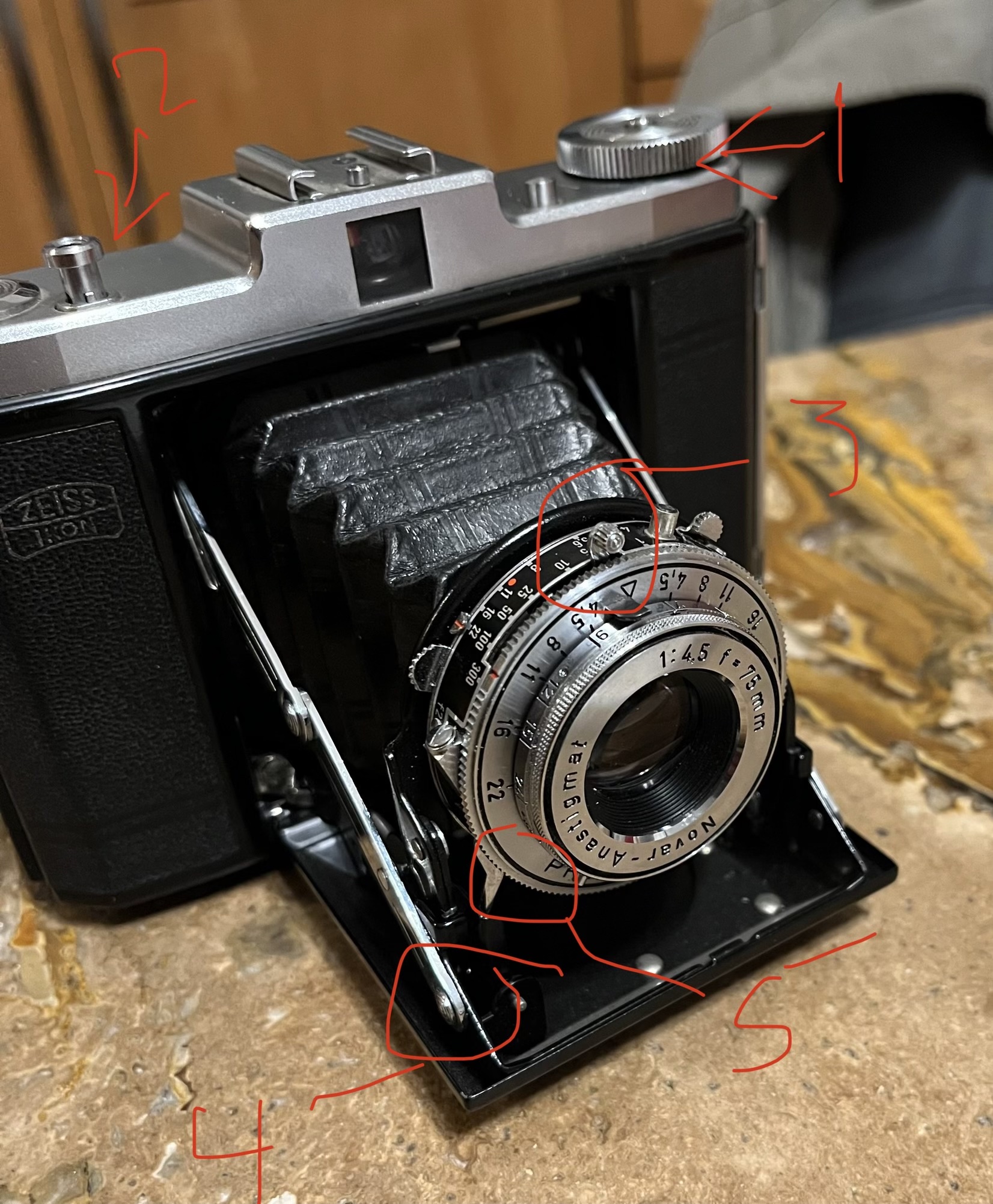

This time with illustrations. In attached photos, the key is the same:
1 = film winding knob
2 = body shutter release
3 = shutter cocking lever
4 = linkage from body to shutter
5 = shutter release
Winding the film and cocking the shutter (3), then press 2 to activate 4, that does cause 5 to move. Shutter still won't fire until I nudge 3 manually.
I suspect there's more cleaning needed inside the shutter. Maybe the blades? Not sure...

Try cocking the shutter and then pressing the silver part of lever 5 yourself with a finger or screwdriver tip or whatever will reach in there. The question is whether the body release is pushing the shutter release far enough to activate it. Another thing you can test is whether it fires with a cable release in the socket on the lens.
Also, if it does turn out that the shutter is hanging and won't fire until the cocking lever is nudged, I doubt it is the shutter blades.

The body release linkage does press the actual shutter release all the way, I just tested again. It seems the shutter cocking mechanism is sticking.

Yes, if 3, the cocking arm, being pushed will release the shutter then it is pretty certain to be internal to the shutter. Also pretty certin that it isn't a big deal. Just some old grease and dirt binding it up.
You could drip a little naphtha into the slot that the lever travels in. Not pour or squirt- drip! Small drops. A cotton swab wet with naphtha and lightly pressed around the slot. Then fire the shutter ten times or so. To get inside the shutter involves removing the front lens element, then removing the second element on the front of the shutter. This second element is often very very difficult to remove. Until then you won't be able to get inside the shutter.
Of course for the price you paid if things don't work out, not much lost. But I bet just some external dripping will at least let you use the camera for a bit and see if the rest of it makes it worth going inside. Camera looks very clean.
