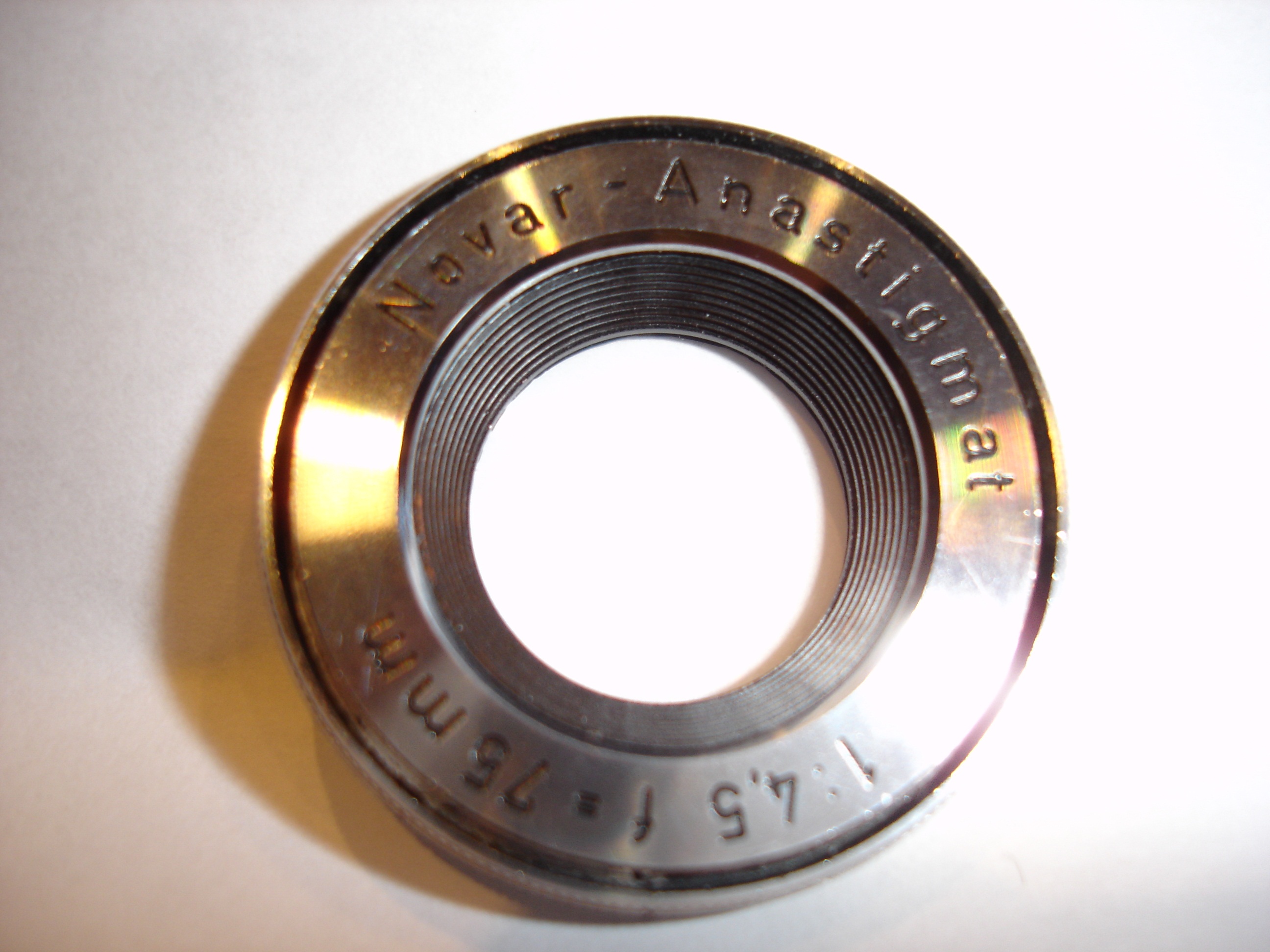

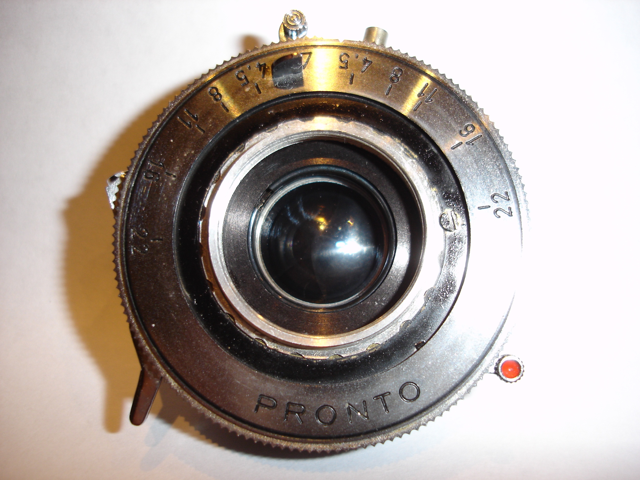

Removed this from front standard and dis-assembled as far as I could dare.
With some fiddling and twiddling, I finally got access to all lens surfaces and successfully cleaned elements of minor fungal growths; I took a gamble and lubricated the shutter mechanism with white spirit - dribbled sparingly into all available apertures that presented themselves (it seems to have worked a treat, the timer now works great and the shutter is a lot slicker than it was -time will tell ).
As I cannot see the focus through the viewfinder; My question is:
Has anyone experience of this re-assembly, and what is the procedure for connecting these two elements back together in order to ensure the focus of the lens is aligned with the scale ?
I don't want to risk several rolls of film trying to guess.
sorry about the quality of the uploads...

Referring to your first picture the screw opposite the f22 mark on the right is the retainer ring lock screw. Mark that slot, remove the screw then unscrew the center retaining ring counting the number of turns it takes to remove the ring.
The shutter face plate and speed ring will now lift off the shutter. Set the shutter to T or B before lifting the speed ring off and note its position relative to the shutter case pc socket or cocking lever. Do not attempt to cock the shutter with the speed ring/face plate off. Take a good picture to identify the parts positions. Set the aperture to f22. Place the shutter open side down in the ultrasonic cleaner, fill with the alcohol. Run 3 to 5 cleaning cycles allowing it to rest 5 minutes between cycles. Cleaning cycles in close succession will cause the alcohol to get hot. Hot alcohol will cause paint to peel off where finger oils have penetrated it.
Take the shutter out of the cleaner and allow to air dry. A drop of clock oil or similar about the size of a straight pin point can be applied to pivots if desired. Reassemble using the retainer ring number of turns recorded during disassembly and reinstall the lock screw. This is 100% better than flushing with lighter fluid or solvent and about 75% of a complete tear down, clean, reassembly.
Dirt and dissolved lubricant will settle to the bottom of the ultrasonic cleaner as a dark gray to black fine sludge and may discolor the alcohol.
