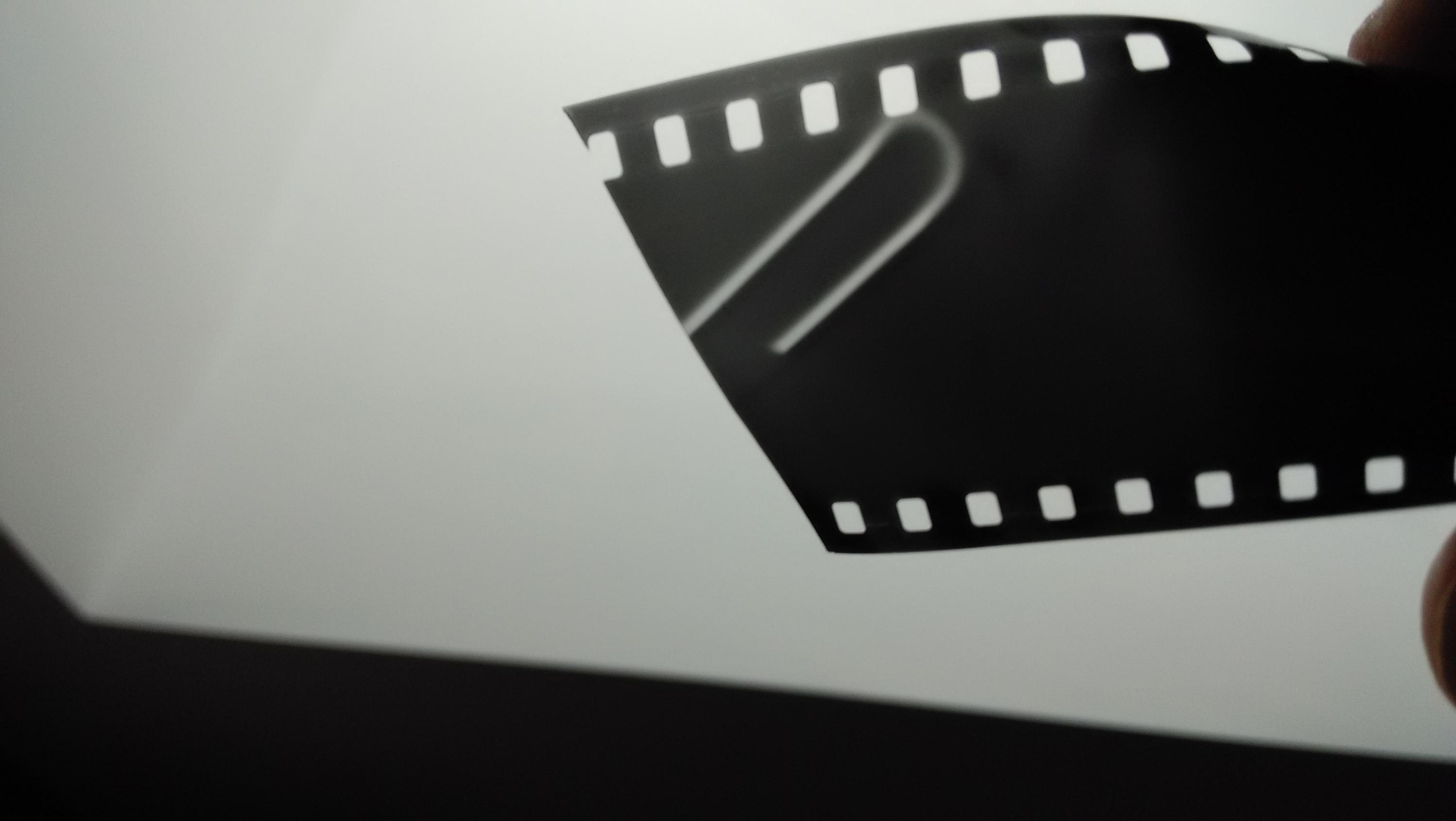

I went off and bought a roll of 35mm IR film to try out. Cut a snippet from the end and put it inside the camera. Left the camera outside for about 20mins.... and the result is,,,,, not IR safe.
The reason I was a bit worried about this was that I also do some LF work, and I know that the bellows on my chamonix is not IR safe - but is very definitely light tight.
So beware!!
