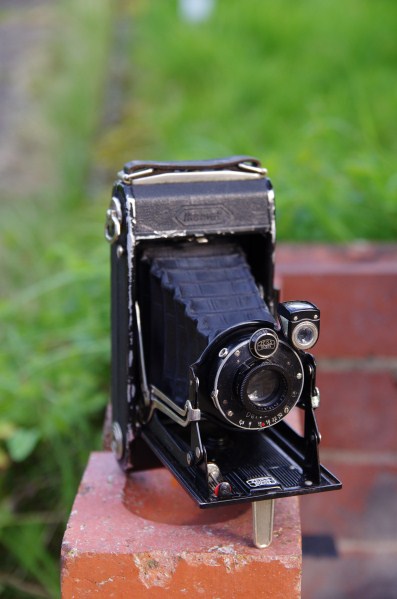

I've just bought what seems to be a working Zeiss Ikon Ikomat 520/2, it's loaded with Ilford FP4 and ready to go but I'm wondering if anyone can say how old it is?
I tried Camerapedia and while they have a Zeiss Ikon Ikonta 520/2 listed (with the same lens and shutter as mine) there's no mention of the Ikomat. I understand that Zeiss used the Ikomat brand for cheaper cameras but it seems odd that mine has the same fittings as the Ikonta 520/2. My camera looks identical to their photo apart from "Ikomat" where theirs says "Ikonta" and an all-black flip-up viewfinder rather than the black with chrome surround on theirs. Any thoughts?
I'd been after a nice old folder for a while, main requirement being that it use 120 film for obvious reasons. This popped up for £20 from a reputable seller, even included the original cable release! It's definitely a user rather than a display example as there are plenty of paint rubs on the metal bits of the casing, but the bellows seem light-tight, the shutter works, the lens is in good condition and everything turns as it should.

The lens is an 105mm f6.3 Novar-Anastigmat with Derval shutter, camera shoots 6x9 on 120 film. Camerapedia has 1938 for the same package with the Ikonta badging.
I just hope I can get results as good as those from mine! Obviously you have to guess the distance to subject and either carry a light meter or use Sunny 16, I'll be doing the latter as I can generally get close enough for negatives.

Ikomat and Ikonta are the same camera, Ikomat being the earlier name. Neither the Novar lens nor the Derval shutter have serial numbers which makes dating the camera harder. There should be a serial number consisting of a letter and four (five?) digits - the letter gives the year of manufacture. I don't have a list for year letters but you might find them on the Interweb. It is definitely between 1931 and 1938 (the years they made the Ikomat/Ikontas.

Earlier Novars did carry a serial number. I've yet to see a postwar Novar with a serial number.
In any case, you can sometimes tell if you have a very early camera by the shape of the camera. The earliest Ikomat/Ikonta cameras had sharp chiseled edges, while the later models had more rounded edges.
The Novar was the budget lens, while the Tessar was the premium lens.
Even so, stopped down, the Novar is a very capable lens.
For the most part, Zeiss Ikon didn't make cheaper cameras. The lens was always the factor in determining price. That changed in the 1960s and 1970s.

If the camera was exported to the UK or the USA then the distance scale will be in feet. It will also have the smaller tripod boss via a screw-in adaptor.
With that lens serial number (I have never seen one on a Novar lens before) the lens was made in mid 1930. That indicates a date for the camera of 1931 - as they didn't start making the Ikomat/Ikonta until then. Lenses were made in batches and it was usual for the lens, shutter and body to be made in different years.

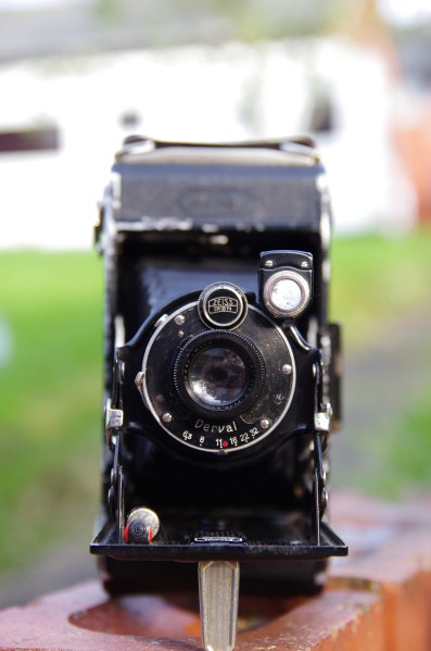

The shutter speed control is a dial above the lens - speeds are 100, 50, 25, T and B. Hence why you don't really want to put anything faster than FP4 in as you'll struggle to get the right exposure when the sun is out!
It also has the smaller tripod fittings, there's even a tiny grub screw to stop the adapters from working loose (talk about attention to detail). I'll try to get a few photos later as it seems to be something a bit unusual.

A couple of quick shots of the camera. I still need to take the top off the brilliant finder and have another go at cleaning the mirror (it looks like rust but may just be very stubborn gunge).

It will be rust in the brilliant finder. They seemed to chrome plate straight onto steel. I have certainly never managed to get one into a useable state.
