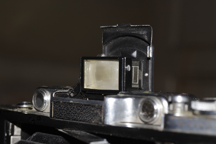

Not sure if I should start another thread but I have a question about the viewfinder. How the hell do you know where you're shooting?! All it is I are two pieces of glass that shows a much wider angle than what's actually included in the neg. The main thing, however is not so much the angle of view, but the actual aiming. How can I know what will be in the frame and also where it will be? Is it really a matter of trail and error? Is is safe to assume the the rangefinder is pointing right to the centre of the frame? I guess that would help.

Hello,
This model is fitted with the Albada type finder.
You see on the rear of your camera what it is on the pic.
When you see in the viewfinder, the field covered is indicated by a white transparent boundary line ; it's this field which is included on the negative. The outside greater rectangle is for 6x9 cm pic ; the inside smaller is for 4,5x6 cm.
IMHO, it's not the best viewfinder...

Forgot about the albada. Mine just has the cheap little squares.

Then just align the inner border of the two frames and you have a rough estimate. Nothing more. Those things were designed to be compact and non-obtrusive in a pocket or the leather pouch you used for carrying the camera around. You'll get used to it and with a little excercise you'll get better at judging how much of what you see in the finder will be in the shot.

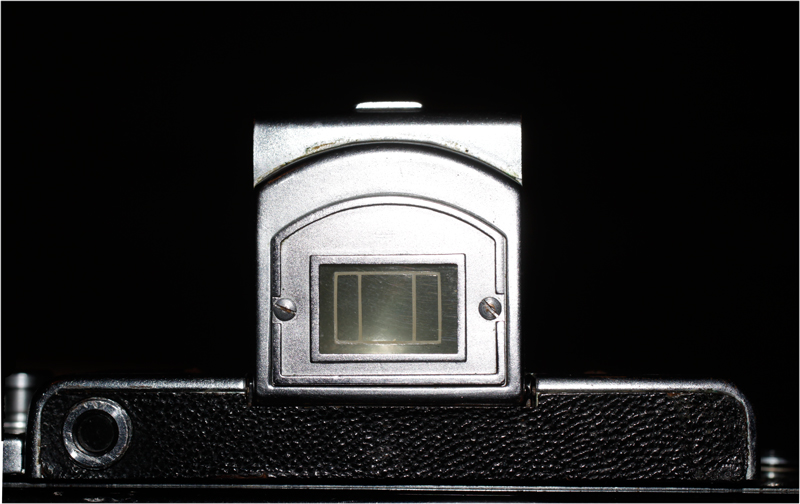

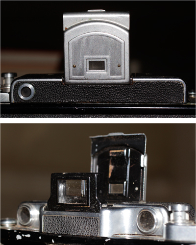

Here are pics (second & third, rear & front) of the finder of the Super Ikonta 531/2 with Novar. It has a simple window because the camera has only one format, 6 x 9 cm.
The first pic is from the front of an Albada finder of a 531/2. Yours should be like this.
