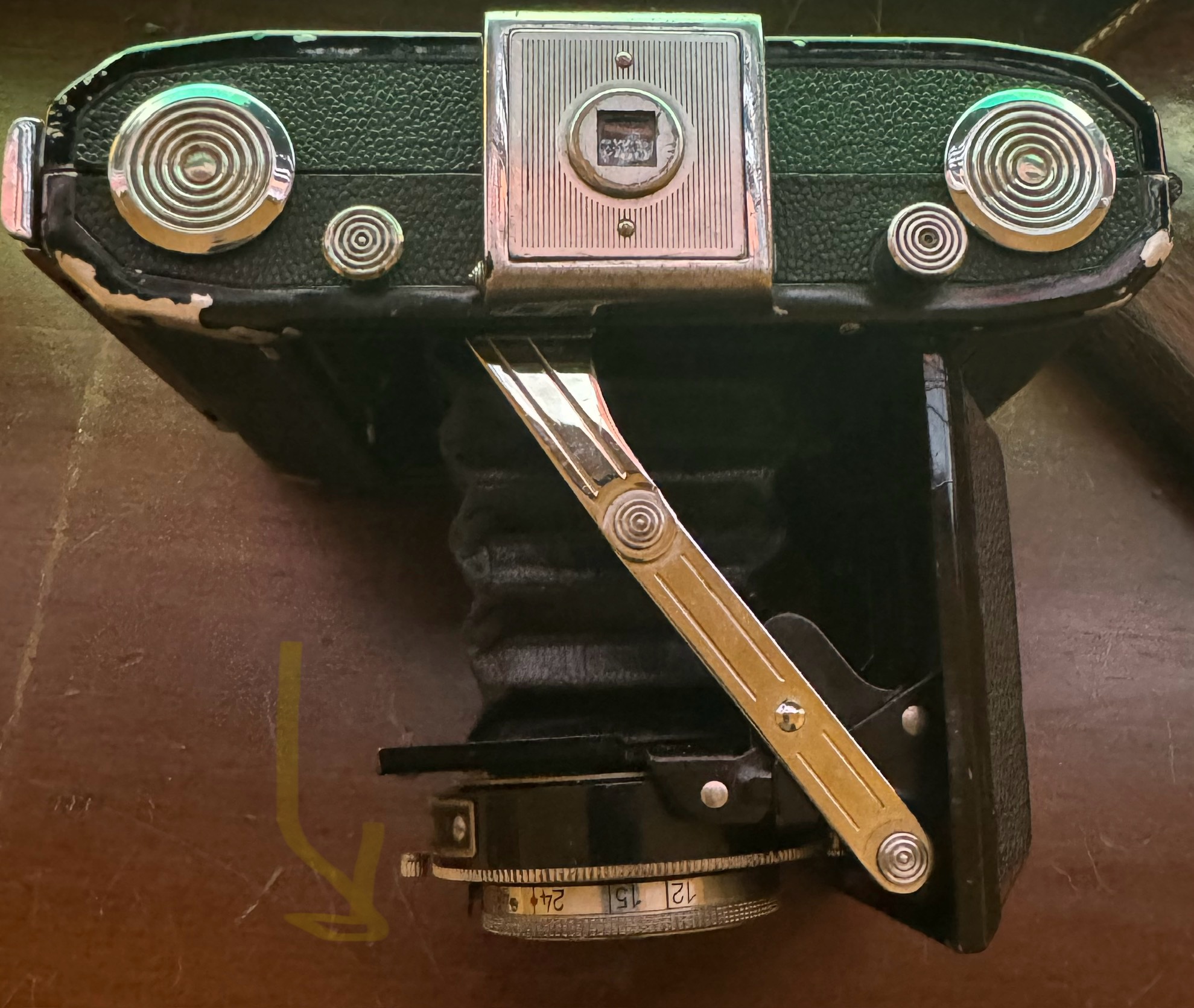

Sorry for the delay. Here’s a photo. I lined my iPhones framing lines parallel with the case of the camera so if you use that as a reference you should be able to see the front standard seems over rotated or bent

Easy enough to put bent metal struts into original shape? Good luck.
No luck is required. When you have marks on the film plane that you can continuously check with an SLR it is not hard. It's probably not the struts themselves that are bent but the foot and the lens retaining part of the front standard. As you can see in the picture, they are stamped sheet metal and bend much more easily than the (pretty rigid) struts.
