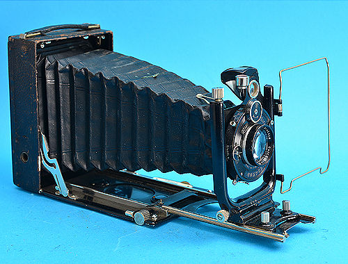

I've just bough this one: Zeiss Ikon ICA trona 210 9x12 + Tessar 1:4,5 F = 13,5cm Carl Zeiss Jena
attachment.php
I didn't find an user manual on the net..... Anyone can help please?

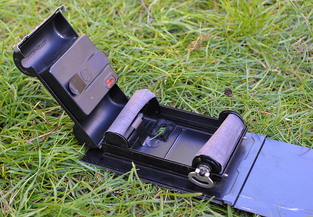

i use old roll film holders for theses cameras, its easier. Disadavntage, with these 9x12 Cameras you get a crop 6x9 picture on film.
I can recommend the Rollex Patent, be careful, they are availible for 6x9 or 9x12 Cameras, both certainly with 6x9 picture size because of the film size.

Finding the correct rollback can be difficult, they are generally a bit expensive too. Rada made rollbacks in a range of styles to match various cameras, the easiest way to make sure you are getting what you need is to buy the rollback complete with camera.
