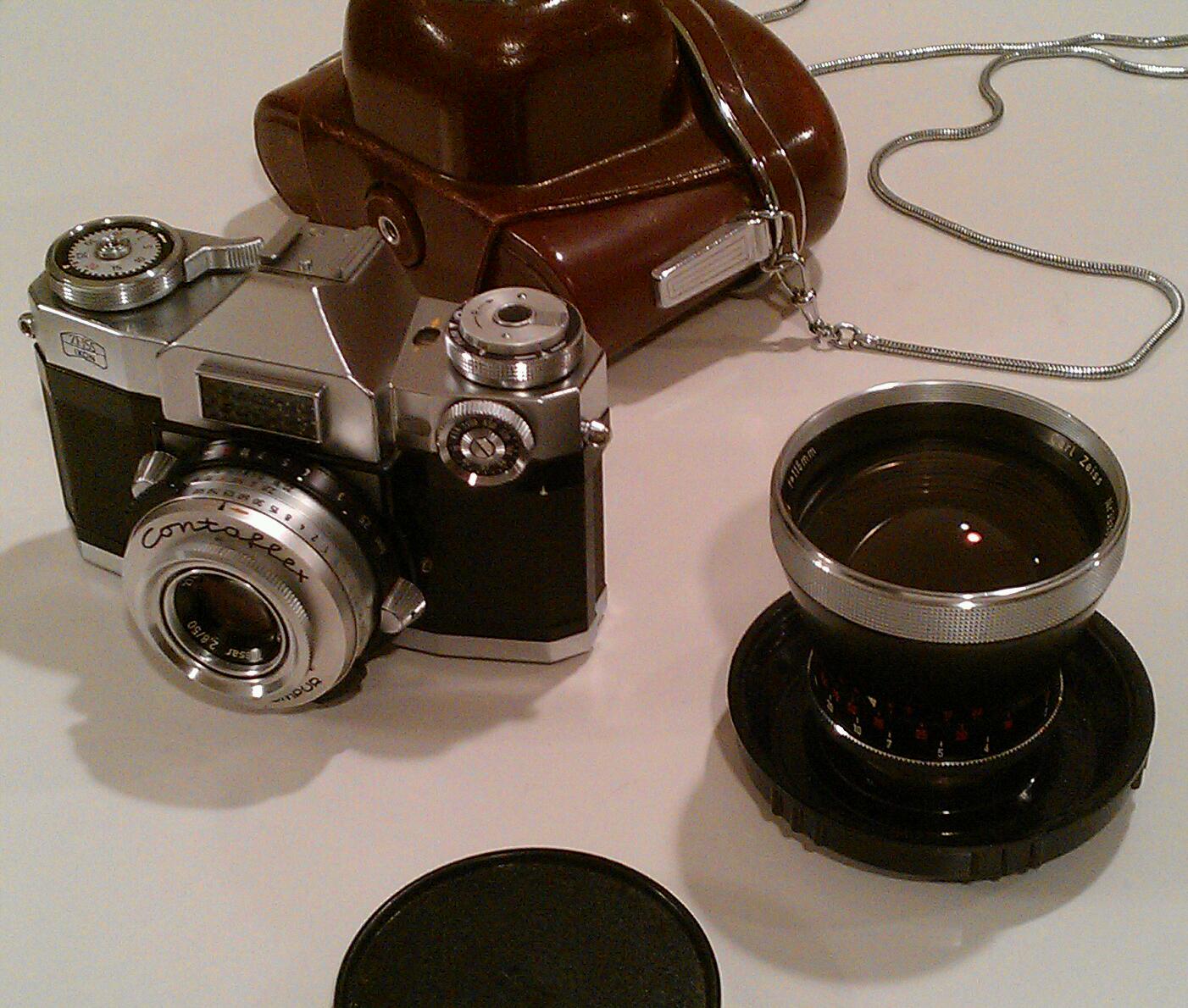

I wonder if any of you guys can help me with this. I have a Contaflex and believe it is a Contaflex Super. Last time I used it the light meter seemed to be working, but now its either stopped working, or I have forgotten how to make it work. Also I can't see any battery compartment. Are there any Contaflex experts out there?
No batteries for the meter, Contraflexes have selenium meters. Over time, especially if left exposed to sunlight, selenium meters just plain wear out. If memory serves me, the Super is a match needle type meter. Make sure the ASA setting is set high enough for the light conditions, otherwise the needle just sits.

If you're referring to this type of crittter:
then it needs no battery. The meter is selenium. My meter works, but I keep it covered up when the camera is not in use.
If you're referring to this type of crittter: then it needs no battery. The meter is selenium. My meter works, but I keep it covered up when the camera is not in use.
Mine, a Contaflex Super B, is similar with a Synchro-Compur shutter but different to the one shown in your image.
On mine, the focus grips on the side of the lens are black plastic, and there's no control wheel on the front below the rewind knob. Above the pentaprism housing, there's a flash sign followed by "_matic_". On mine, the rewind control seems to be a control for the ASA speed & any compensation set on the meter. My case has leather straps, rather than the snake chain shown in your image. I can't find any Zeiss model type marks anywhere. I don't yet have any accessory lens for it, although I do have the mounting frame and "Teleskop" for my earlier Contaflex standard with fixed 45mm F/2.8 Tessar.

A Contaflex Super (original or New) meter works a bit differently to a Super B. You have checked the function of your Super B light meter with the aperture ring set to the "A" position, haven't you? This is the only setting at which the meter movement is engaged. If a manual aperture or flash coupling aperture is selected, the light meter is switched off and won't work, because Zeiss did not intend for it to operate in conjunction with those settings.
Very many thanks for your message. I've set my camera to "A" and the meter does in fact work! Brilliant! The low price I paid on eBay for a near mint example reflected the seller believing that the meter had died. Once again, very many thanks for the information.
Well done! It can happen this way. Just quietly, if you're looking out for a Super B-->S Contaflex and a seller says meter is DOA it is worth checking listing images carefully for position of the ring. If it is not on "A" and you are feeling a bit lucky you might snare a working example a little cheaper this way. But I suppose you already know this, now. :smile:
