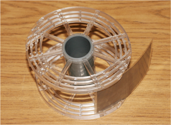

A 6,5X9 sheet doesn't fit a Paterson reel; I use a special holder.
This reel is slightly oval; unfortunately, I can't put it in my Paterson tank...
