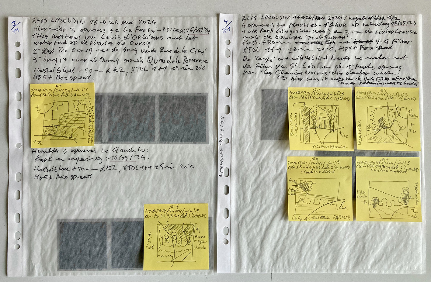

I use a small pocketable notebook where I record all things I don't want to forget about the photo's I shot, add a number and copy that number on the roll film's closing tape.
Then I rank the rolls, according to the numbering, on the darkroom's countertop, when putting them in the tank so they come out in the same order.
So, once developed I take the out and hang them to dry, and classify in the same consecutive order as numbered.
The number, and comments, are copied on the Pergamyne sheets where in the negatives are kept.
I know it sounds complicated, but once you get used to it, it works almost automatically..

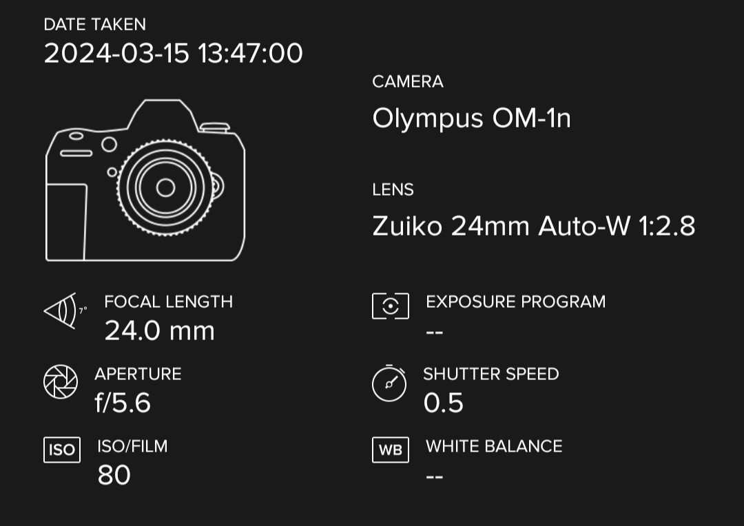

Over the years I've tried physical notebooks, google docs/excel and phone apps.
Currently I'm using Exif Notes in the field to record not only what camera and film was used when, but complete picture with lenses, shutter speeds, aperture, filters, location and complimentary phone pic as a reminder if I wish to add one.
Downside is that phone screen is involved in workflow, cluttering it a bit, but upside - every bit of data is there to return to and to use it to your liking.
And this data is imported then in scans, end result on say Flickr (and any other site reading EXIF tags) being like in the attached picture.
There are many apps that do this one way or another.

On the exposed roll I mark in short the subject, the date, the consecutive number if I used more than one roll that day, and, if needed, a hint for the developing if the ambient light is delicate (shadows<—>highlights) or, eventually, if the exposure deviates from the box speed.
But on the pergamyne negative sheets, there I mark as much as and whatever I think is important, technically as wel as subject related.
And I stick Post-It notes with printing instructions for when I need to re-print that negative.
The sheets are classified per datum in boxes containing about 80 to 100 sheets which on their turn are arranged per year.
I keep 2 paralel spread sheets describing the contents of these boxes, one per datum and one per thema, and are systematically updated.
I make the boxes myself.
The same goes for the prints.
I don't make contact sheets as I find it somewhat a waste of material and time, and I am used to 'reed' the negative on the light table...
