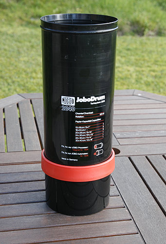

I recently bought a Jobo CPE2 complete with a 1520 film tank and a 2840 drum, followed by a 2509 reel for doing E6 4x5. I then sat and waited for a suitable 2500 series film tank to come along at something like a reasonable price.:blink:

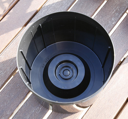

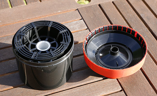

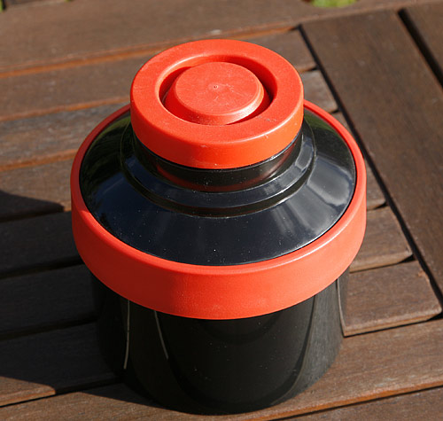

I then saw a reference elsewhere to removing the bottom part of the 2840 as the 2509 would fit into it, and I've just tried this out. The attached photos show the 2840, then the bottom part detached with a bump in the base, the third one shows the 2509 reel in it and the modified lid, while the fourth one shows the lid in place on the 2840 base.
The lid mod was to take the insert from the 1520 film tank and fit it into the 2840 lid, and I'm assuming that the small chemistry entry pipe will fit into the top of the 2509 centre spindle to make it light-tight, but I haven't tried it yet. The other thing is that I'm not sure if the base bump will prevent chemicals entering/draining or significantly slow the process down.
Given the prices that 2500 series tanks go for, I can't quite believe that the relatively cheap 2840 drum can be used as a substitute, so I'm looking for your thoughts and maybe experiences of this?
Many thanks, Peter

Yes you can build over the Jobo tanks.
One advise: Try to use a 2502 reel and tank for your rotary development.
An elevator makes the whole thing more accurate and much easier in handling. But then you need the cog on your developing tanks.
Especially for short C41 times (3:15 minutes) it's very easy to have.
paul_c5x4
Apr 22, 2009
1,942
Ye Olde England
The mold numbers are the same for both the 2840 base and the 2521 tank, so apart from the printing, they are identical. As for the lid insert and centre column, they are also interchangeable between the 25xx, 28xx, and 15xx lids.
I'm fortunate to have all three tanks, so can do quick comparisons like this.

Thanks guys. Looks like time to shoot a couple of sheets of B&W at the weekend and run them through this to check for light leaks and suchlike before I go for E6. :smile:

The 2509 without a core is not light tight in the tank.
The centre core is the same as the 15xx series. I can't check now if the lenght of he one you own is the one you need (because I'm ill and stuck in bed) but check it and you'll be fine.

A quick update just to confirm it worked out fine and the film is hanging up to dry now. Many thanks for all your help! :smile:
