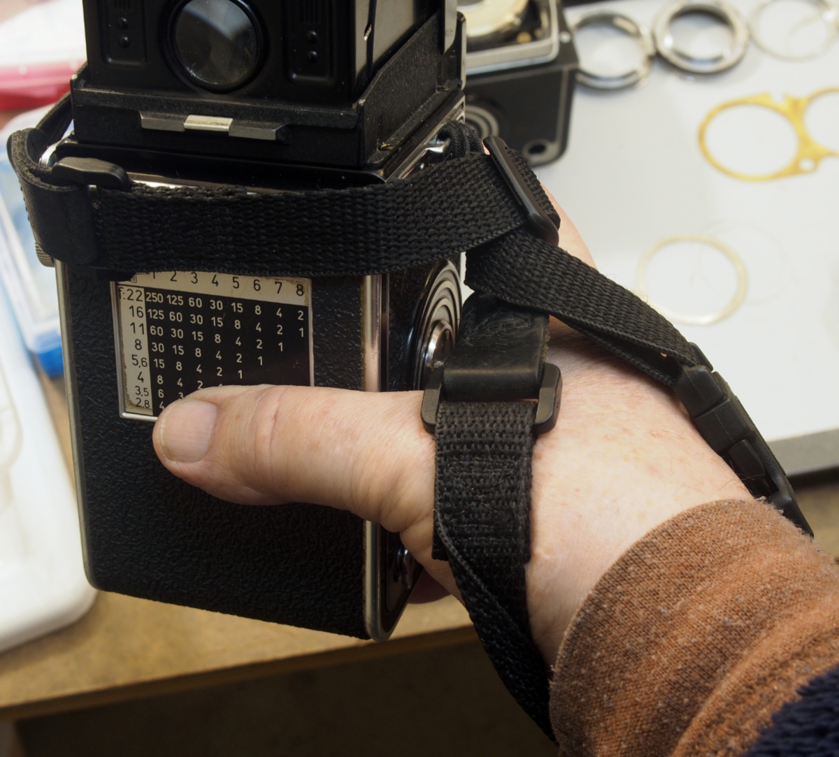

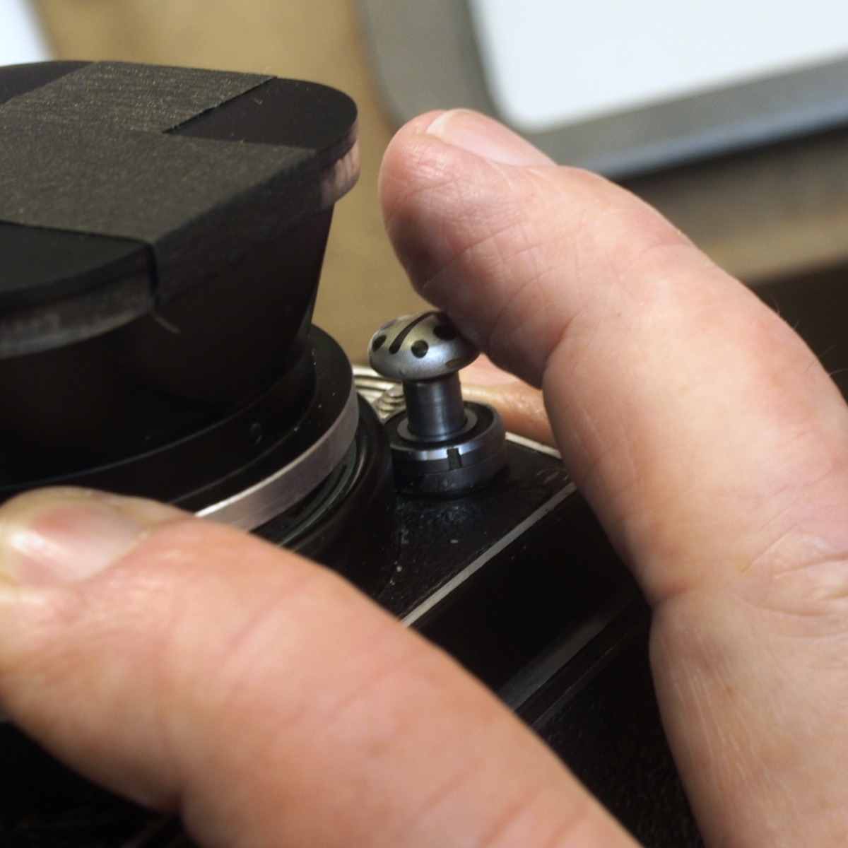

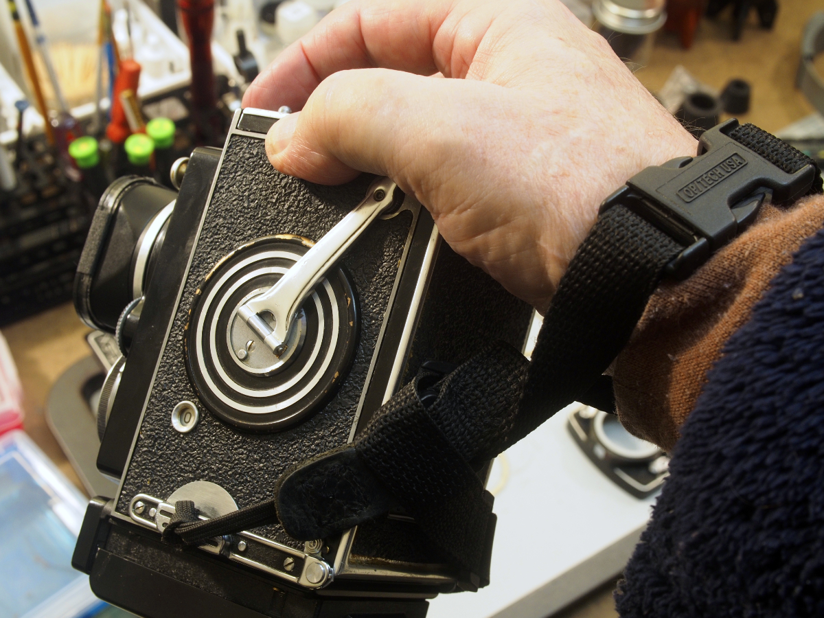

Well, just my approach to carrying and firing a TLR. I use the Op/Tech Pro Loop strap. But I only use the two connector ends, clipped together into a wrist strap. Wrap this around my right wrist. A little tension between the camera strap lugs and my wrist stabilizes some. It is held in my right palm, thumb at back. so the hand itself adds some stability. And the left hand adds a 'third point' -ha, a tripod! :smile: - of stability. Combined with what guangong discusses- relaxation- I do fine.
Interestingly, light pressure between right hand fingers and the wrist strap while the camera is hanging down means I can carry the camera for hours with minimal exhaustion. I developed this way of carrying when shooting in cities as a way to protect the camera and be able to move quicker than with a cameera swinging off my neck, but I use it all the time for most any camera.
Except a Mamiya TLR! Haven't tried it but I bet this would reach the limits. You'll need to try it. Rolleis, Autocords, etc. sized cameras it works well for me.
And second element- a soft release button. I like the convex soft mushroom style, allows for a lot of comfortable relaxed finger pressure positions, not demanding a specific angle of pressure. That's a match technical one in the photo- very well made but a too silly naming system so I am not certain what it is called.
