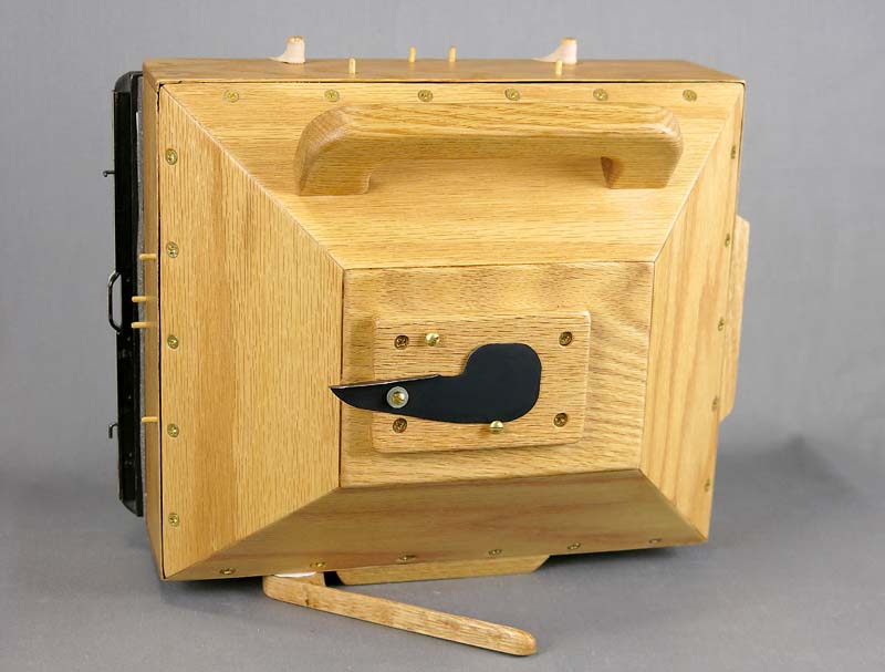

Well my "goto" pinhole camera might change depending on where I plan to go to! But the last few years I have worked with my self-designed and built 8x10. (I have to confess I may be slightly more excited about building the cameras than using them! :angel: )
The aforementioned camera, and a shot taken on Fuji HR-T x-ray film for WPPD in 2015:
I have a 4x5 version of similar design except for the tapered "nose cone" and also a pinhole body cap with fancy home brew shutter to fit my Bronica SQ-A if I feel compelled to go with less bulk.

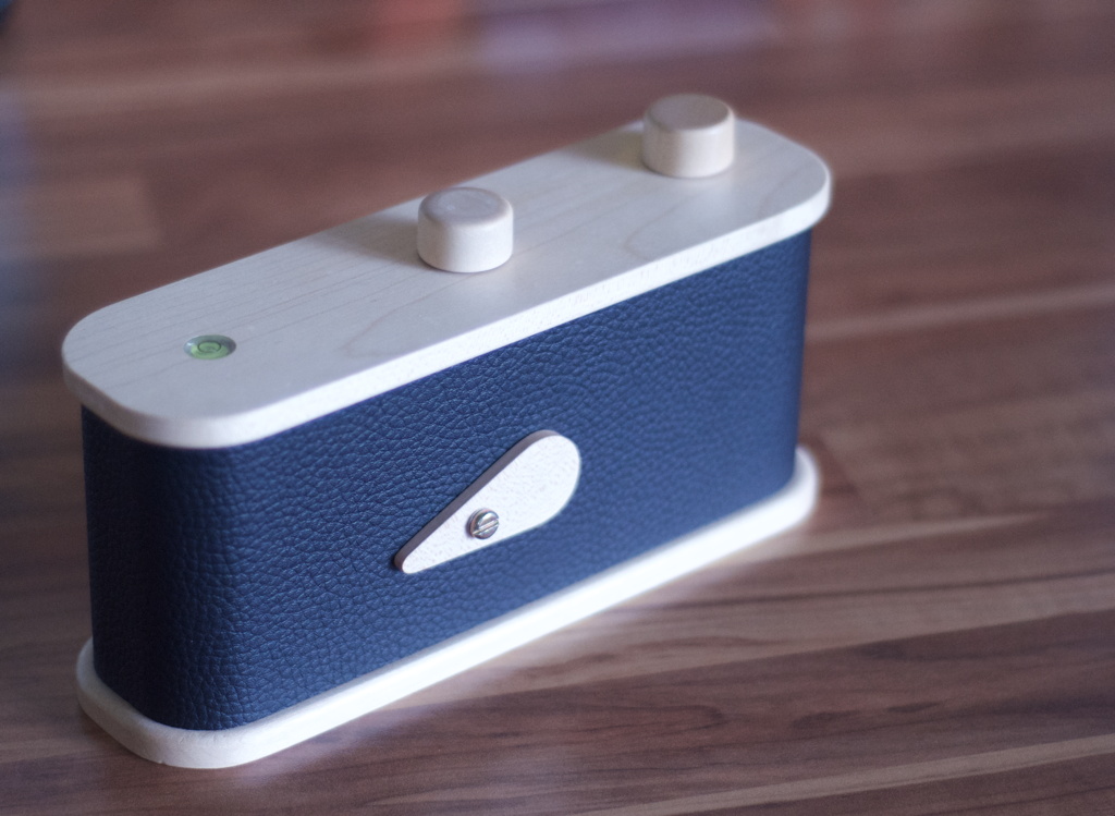

Great stuff - keep them coming!
Here is mine (see thumbnail photo below) - a commercial effort, the LeRouge 612. It has its small quirks, but I enjoy the chocolate box quality of the wide angle panorama - as shown:
[url=https://flic.kr/p/24BDrkv] Tree and stone by Jerevan, on Flickr[/URL]
