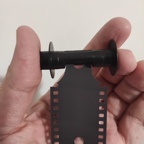

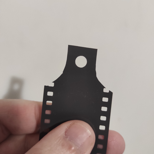

Ouch! I guess I'll keep taping my films. Or I could repurpose a paper punch? $80 is a bit too steep.
Well, I just tried the paper punch and it works nicely.
I could cut the edges less generously and more square shaped, but it grabbed the hook easily.
Thos little bits of of zagged sprockets that have been cut can and will break/tear off inside the camera, screw up feeding on a developing reel and cause unknown problems in general.
Take small shears and cutting through the middle of the next whole film sprocket so the intact sprocket hole is not cut or opened somehow, while cutting the jagged pieces into a smoother transition to your cut in curve.
You'll get better results after that.
The hardest part is getting the hole centered, which isn't particularly hard anyway. Then you cut the edges at the end of the sprocket hole just below the hole you punched at a right angle, not like I did at the first image. Pass the film through the slit and that's all.
