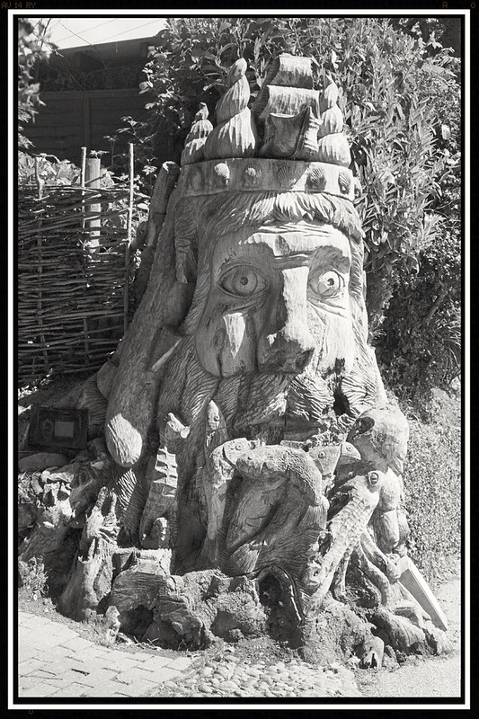

Yes, I'm talking 35mm. I shoot 120 also but have no issues with this. I love FP4 and most of the time here in the UK it works wonderfully for me. Perhaps I'll try some ACROS next year.

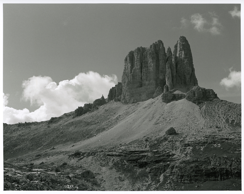

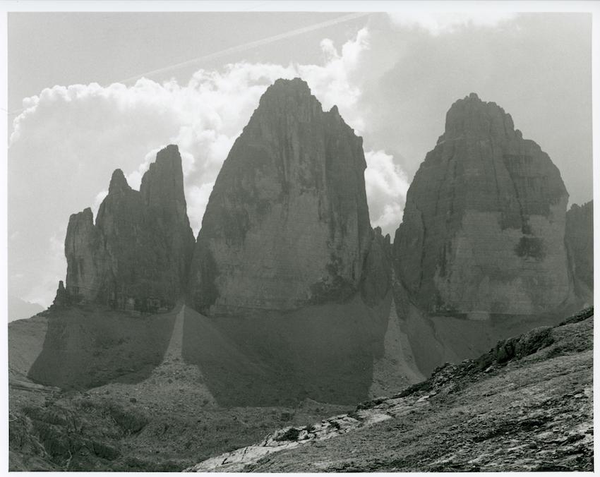

I just shot a lot of FP4 in 35mm and 120. I used Xtol 1:1. The light was early September (so not quite as harsh as mid-Summer) but it was in The Alps, at altitude. Pretty harsh and light is reflected back from the limestone/marble. The grain seems very fine to me (I am enlarging the 6x7 negatives at the moment) and almost all of the negatives so far print at grade 2 without difficulty (although some tweaks are probably needed). Xtol is not my usual dev (I usually use DD-X) but I am very pleased with it indeed so far. PS: I use a yellow filter pretty much all the time unless it's very overcast.
Attached a (partially successful) example of FP4, 6x7, Xtol 1:1 with a strongly backlit subject at near noon in Early September. Also another in the harsh mountain light.
