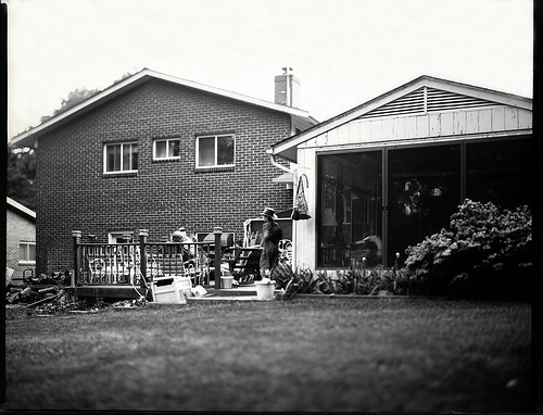

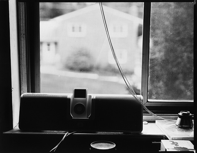

I'll start with Ilford MG IV RC
Please post example images!
These were developed in T developer
I wanted to see how it's turn out if I shot some red flowers... Well it didn't, of course...
Note the Jason Brunner Bellows compensatory device
*Edit*
BTW these are 8x10 paper negs

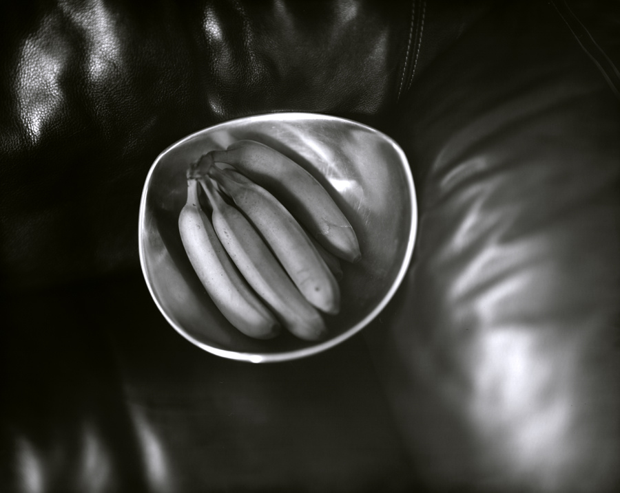

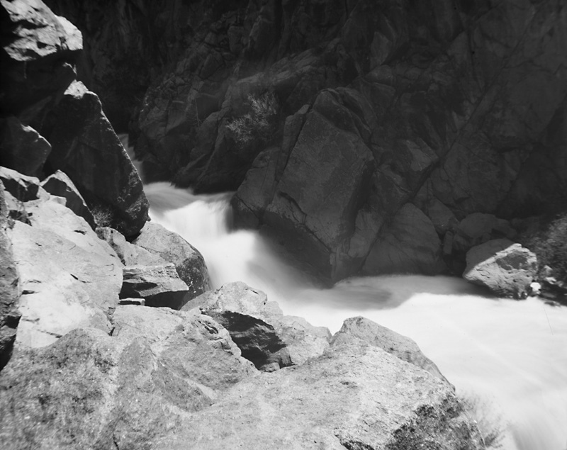

My preferred paper media is Arista brand grade 2 RC paper, preflashed. Here are some examples, exposed in a DIY 8"x10" tailboard box camera with meniscus lens.
~Joe

I usually rate at ASA 3 to ASA 4.5 - 5. It depends greatly on the lighting and metering technique, the exposure latitude for paper negatives it really narrow.
Those three examples were rated at ASA 3

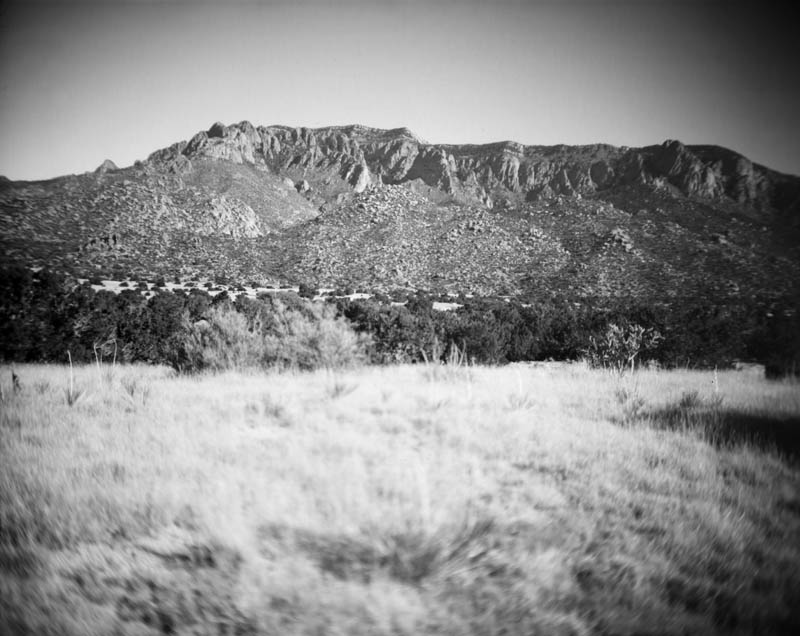

( from left to right )
ilford fb ( 8x10 )
expired kodak poly fiber ( 8x10 )
expired kodak rc paper ( hand rolled spool 122 size )
kodak polymax fb ( 8x10 )
afga expired, grade 1 ( or 0 ? ) ( 7x11 )
they were all rated around asa 3, but the portrait was 3x slower than that.
all processed in ansco 130 ( except the rc was developed in coffee )
