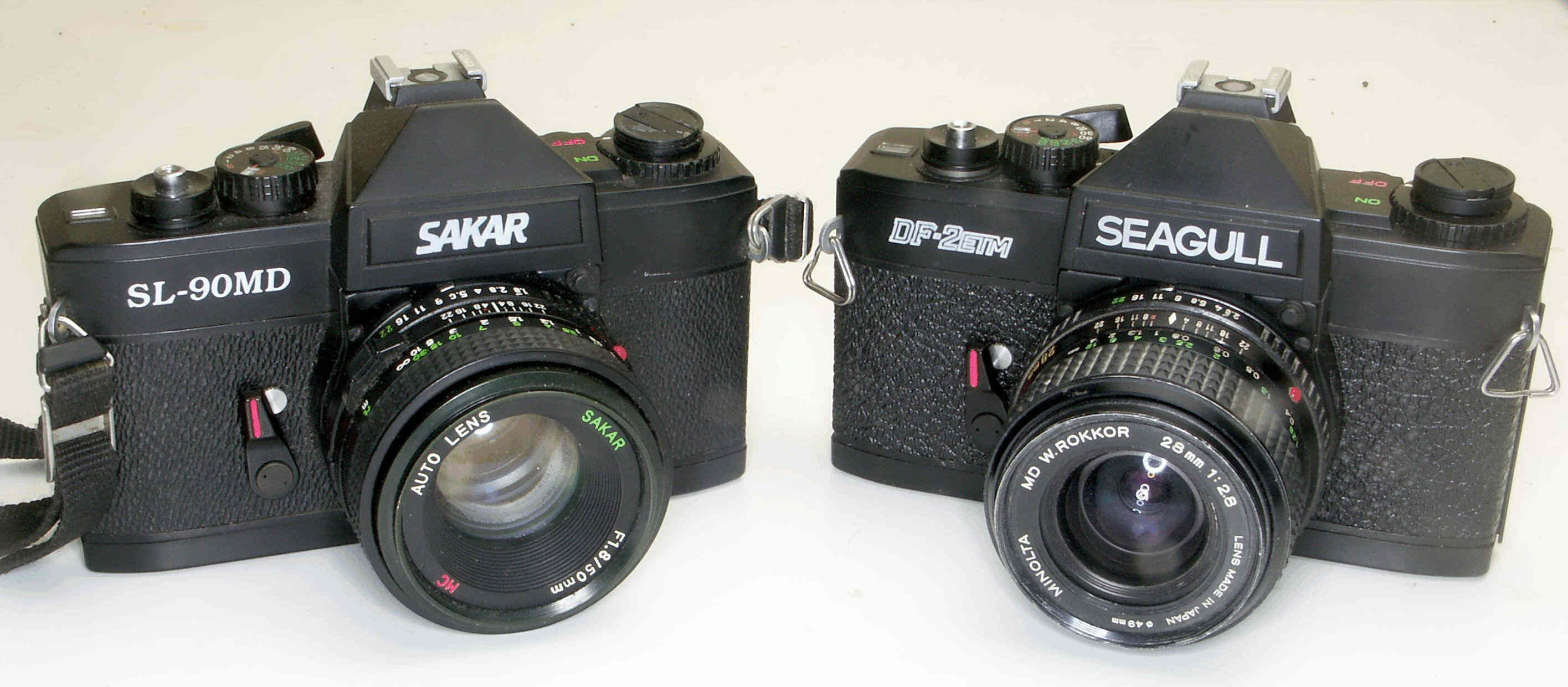

I have two identical cameras – first photo.

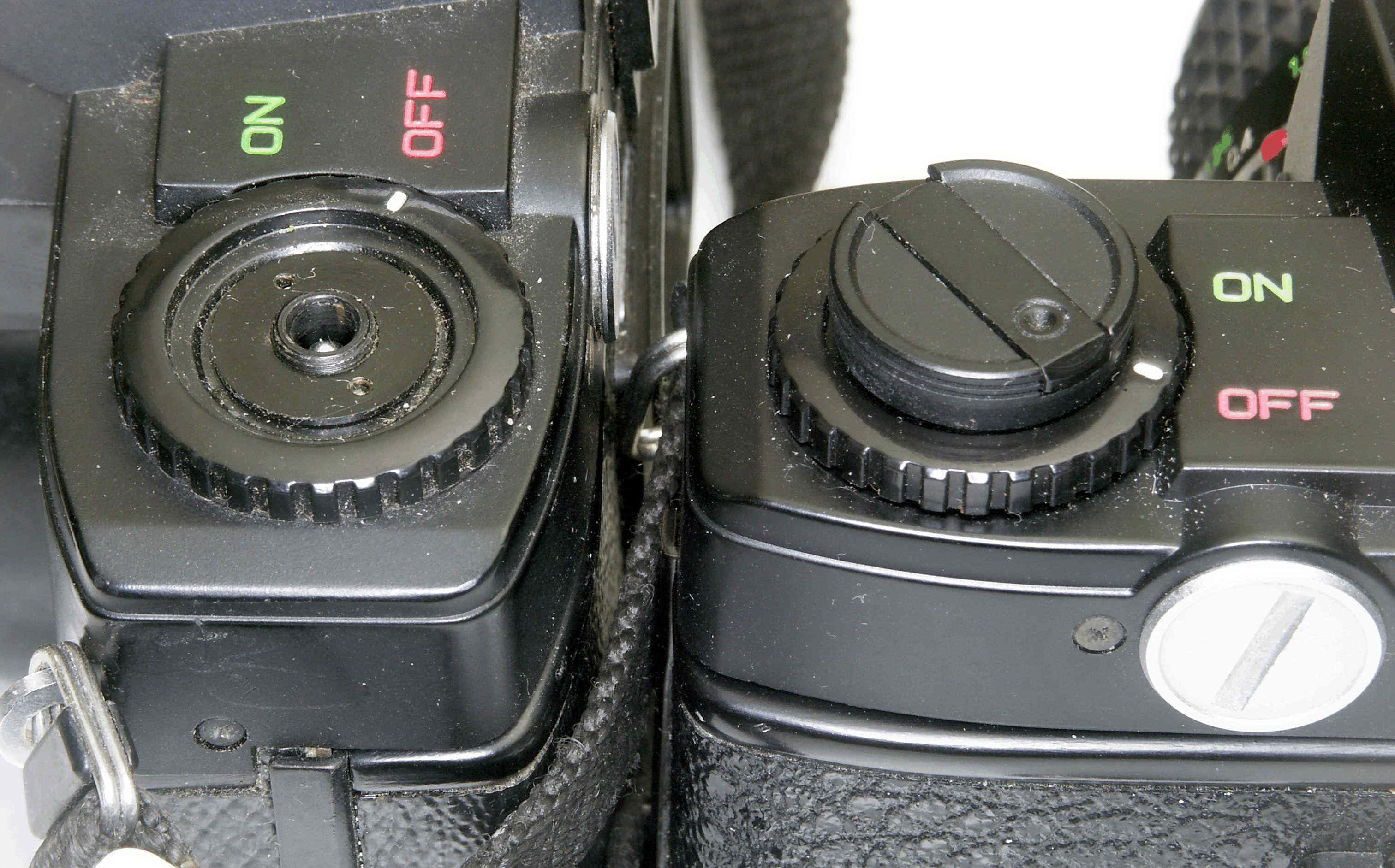

OK, they are not exactly the same. They have different names, but that’s it. Why do I have two of the same camera? Because I got one for free because it has a “broken” rewind knob – second photo – and is useless.
Fortunately, the “seller” kept the rewind knob – which, like many rewind knobs, screws into the rewind spindle –

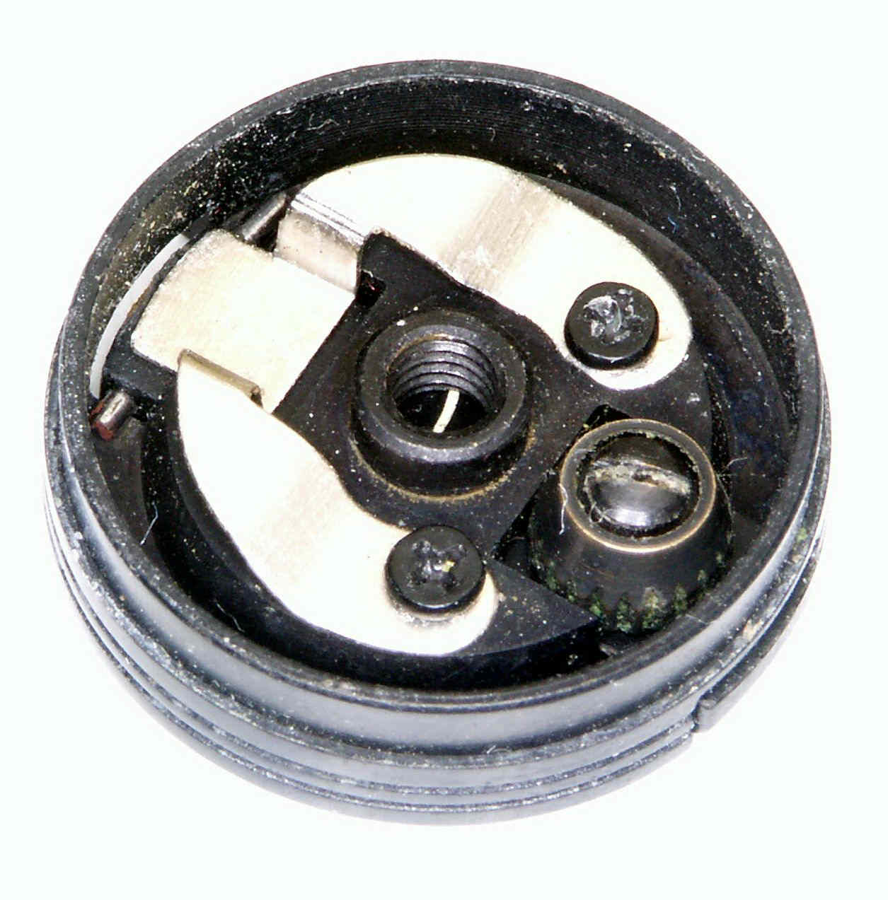

Here is the rewind knob and spindle from the other camera WITHOUT the problem.
The problem is that the usual ways of opening up the back -- so I can screw it back together -- don’t seem to help in this case. Why? Because this camera has an ON/OFF switch under the rewind knob – see second photo again.
